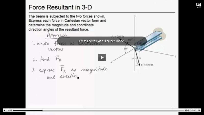

In statics, to express force in the z-direction, the same principles apply as with the x and y components, utilizing the relationships of a right triangle. For a triangle with legs of 24 and 7 units and a hypotenuse of 25, the components can be calculated directly as ratios of the triangle's sides, such as using Fy = F(7/25) instead of sine. The choice of legs for the z-axis depends on the orientation of the vector in the Cartesian coordinate system. In the case of F1, which lies in the y-z plane, the components are derived from the triangle's dimensions, leading to F1 = 630((7/25)j - (24/25)k). Understanding these relationships is crucial for resolving forces accurately in three-dimensional statics problems.

Im having trouble understanding parts about the z-axis for my statics class. You know how Fx=FcosΘ and Fy=FsinΘ. How do you express force in the z direction? And also if I have a right triangle with a leg of 24 units and a leg of 7 units and a hypotenuse of 25. I see they can skip using cosΘ and sinΘ in the force equations and can just use for example Fy=F(7/25) instead of using sin. Which legs would you choose for z-axis?
I attached an image and I am not sure i it showed up. And you can see I am trying resolve the F1 force in Cartesian vector form They have F1=630((7/25)j-(24/25)k). So I am wondering how they choose those legs for the z-axis force?
shownn above

F1 is in the y-z plane. The 7-24-25 triangle attached to the vector arrow shows how the components fall out.
For F2, the angles which the vector make with each of the coordinate axes are shown.
