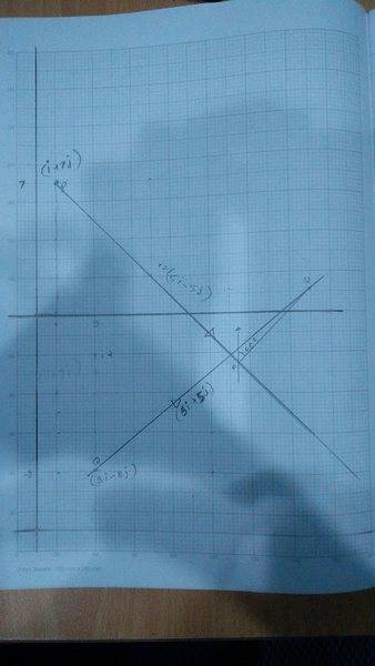

At noon two boats P and Q have a position vector (i+7j)km and (3i+8j)km respectively to the origin O.
i and j are unit vectors in direction to East and north respectively
P is moving south east at 5√2 km/h and Q is moving at a constant velocity of (6i+5j) km/h
At time t after noon the position vectors of P and Q with respect to O are p km and Q km
a) show that the velocity of P is ( 5i + 5j)
b) find the time to the nearest minute when Q is north east of P
Phythogorus theorum a^2 = b^2 + c^2
I have done part a)
Where if the velocity is (5i+5j), then if you use phythogorus theorum where √(5^2+5^2) I get 5√2
I don't know how to do part b)

Yes I have drawn a diagram
Uh ... and do you plan to share it with US? You ARE asking us to discuss it after all.
But my main problem is figuring out the wording of the question
Is the question asking me to find the time when Q is at a bearing of 45 degrees of P?

I have drawn the diagram
And I can solve the problem when I'm sure about the north east part
I just need to know the exact meaning of that
Just clearing my doubts

Well you can see how I have drawn the vector diagram I drew it true to the i j to x y vector coordinates. I just don't know how to go about the question. Some hints would be helpful
You have had some hints. In post #20 I asked you about Q - P. Have you even calculated that yet? Are you going to show us what you get? Have you thought about whether it points Northeast? Or how you would tell? Neither I nor anyone else on this board is going to work it for you.
You don't need any diagrams. The key is to subtract the vector velocity and position of P from Q. This makes P the new origin and gives you a new location and new vector velocity for Q. You can now use those velocity components to figure out when the two position components will be equal which is when the position of Q is north-east of P.

So the position of
P = (i+7j) with v= (5i-5j)
Q=(3i-8j) with v=(6i+5j)
Already Q is on the east side of P and the rate at with Q moves in x-axis is faster than P
So therefore Q will always be on the east side of P
When we look at the y-axis it seems that P is moving down at the same rate as Q is moving up
So the moment these two meet in y plan would be the time that Q is exactly on the east of P
So using speed = distance /time
Distance= 7-(-8)= 15
To find mid position 15/2 =7.5
Speed = 5
Time=distance/speed
=7.5/5=1.5hrs
At this time the two ships will be is line in the
With a gap in the x axis
Anything more than 1.5 hours and Q will be in the NE section of P
How's this?
Ok?
