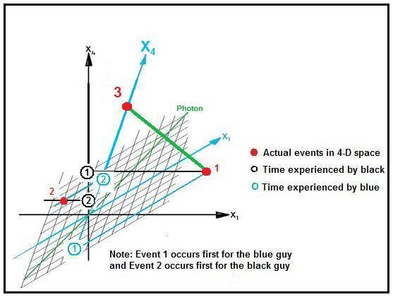

If you follow the photon world line from Event 1 to Event 3, you will see that the guy in x' (my blue guy) has not received the information about the light flash at Event 1 in time to communicate that information with the guy in the x coordinates (my black guy). To further complicate the discussion, you can see that the x' guy (blue) actually gets information about the light flash at Event 2 before he gets the information about the flash at Event 1, even though, in his coordinate system, Event 1 occurs first.
That's why it helps to do the spacetime diagrams, even if you could care less about whether the objects are 4-dimensional or not. However, if you are a true operationalist, then you may wish to ignore events out far away and be concerned only with directly observed light flashes as you experience them; then you can avoid spacetime diagrams.

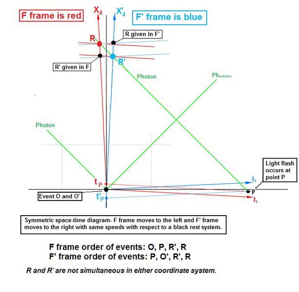

aawahab76, here is a spacetime diagram showing the point P and the points on the time and space axes for the x frame and the x' frame(my blue coordinates). I did not compute the values of the coordinates for the actual point P, but perhaps someone will.

aawahab76, I probably am answering a question that hasn't been asked again. However, I don't seem to get the same ordering of events as you've listed when I do the space-time diagram. This time I used a symmetric diagram in order to be sure that the scaling will be the same for both F and F'.
By the way, I have not used such small speeds as you wished, because it would require a much larger screen to achieve the required resolution. But, the basic relationships would not change. If you imagine rotating the axes so that they asymptotically approach the perpendiculare black coordinates, you will see that the points on the t and t' axes just get closer and closer together, so that the order of events are as they appear in my diagram.

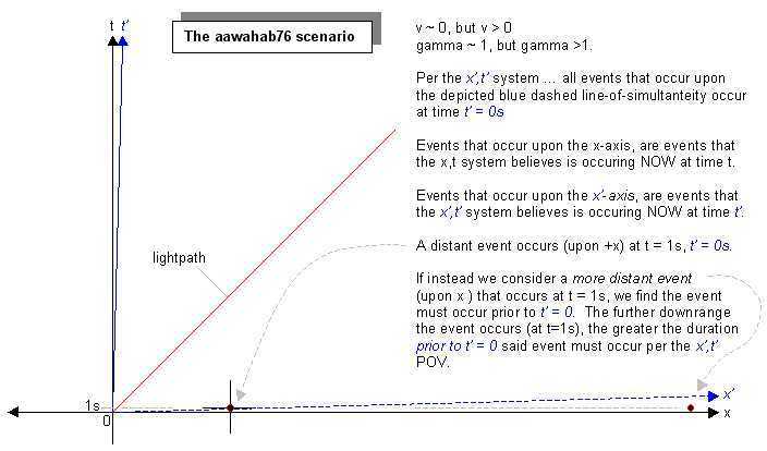

aawahab76 said:
My intention of the above list, to be completed below, is to find contradictory result or to grasp the physical sitiuation which is my aim from the begining.
While reading thru this, refer to the attached graphic of your scenario ...
What you are lacking, is the understanding of relative simultaneity. Systems of relative v > 0 disagree on the measure of space and time for remote events. This disagreement leads to what is known as "relative simultaneity". IOWs, they disagree as to what are simultaneous events. Graphically, this manifests itself as a rotation in spacetime between 2 systems moving relatively, which is why the time axes (and likewise space axes) are not parallel. They instead become angularly rotated wrt one another. In a Galillean system, the axes would indeed be parallel, but not so in relativity theory. BobC2 has shown you some graphics which present the case. I'll do the same here, while trying to minimize what's on the illustration to keep it simple. If you used your LT transforms to calculate all the events that occur per x,t along the depicted slanted blue dashed line, you will find that the LT results for all those events all occur at time t'=0 of the moving system. IOWs, the blue dashed line is the x',t' system's sense-of-NOW across the all of space "as he experiences it", at his time t'=0.
Clearly, the further you move the distant event downrange along +x (always at time t=1s), the further said event must have occurred back-in-time per the x',t' system, because it falls further and further below the blue dashed line which is the x',t' system's sense of NOW space-wide ... ie his own sense-of-simultaneity for t'=0.
Hope that helps as to the physical meaning you seek.
GrayGhost .

aawahab76,
I don't think the signal from event P is received at approximately the same time by each observer. Now, R' as given in the F frame (refer to my sketch) is approximately R'--maybe that is what you are thinking.

Thanks and you are correct (in F, R time is 10 times that of R'). The new corrected list is:
1- An observer in the x-frame has built his frame with the usual rulers and synchronized clocks (by the known method of Poincare and Einstein) with coordinates (t,x). We call this observer and its frame F. I think it would be understood when F ( and similarly for F' below) means the frame or the observer (located at the origin of spatial coordinates).
2- The same has been done by the x'-frame observer with coordinates (t',x'). This is called F'. F' moves with the speed v=10^(-10) m/s with respect to F (so F moves with the speed -10^(-10) m/s with respect to F").
3- An event is an absolute physical process and is independent of coordinates (or frames). An event can be represented in coordinates given by the reading of the clock and the reading of the ruler located at the event. This is done separately by each observer using his or her coordinates.
4- F and F' agree to set their time coordinates such that the event of their meeting is given by (0,0) in F and by (0',0') by F'. (0,0) is named O, and (0',0') is named O'.
5- An event P happen at (t,x)=(1 sec, 10^100 m) in F and at (t',x') in F' ( that is in F, P happened after O). We assume that the event is a flash of light.
6- The Lorentz transformation gives the corresponding coordinates of P at F', that is (t'≈-10^81 sec, x'≈10^100 m).
7- F receives the light from P at the event R given in F by (10^100/(3*10^8)=3.3*10^92 sec, 0).
8- Using the Lorentz transformation, R is given in F' by ((10/3)*10^92 sec,-10^91 m).
9- F' receives the light from P at the event R' given by ((1-10^(-10))(1+(1/3)*10^92) sec,0').
10- R' is given in F by using Lorentz transformation by ((1-10^(-10))(1+(1/3)*10^92) sec, 3*10^(-2)*(1-10^(-10))(1+(1/3)*10^92)).
11- In summary, in F we have the following events O, P, R and R'. Order of these events is O, P, R' and R (any way R and R' order may not be important).
12- Similarly, in F’ we have O’, P, R’ and R. Their order is P, O’, and R' and R (any way R and R' order may not be important).
13- Thus, our original problem can be cast in the following threefold points:
i- how does O before P in F but P before O' in F' (notice that O' is the coordinate representation in F' of the same event O)?
ii- why does a very small relative speed lead to such a huge difference in time for the event P in F' relative to F?
iii- why the Lorentz transformation (LT) does not in general reduce to the Galilean transformation (GT) ( but I think this may not be true if we define the non-relativistic limit to be the limit when c goes to infinity in which case LT reduces in general to GT). Any way, this third point may not be of interest at this moment.
14- As measured by the corresponding frame, P happened in very different times, but at approximately the same spatial location and R' was received in ten times less than in R. I am not yet intending any physical interpretation of this observation, if it is correct.
