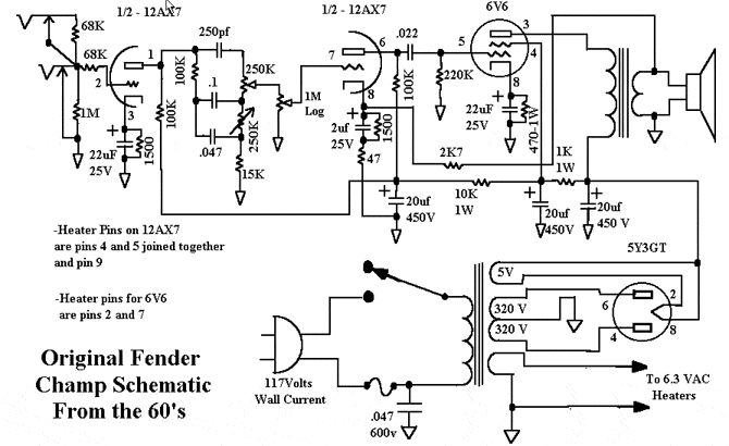

And when the DC in your amp is peaking when the DC in your buddy's amp is at its lowest, that's no problem, right?
The bloviating on this thread has been dreadful. Imagine you can plug in a Blackface Champ (I'm picking the simplest Fender circuit for practicality), and plug one into an outlet, and plug another into the same outlet with the polarity reversed. What happens if you check the chassis grounds of the two amps?

  • #64
What DC are you talking about? The plate suppy?
Do you mean the voltage between the two chassis? If you use a VOM then it should be zero, or close to it. If you use a more sensitive meter then you may read the transformer leakage I mentioned in my previous post. I'm assuming these amps have transformers.
I will take your advise and try to find schematic. But I can't imagine that these things would be wired so dangerously.
  • #65

  • #67
The chassis is isolated from the primary by the transformer. The chassis is not grounded (floating). There is a .047 mfd capacitor connecting one side of the primary to the chassis.
Depending on the sensitivity of the meter you may read 120 volts. But it is not dangerous because once a load is placed between the two chassis the voltage will disappear or drop dramatically. According to my calculations (considering the capacitive reactance of two .047 mfd capacitors and the resistance of the human body) there may be around 1 micro amp current flow if you touch the two chassis. I don't know if that's enough to feel, but I'm pretty sure it's harmless.

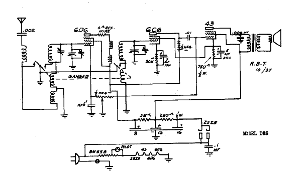

That circuit looks like a death trap.
If the switch, the transformer, the fuse holder or the .047 uF capacitor in the primary circuit of that transformer were to fail by shorting to the chassis, the chassis could easily become live at 110 volts.
At least it does have a transformer in it, and probably there aren't many of these around.
Any that are left should have a grounded plug and cord fitted or they should be thrown in a bin with the power cord cut off.

  • #70
No, it is not as safe as modern circuits because it is not grounded. But you have to remember that back in the 60's many U.S. households did not even have grounded receptacles. If you think that is a death trap then what do you think about this?
I use to collect and restore antique radios and this was very common. The radios were usually housed in a non conductive enclosure but they were still very dangerous. This particular model had a volume control and tuning capacitor that mounted on the chassis. The control shafts protruded from the case. If the plastic knob broke from the shaft then the user could be directly exposed to 120 volts.
When I first read this thread I thought this was the type of circuit that Turbo-1 was referring to. But then when he said the amps had power transformers I became confused about what he was talking about.
