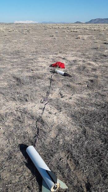

I just launched a 2.2kg model rocket that stands about 5 feet tall and has a airframe that is 4 inches in diameter. I am trying to find how much the impact force is when the rocket hits the ground at 16MPH.
Whats the best approach? Momentum? KE? or something else:)
thanks

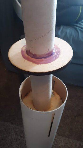

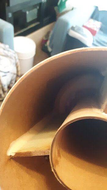

yeah, i have my fins mounted through the hull and on to the motor mount tube. The MMT is then epoxied into place using 3 rings. Each ring is 1/4 inch thick and 4 inch in diameter.
The fins mount in between the wooden rings. if that makes sense

So, why not put a larger parachute to slow it down further?
I imagine if anything yields in that setup, its going to be the cardboard body.

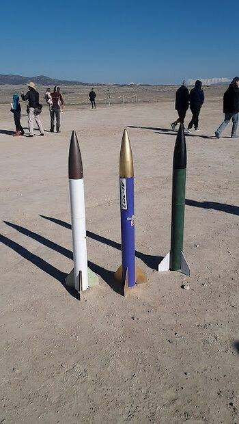

it has a 4 foot parachute. Thats the biggest i can use or it will not fit in the payload section of the rocket. I hit 5300 feet though so i am happy with that haha. I am now certified to launch high powered rockets.
