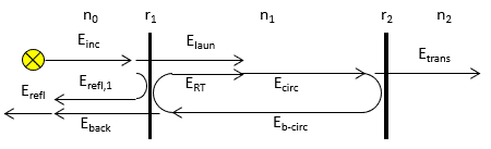

Sorry, but that still isn't what I'm asking. Take this diagram of a Fabry Perot I got from wikipedia.
It is well understood that the interference between Erefl,1 and Eback compensates for the interference between Elaun and ERT. I'm asking about the interference between Ecirc and Ebcirc. If this is partially constructive/destructive, how is energy still conserved?
Having the incident beam makes things a bit messy. Let's instead imagine a ringdown scenario, where the incident beam ##E_{inc}## is on for a long time and then abruptly turned off. When ##E_{inc}## is turned off, ##E_{refl,1}## and ##E_{laun}## also go to 0. Now ##E_{circ}## and ##E_{b-circ}## are the only fields inside the cavity. Since this isn't steady state, energy is not conserved. In this case, any constructive interference between ##E_{circ}## and ##E_{b-circ}## constitutes the stored energy of the resonator, and that energy will be dissipated by the outgoing beams ##E_{back}## and ##E_{trans}##.
If we had an ideal, perfect resonator where ##r_1 = r_2 = 1##, then ##E_{back}## and ##E_{trans}## would be 0 and energy would be conserved. The only non-zero fields would be ##E_{circ}## and ##E_{b-circ}##. In this case, there could be constructive interference inside the resonator and NO beams outside the resonator. This really hones in on the point: constructive interference inside the resonator translates to energy stored, but not energy gained. It doesn't need to be balanced by any other beams. It's the beams that go into or out from the cavity that have to be energy-balanced.
Edit: fixed a typo. It said ##r_1=r_2=0## before.
Thanks for the explanation. I have one more question. Physically, the absolute value squared of Ecirc and Ebcirc is proportional to the number of photons propagating in the forward and backward directions respectively. So logically speaking summing these two up gives you the number of photons inside the resonator. This however disregards the interference between the two fields, so do we still that into account when calculating the total intensity inside the resonator?
Yes. The photon number is proportional to ##|E_{circ} + E_{bcirc}|^2##, NOT ##|E_{circ}|^2 + |E_{bcirc}|^2##. The former accounts for interference and is the accurate formula for the intensity of the circulating fields, the latter has no interference and is meaningless.
I can see how ##|E_{circ}|^2## (##|E_{bcirc}|^2##) corresponds to the photons traveling in the forward (backward) direction, but what does the interference term physically correspond to though?
Forget photons completely! All you need is the electromagnetic field, Maxwell's equations and the conservation laws, here particularly "Poynting's theorem".
Before you start learning relativistic QFT, which is the only way to understand what photons are, you have learn classical electromagnetics!

Unfortunately, the course I'm currently studying deals with entirely semi-classical derivations, e.g. the Schawlow Townes linewidth is derived without considering quantum fluctuations, and I believe there is a semi-classical explanation to relate the interference with the photon number.
If you inject one photon's worth of ##E_{circ}## into a resonator with perfectly reflecting mirrors, that photon's reflection ##E_{bcirc}## will interfere with itself and form a standing wave. If you need a reason for this, it's because there's nothing at all in the resonator that would project the photon's state in position space so it will act like a wave and interfere with itself. Same logic as the two-slit experiment when you don't detect which slit the photon passes through.
The end result of this is that the photons populate standing waves, not forward and backward propagating traveling waves. If you were to stick some kind of direction-filtering optic into the resonator (a Faraday isolator, maybe?), you would be able to project the standing wave into either a forward or backward propagating wave. But until you introduce such an optic, the photon will occupy a standing wave state.
Because of this, asking "how many photons are forward/backward propagating?" is like asking "how many electrons are in a spin up/spin down state?" when the electrons are in the superposition state ##\frac{1}{\sqrt{2}} (|\uparrow \rangle + |\downarrow \rangle )##.
Does that help at all? Sorry if my explanation isn't clear, running on little sleep.
