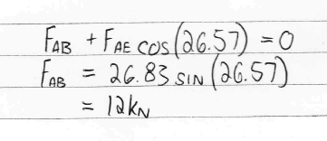

Hello, in the attached file shows a picture of the problem I need to resolve. The question asks to calculate the internal force in the member BC. There is a pin support located at joint A and D, which is not shown in my diagram, and it is also symmetrical, which makes things slightly easier.
See attached file.
I calculated the forces in the y direction using the equilibrium equation, and then calculated the angle between member AE and AB using basic trigonometry to be 26.57 degrees. I then resolved the internal forces in members AE and AB. However, I am unable to determine what else I can do with resolving further internal forces in this structure. For all other joints, there are at least 2 unknown forces, for which I am unable to determine any other internal forces. What should be my next approach? Thanks, forum.

You have an error in getting FAB.
You changed the cosine back into the sine .Also, can you clarify?
Is member EB perpendicular to member AG ?
Thank you, silly mistake there. And I'm not entirely sure, the question doesn't specify, but I'm assuming it is.
