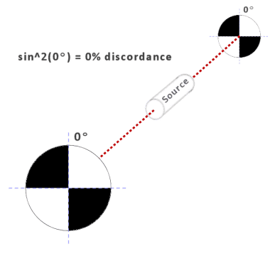

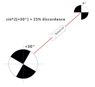

Let’s instead take one of the simplest proofs of Bell's Inequality, by Nick Herbert:
If both polarizers are set to , we will get perfect agreement, i.e. 100% matches and 0% discordance.
To start, we set first polarizer at +30º, and the second polarizer at :
If we calculate the discordance (i.e. the number of mismatching outcome), we get 25% according to QM and experiments.
Now, if we set first polarizer to , and the second polarizer to -30º:
This discordance will also naturally be 25%.
Now let’s ask ourselves:
– What will the discordance be if we set the polarizers to +30º and -30º??
If we assume a local reality, that NOTHING we do to one polarizer can affect the outcome of the other polarizer, we can formulate this simple Bell Inequality:
N(+30°, -30°) ≤ N(+30°, 0°) + N(0°, -30°)
The symbol N represents the number of discordance (or mismatches).
This inequality is as good as any other you’ve seen in this thread.
(The "is less than or equal to" sign ≤ is just to show that there could be compensating changes where a mismatch is converted to a match.)
We can make this simple Bell Inequality even simpler:
50% = 25% + 25%
This is the obvious local realistic assumption.
But this wrong! According to QM and physical experiments we will now get 75% discordance!
sin^2(60º) = 75%
Thus John Bell has demonstrated by the means of very brilliant and simple tools that our natural assumption about a local reality is by over 25% incompatible with the predictions of Quantum Mechanics and physical experiments.​

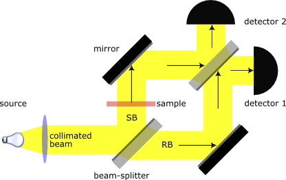

DevilsAvocado said:
This is so easy that even I can give you a correct answer: What happen is that the single wavefunction for one photon goes thru both slits, just as a single water wave, and after the slits starts creating an interference pattern, just as a single water wave.
When the wavefunction reaches the detector there are destructive and constructive amplitudes of probability for the photon to be detected.
Naturally, more single photons will be detected in those areas where there are constructive amplitudes of probability (= higher probability).
It’s very simple.
Incredible!
You have got it!
So if we hypothetically detect all photons even those with miserable detection probability we loose any idea about interference pattern.
That's what I call unfair sampling but you can call it whatever way you want.
Forget about ensemble interpretation. I can explain it to you using orthodox QM in much simpler way.
Just to check that we are on the same line. Consider http://en.wikipedia.org/wiki/Mach-Zehnder_interferometer" .
After we count all the phase shifts inside different mirrors Wikipedia says that: "there is no phase difference in the two beams in detector 1, yielding constructive interference." So detector 1 fires when photon arrives there (constructive interference) but detector 2 does not fire when photon arrives there (destructive interference).
So photons arrive at both detectors but because of interference one detector fires but the other don't.
Are we still on the same line here?
  • #1,399
Most people would say that no photons arrive at detector 2.
  • #1,400
After finally reading this entire thread, I feel confident saying that Zonde is not most people... :rolleyes:
