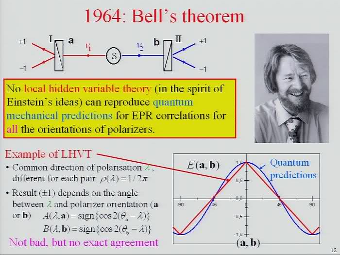

Malus Law applies in this situation. We can denote the individual detection rates as,
P(A) = cos2(|a - L|) and
P(B) = cos2(|b - Ll|)
where a and b are polarizer settings and L is the polarization angle of the optical disturbances incident on a and b.
Since the average angular difference between the polarizer setting and L is 45o, then the expected normalized individual detection rates are,
P(A) = .5 and
P(B) = .5
which agrees with QM prediction and experiment.
For the joint detection situation Malus Law also applies since we have crossed polarizers analyzing identically polarized optical emissions.
The relevant independent variable is the angular difference of the polarizer settings, |a-b|, which can be expressed as (||a-L| - |b-L||).
So, we can denoted the joint detection rate as
P(A,B) = cos2(||a-L| - |b-L||)
Sorry, this most definitely does NOT agree with experiment and the math is wrong. In fact the coincidence rate varies between .25 and .75 per your example. Experiment has it varying between 0 and 1.
See where your P(A)=.5 and p(B)=.5? That is correct. But it does not lead to your result. For example, where A=0 and B=0, you will NOT get correlation of 100% UNLESS you have entangled photons. Unentangled photons would have the same math as you describe but yield Product statistics. They are NOT the same. Yet they should be, according to you.
This is a frequent mistake that folks make in attempting to come up with local hidden variable models. You must model BOTH of these following cases successfully:
a) Polarization entangled photon pairs yield perfect correlations and entangled state statistics (the cos^2(theta) rule);
b) Polarization UNentangled photon pairs - coming from the same PDC crystal as in a) - yield Product State statistics (.25 + .5(cos^2(theta)). With these, the polarization is known, which is why they are not entangled.
Your example models b) and not a). If I need to, I will be glad to derive this for you in a later post. Or you can do it, but you must put in the correct values for the expansion.
I think you've got it backwards.
As the angular difference, |a - b| = ||a - L| - |b - L||, goes from 0o to 90o, the cos2 of that angular difference goes from 1 to 0.
The experiments I've seen have it varying between 0 and .5, and it never quite reaches those limits. It can't go to 1 if the individual detection rates never exceed .5 .
The correct expression for an idealized setup, normalized joint detection rate is, then,
.5 (cos2(|a-b|) ,
which would be modified depending on whatever inefficiencies are involved in the actual production of the data.
By the way, the normalization is wrt the detection rate with no polarizers present.
It can't. Isn't that what we've been discussing?
If you mean A and B to refer to detection rates, then the normalized individual rates with polarizers in place at both ends is always, in the ideal, A = .5 and B = .5 . If not, then I don't know what you're saying.
It accounts for a) in the assumptions underlying the application of Malus Law and the model(s) of the production of the entanglement via the emission process. Keep in mind that the perfect correlation/anticorrelation corresponding to angular differences of 0o and 90o have always been explainable assuming a local common cause for the entanglement.

Second: the joint detection rate is NOT cos^2(theta) in your example. It is actually .25+.5(cos^2(theta)) which is obviously different. This is the Product State statistics.
Remember: we are talking about your example. IF you take a pair of PDC photons at any KNOWN angle (the hypothesized L in your example) and actually check their polarizations at any angle settings A and B, THEN you will get .25+.5(cos^2(A-B)). That is an experimental fact.
What may be confusing is that PDC photon pairs can come out either polarization entangled or not. Either way, they have identical polarization! If the polarization is known, it is not entangled. You hypothesize that there is a definite polarization L associated with the photons. If there were such, then the expected statistics are PRODUCT state.
If, on the other hand, you specify that there is no definite polarization L, then you would have entanglement. But of course, then you would be accepting that no LHV can reproduce the predictions of QM - exactly what you wish to avoid. Of course, everyone else (save a diehard few) already accepts this.

Sorry, you are making an important mistake here. Yes, it is true that the photons you describe from the atom are entangled. However, the model you describe is NOT the same. Instead, it matches the PDC polarization unentangled situation I described above. You cannot say your model works if you apply it to the wrong situation. There is a GIANT different in Entangled State stats and Product State stats. Your example - where there is a definite polarization L - only matches the Product State situation. This is a very important distinction and you need to understand this. It is probably the reason you have had trouble seeing some of the arguments we have provided in the past.

As RUTA is also trying to tell you: Application of Malus as you are trying will NOT yield Entangled State stats. Please note that it is true that Malus is a cos^2 function, and so are the Entangled State statistics. But how you apply these are different for different experimental situations.
a) Application of Malus to (A-L) and (B-L) does NOT lead to Malus for (A-B) as you imagine. It leads to different stats, as I have already told you.
b) The reason you apply Malus to entangled pairs is because of the superposition of states: HH> + VV>. When you then apply rotation to the superposition, rotating by some A or B, you end up with an expression that simplifies to cos^2(A-B).
The Dehlinger reference derives this.

On the other hand, Dehlinger describes a DIFFERENT LHV than yours - as an example - and shows how it falls apart. But his works for the perfect correlation cases, which is more or less what EPR envisioned.
  • #157
ThomasT said:
The perfect correlation/anticorrelation corresponding to angular differences of 0o and 90o are accounted for by the identical polarizations of the members of each entangled pair.
No, they are not. Try it and you will see.
L=30 degrees
A=0 degrees
B=90 degrees
cos^2(A-L) * cos^2(B-L) = [Not 0 or 1 as QM predicts]
