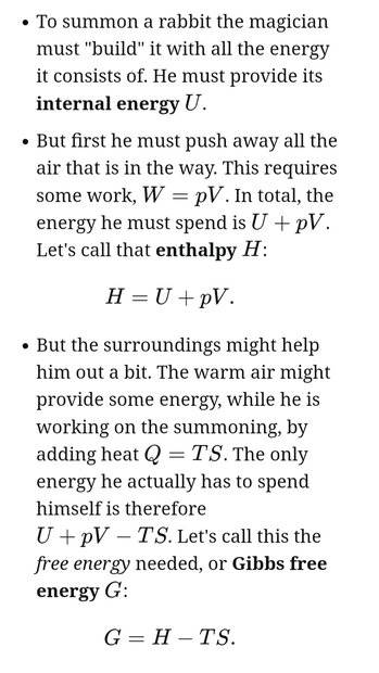

Gas expands from (1L, 10atm) to (4L, 5atm) against constant external pressure of 1 atm. The initial temperature is 300K and heat capacity is 50J/°C. Find change in enthalpy
$$1L.atm=100J\ (approx.)$$
$$\Delta U=Q+W$$
$$\Delta H=\Delta U+\Delta(PV)$$
This was the question
This is my solution
The problem arose after reading this post on PhysicsSE and this answer given
But first he must push away all the air that is in the way. This requires some work, ##W=pV##
. In total, the energy he must spend is U+pV
. Let's call that enthalpy ##H##
:$$H=U+pV.$$
So If I remember correct work done is ##-P_{ext}\Delta V##
I don't understand why $$\Delta H=\Delta U+(5×4-1×10)L.atm$$
If that answer (the answer on the PSE post) is correct, the extra work to "push all that air that is in the way" should be $$P_{ext}(\Delta V)=1×(3)L.atm$$
The change in internal energy accounts for extra energy to change the volume, pressure and temperature of the gas so only extra work to push the air out should be as I calculated above(their sum being change in enthalpy) and the solution would be wrong?
Your solution is correct, and, the work calculated in PhysicsSE is incorrect.
But this answer on physics SE was the best definition/analogy for enthalpy. How do I understand enthalpy now? (logically/intuitively)
It is not necessary to assign a physical interpretation to enthalpy. This description in SE is just a feeble attempt to do so (in my judgment). Again, in my judgment, enthalpy is just a convenient shorthand combination U and PV which occurs frequently in many analyses of thermodynamics. Unlike U and S, H is not a fundamental property of materials at thermodynamic equilibrium.
Of course, if you want to think of enthalpy the way they have interpreted it, there is nothing wrong with that.
