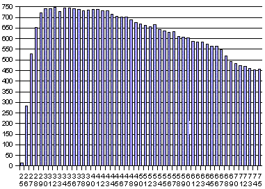

Just so
http://www.solarpower2day.net/images/9t.png

Let's look at a couple of examples from the net:
Looks pretty bad after only 5.5 years.
Though as the author says, the panels were run at 220% of their rated temperature, which according to the following, cuts their output significantly:
x axis is 'C, y-axis is watts, ignore T < 30'C per the author.
Hmmm... Interpolating the two graphs, it appears the panel was actually operating at 98.5% of it's rated capacity after 5.5 years. Not bad.
But I'll get back to you in August when the sun comes out again with proper documented values for my 4 panels.
