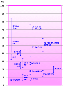

  • #115
mheslep said:
Of course, but the panels are not pointed at the snow. Is there significant flux in atmospheric scatter? I dunno.

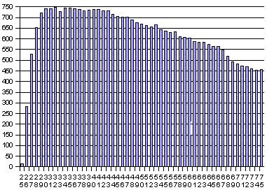

At 40 degrees from horizontal, the panels will be 140 degrees from the plane of snow. They would still catch light at that angle.
Also, as I noted back in https://www.physicsforums.com/showpost.php?p=2571575&postcount=67":
x axis is 'C, y-axis is watts, ignore T < 30'C per the author.
The temperature of the panels changes their output significantly. I know that when I set mine up in the summer to water the volley ball courts at the beach, you could fry eggs on them.
450 watts/750 watts = 60%
I'd say Artman's panels must be better than my old Kyoceras with only a 30% reduction in output.
Ah ha! You could almost interpolate the panel temperatures from http://www.schottsolar.com/fileadmin/media/us/data_sheets/SCHOTT%20POLY%20220-235%20Data%20Sheet%20US%200510.pdf" :
NOCT 25'C
Power %/'C -0.45
30%/0.45% + 25'C = 92'C
Yup. Probably could have fried eggs on them.

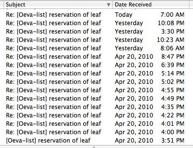

My laptop sounded like a pachinko machine the day they started taking reservations:
All were announcing they'd put in reservations.

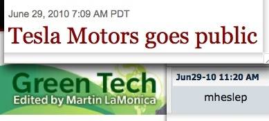

Good timing:
With a little cash on hand, maybe they can ramp up production = economies of scale <> $109k/vehicle

  • #116
Yes, but only diffuse light. Nothing normal to the plane of the panel. So the question is what is the impact of diffuse light. I dunno. Per Artman's results there likely is some impact.

  • #117
Two words: Skiers Tan:

b. Nerdish fact that I'd forgotten: One must place a plane 60' out of perpendicular with the sun before area drops to 1/2.
c. at an angle of 40', Artman's panels would be absorbing 64.3% of the full energy reflected by the snow. (assuming an infinite backyard :wink:)
d. the albedo of my lawn is ~11.4%(8.76% output, fully shaded, @ ~56.3' angle from horizontal)
  • #122
There you are then; I suppose that explains the power boost w/ snow on the ground. That, and the cold temperatures which improve efficiency.
