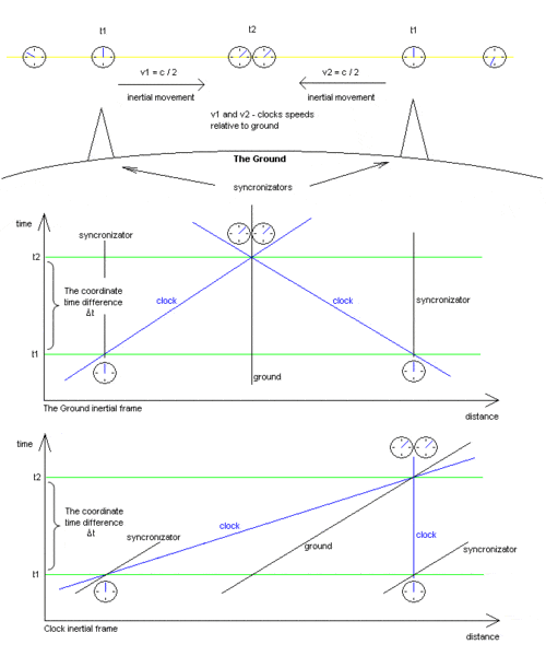

I believe the following question is related to the topic.
I have one simple (i believe) question to people who are familiar with relativity theory.
We have following cases in which we need to compare elapsed time on different clocks.
At the beginning of each experiment clocks will be syncronized.
We have measured marks on the ground: A 250m B 250m C 250m D 250m E
Clocks starts from a distance of 1 kilometer at points A and E.
At the end of each experiment elapsed times will be t1 and t2 accordingly.
So the Clock which started from A, at the end will show t1.
And the Clock which started from E, at the end will show t2.
The question for all cases is the same: t1 ? t2.
I mean:
Answer "1": t1 = t2
Answer "2": t1 < t2
Answer "3": t1 > t2
1. Both clocks are in inertial frames. At the end they meet in point C. (I hope the answer is "1")
2. Both clocks are in inertial frames. At the end they meet in point B.
3. Only the Right clocks (which come from E) is in inertial frame.
The Left clocks come to point C first and stops (smoothly).
After a second the Right clock comes to point C (and this is the end).
Could please somebody give answers for these all cases?

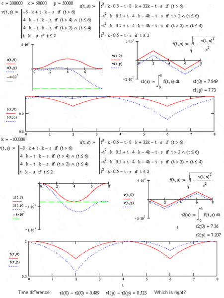

Ok let's try to use given formula: dτ² = dt² - dx²/c² - dy²/c² - dz²/c² for my "homework"
Let's take the first one: "Both clocks are in inertial frames. At the end they meet in point C."
We can use the following formula since we have only inertial movement:
Δτ = sqrt( (Δt)² - (Δx)²/c² - (Δy)²/c² - (Δz)²/c² ), ok?
Δy = 0
Δz = 0
So we will use Δτ = sqrt( (Δt)² - (Δx)²/c² )
Δx = 300000 km
Δt = 2 seconds
Calculation 1 - for inertial reference frame associated with A:

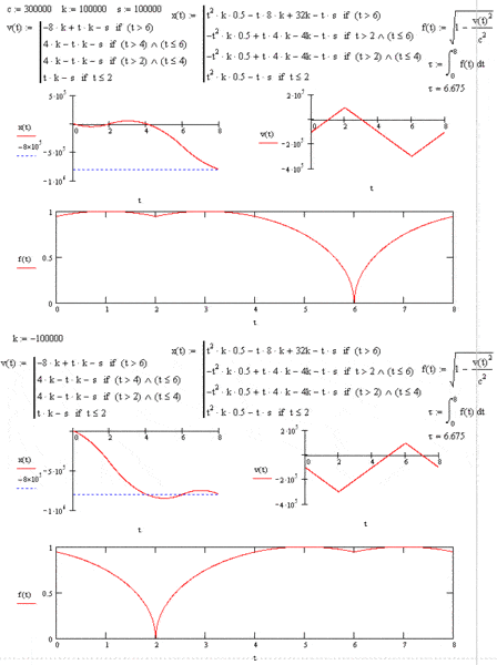

A: Δτ = sqrt( (Δt)² - (Δx)²/c² ) = sqrt( (2)² - ( 0 )² / c² ) = sqrt( (2)² ) = 2
B: Δτ = sqrt( (Δt)² - (Δx)²/c² ) = sqrt( (2)² - ( 300000 )² / c² ) = sqrt( 4 - 1 ) = sqrt( 3 ) = 1.732
So the time on clock A is 2 sec and the time on clock B is 1.732 sec.
Calculation 2 - for inertial reference frame associated with B:
A: Δτ = sqrt( (Δt)² - (Δx)²/c² ) = sqrt( (2)² - ( 300000 )² / c² ) = sqrt( 4 - 1 ) = sqrt( 3 ) = 1.732
B: Δτ = sqrt( (Δt)² - (Δx)²/c² ) = sqrt( (2)² - ( 0 )² / c² ) = sqrt( (2)² ) = 2
So the time on clock A is 1.732 sec and the time on clock B is 2 sec.
So which calculation is correct? Obviously neither. But why?
How to use this formula in a correct way?

Excellent effort using the formula! You haven't been here long, but you will soon realize how that simple effort sets you apart from the "cranks".
The nice thing about this formula is that it is frame-invariant. This means that you do not need to perform it in any particular reference frame since you will get the same answer in any inertial frame. Specifically, you can do it in the "ground" frame (the frame in which the clocks are initially synchronized). You should use that frame because that is the only frame where the coordinate time difference (Δt) is the same for both clocks.
Remember that simultaneity is relative so the fact that they are initially synchronized is only true in the ground frame. Therefore, if you transform into either clock's frame then you will need to find the start time separately for each clock which will result in a different Δt for each clock.
