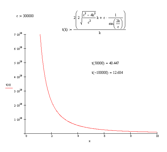

  • #88
Hi again,
I have made some calculations for the case with two clocks on spring.
Calculations are made for Inertial Reference Frame moving with speed "s" relative to start center point.
I have got the same proper time for both clocks (Clocks will show the same time).
So I'm happy with this.
But can somebody please take a look at my calculations below and tell if may be something is wrong?
Because I'm going to calculate for my second case using the same formulas.

Now I have calculations for the Case 2: clocks with different mass on the spring.
Mass affects velocity acceleration of each clock.
At the bottom of the image below you can find two results:
1. for Inertial Reference Frame associated with center start point.
2. for Inertial Reference Frame moving with speed "p".
The results are different.
But the formula I use is frame invariant.
So I would like to know why am I getting different results?
P.S. I believe we will use the same formula to calculate twins age difference?
So now I'm a little bit confused - which IRF I should take to get the real difference?
  • #91
I calculated the first one given the velocity profile you specified. It was all correct. I didn't bother to calculate the second one using the time-reversed velocity profile.
There are a couple of minor things wrong. [nitpick]First, the velocity profile does not represent a mass being pushed by a spring[/nitpick] but that really doesn't matter since you are free to specify any force you wish. More importantly you have specified a velocity profile that reaches c, and it should always be less than c. However, you only reached c instantaneously so it is not horrendously wrong.
By the way, in case you didn't know, you can loosely derive the formula you used from the formula I gave as follows:

  • #92
There are two problems here.
The first is that if you want to avoid relativity of simultaneity issues then you must start and end your clocks together. If they are not reunited at the end then if you stop the clocks simultaneously in one frame they will not be stopped simultaneously in any other frame.
The second issue is that you need to use the http://en.wikipedia.org/wiki/Velocity-addition_formula" formula if you want to find what the velocity profile looks like in another frame. Note that simple addition can easily result in velocities > c whereas the correct relativistic formula ensures that never happens.
  • #93
1. you must start and end your clocks together.
2. you need to use the http://en.wikipedia.org/wiki/Velocity-addition_formula" formula if you want to find what the velocity profile looks like in another frame.
1. My clocks start and end together! Do we still have an issue here? I'm not sure why you're telling me again about it.
2. Ok, but can you please be more specific: what exactly I have to do with the formula?
Look, we have 3 speed values here:
a) left clock speed relative to clocks mass center (is it still I guess?)
b) right clock speed relative to clocks mass center
c) calculations IRF speed relative to clocks mass center
So what do I have to do with these speeds and given formula?
Ok, I guess I have to do the following.
Before passing "v(t)" (velocity of time function) to the formula I have to acquire a "proper speed" from relativistic velocity addition formula, ok? And I have to do this for both clocks.
So I take "calculations IRF" speed as U and clocks speed as V and put it into the relativistic velocity addition formula, correct?
  • #94
Then I must be misunderstanding your graphs. In both of your plots of position it looks like the red clock and the dotted-blue clock start at the same point but end at different points. Could you please explain what each graph represents?
Yes. U will be constant (the relative velocity of the two frames), and V will be your v(t) function from the first reference frame. That will give you a new V'(t) which you can then put into f and integrate to get the time.
  • #95
The red graphs means calculation for IRF associated with center of mass.
The blue graphs means calculation for IRF moving with speed "s".
Upper calculations - is for heavy clock.
Bottom calculations - is for lite clock.
P.S. Sorry, I'll put a legend next time
  • #96
Ah, ok, I was misunderstanding. Now I see that the horizontal dashed green line is the x position where the two clocks meet at the end in the moving frame. So it looks like the velocity addition is the only problem.
  • #97
Now my calculations are made with regards to Velocity-addition formula.
But once again results are different!
May be I'm wrong with calculations?
Or just forgot one another thing?
Appreciate if you could look at my calculations below:
I suggest that may be my clocks will not meet in the "Moving IRF" according to new proper velocities?

Dalespam, Here I have used the formula you gave me to see the dependency of elapsed time from "k".
Once again, may be I'm wrong in my calculations but I getting very strange results.
And I can't get the results you have got in your calculations.
Anyway your formula gets me into bewilderment.
How can it possible: the amount of time elapsed depends on "k"!
The "k" is relative coefficient! It will be another in different IRFs! (and so the elapsed time will not be the same)
For sure it needs a "little bit" more explanation.
Because it absolutely not explicit for usual person at least.
  • #105
m.starkov said:
So now to caclulate the proper time I'm still have to use the function
[tex]\tau=\int_0^8 \sqrt{1-\frac{v(t)^2}{c^2}} \, dt[/tex]
and for this I have to put into it not my [tex]v(t) = k sin(t)[/tex] velocity but
I have to put a velocity which will be observed from the Primed Frame ("Moving IRF"), correct?
No, this is a "special case" formula that I derived as shown above specifically for the scenario you proposed. The v(t) in that formula is the specific function given above, not an arbitrary velocity in any frame.
Please use only the general equation I showed in post 55 (or the integral version of the same which I showed as the first integral in post 99). Once you have become proficient using the general formulas then you will know when you can apply "special case" formulas.
