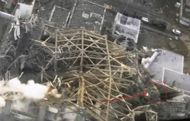

pdObq said:
A few pages back there has been some discussion about where the refueling crane (FHM = Fuel Handling Machine?) of unit 3 has gone, and if it could be below the big crane...
Looking at this image, I noticed that brownish-greenish structure with something that looks like a bent metal pole sticking out in the middle-left part of the image. There is some gray debris on its lower part, likely concrete pieces. Is it possible that this object is the unit 3 fuel crane that has maybe been ejected from the service floor in the unit 3 explosion? Would the size and its current position make any sense? The brownish color might be rust, and maybe we are seeing the bottom of the crane.
Its approximately the right size, and its in a place that would make sense.
However, looking at an image taken from a different angle clearly shows that its actually some sort of ground vehicle/crane that has an arm extending into the sky (the small one near bottom of this picture, not the larger more obvious crane):
