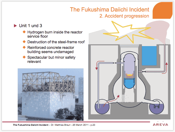

Thank you,
To summarize here is an hypothesis on the current situation made by Areva,
Does this scenario fit the available evidences?

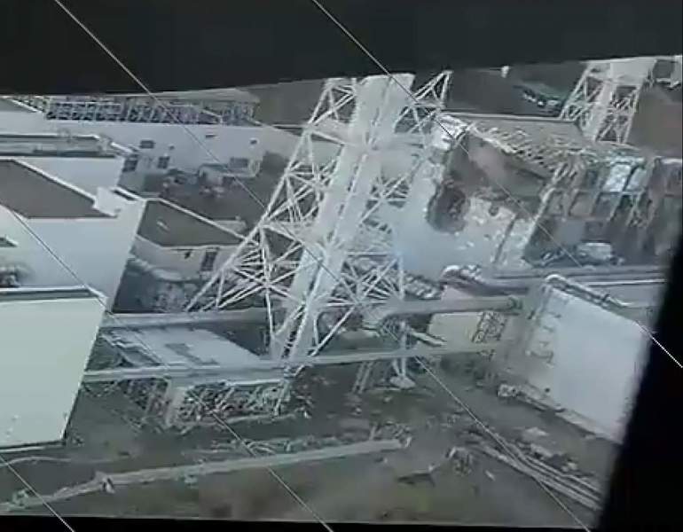

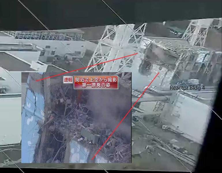

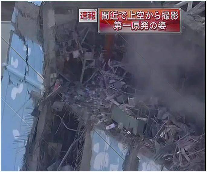

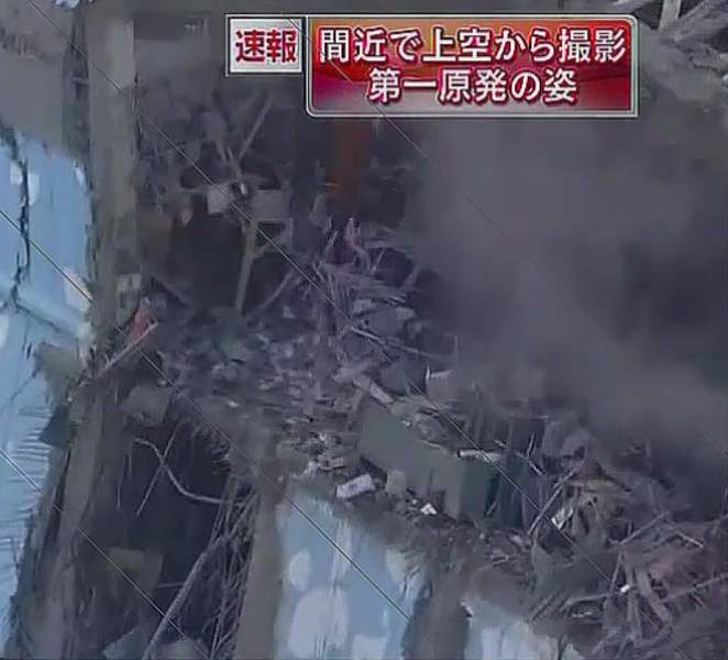

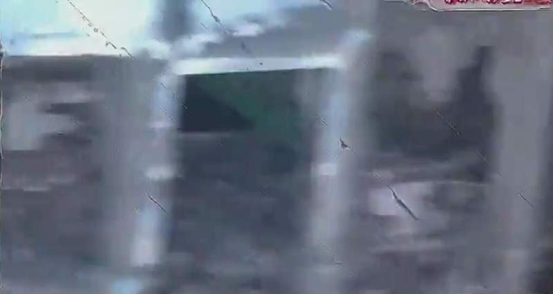

Gilles said:
Gentlemen, I read that on a French forum
and now the translation (sorry for the possible broken English)
and the screen shot
[PLAIN]http://www-laog.obs.ujf-grenoble.fr/~henri/Fukushima.gif
what's your opinion?
It appears the orange object is before the helicopter reaches the roof on reactor building 2 on its way to reactor building 3. So my opinion is that it is most unlikely to be the core of reactor 3 as it is in the wrong location.
The video you have linked is the clearest version I have seen of this video. From it I could tell that this mystery object:
Is the boom of a wheeled crane.

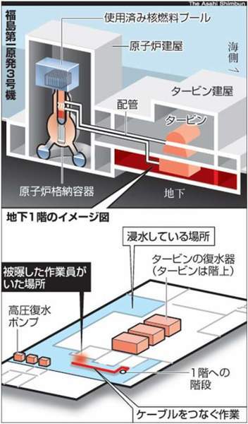

  • #1,311
"...the three injured workers had stepped into was 10,000 times the level normally seen in coolant water at the plant. It said that the amount of radiation the workers were thought to have been exposed to in the water was two to six sieverts."
http://www.nytimes.com/2011/03/26/world/asia/26japan.html?_r=3&hp=&pagewanted=all"
This is beginning to look more and more like Chernobyl, but perhaps in slow motion.

Thank you,
I am surprised that Areva, Europe's biggest builder of NPP would go public.
I checked the slide show - basically is the same as the picture I have made

'Two of the three have been hospitalised due to possible burns caused by beta rays, which can cause major skin damage.
They were not wearing boots at the time so their feet were soaked in the water.
TEPCO said almost no water was present during an on-site inspection the previous day and also that the level of radiation was low during the inspection.
"Because of this, the workers were believed to have continued their work even after their dosimeter alarm went off, assuming a problem with the machine," a TEPCO official said.
TEPCO plans to strictly reinforce the rule of evacuating the site whenever the dosimeter's alarm goes off.'
See:
http://www.abc.net.au/news/stories/2011/03/25/3173500.htm"
This is farcical.

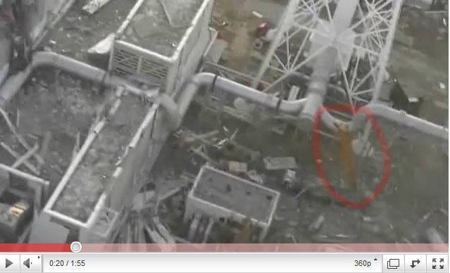

To all:
Please stop speculating about these red spots. There is a lot of debris of all colors in the area, just because something is red or orange doesn't mean it is hot and glowing. IR pictures don't confirm anything near red hot, that would mean 500-800 deg C or above, IR pictures show hot spots several hundred degrees lower. Let's stick to facts, there is already enough misinformation circulating around.

AtomicWombat said:
If it is indeed the the top of the reactor it is in the wrong place, suggesting the reactor was destroyed by the explosion in building 3, which has been my "best guess" for some time.
Sorry if this has already been commented on; I've been away for a few days.
jensjakob said:
I think that the round feature is the top of the tank just above it
No jensjacob, the tank above and behind the mystery object originally had a flat top, as you will see if you look at older footage. There were no domed vessels near the base of building 3 - or on it.
Maybe Occam should take his Razor to that?

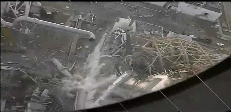

AntonL said:
In the last days we discussed bullets (debris at high velocity) smashing through
neighbouring roofs let's call these falling debris, being material blasted high into the sky and
falling at high equally high velocity. Penetration holes can be seen on turbine building no
3 and in the latest SDF video from two days back, showed steam escaping through holes
of unit 2 roof - possibly also a bombs from rector 3 explosion.
What we have not discussed are these large chunks of debris falling into the SPF and destroying the
spent fuel rods and unit 3 also had 200 brand new rods. In this case the Zirconium
jackets could be destroyed and fission products exposed to the water in the pools
Anton:
It is possible but not very likely that high-lofted falling debris could have damaged SFP3 or other buildings and structures. My initial assessment was that the greatest force of the blast went upward, from the explosion video. But the subsequent photos of the damage on the ground told a different story, with the greatest visible damage appearing to have come from a sideways blast.
I eventually resolved this in my mind by the observation that it was the concrete slabs blasting outward from the building that became bullet or missile like projectiles that did the damage, east and west, and the falling crane, damage to the north. But why, then, if most of the damage appeared to be on the southeast end was there little or no visible damage to Bldg 4? I will come back to that
The vertical component went through much lighter roof panels and may have been less constrained going upward, plus channeled upward by the stronger structure of the weight bearing beams and concrete slab sidewall construction and perhaps the 3SFP, particularly if any large volume of water in the 3SFP was explosively vaporized.
When you consider the absence of north side projectile damage, I believe it is because neither the north or south sides of the upper floor had concrete slabs. The weight bearing function of the east and west walls was to support the weight of the two side rails and the large overhead crane. The reinforced wall structure and the large side rails of the crane helped to hold things together somewhat, with the side panels popping out. Absent concrete panels and weight-bearing columns north and south, there was little projectile blast damage southward other than lighter debris, and nothing to constrain the overhead crane from being blasted out the north wall, or simply rolling down the rails and out the side of the building if the north wall and a couple of the north columns collapsed. The north side damage was to the adjacent lower building, not the side of Bldg2.
On the recent discussion of the flooding of the basement of Turbine Bldg 3, there was a side elevation diagram that showed the relationship of the height of the top of Reactor Bldg 3 vs the top of Turbine Bbldg 3. That will give a bit more insight into the trajectory of the side wall panels that blew out, east and west.
So, in retrospect, I can see how a hydrogen explosion first exited Bldg 3 upward and southward.
As for vertical upward, then downward "bomb-like" (falling debris), there are not that many candidates for heavy debris that could have been blown straight upward. These, in my mind, were
1) section(s) of the roof panels (sheet metal) and girders (not that heavy)
2) the fuel handling machine (visible in RB4 but not in RB3 after the blast,
3) the reinforced concrete plug or sections of the plug atop the drywall containment of reactor 3
4) the contents of SFP3 itself
If the plug blew from the drywall containment, then I cannot see with certainty where it punched through the roof girders, or where it fell to earth, or why a jet of steam, apparently from the drywall containment of RV3 might be seen afterward. It would leave a huge gaping hole and voluminous billowing smoke for days (maybe). This scenario seems very unlikely to me
If the fuel rods were blown straight up and out of SFP3 by the explosion, how did a blast above the level of the SFP3 cause it? Perhaps residual water in the SFP vaporized explosively. Very speculative at best and also seems very unlikely.
That only leaves one "heavy" candidate, the fuel handling machine, and I doubt that did enough damage falling to displace any fuel rods.
Addendum: Per Anton's request, please note that any reference to "bombs" or "missiles" refer to falling or flying debris, and should not be interpreted otherwise. Apologies to any conspiracy theorists who may have misunderstood.
The video you have linked is the clearest version I have seen of this video. ...
I fully agree and if it is red hot where is the smoke? There would be enough debris around to ignite

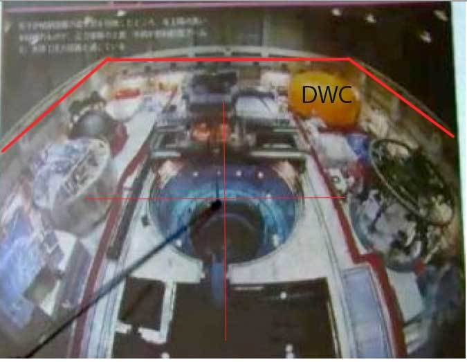

REGARDING THE EXPLOSION AT BLDG 3
The slide show of the proposed mechanism seems highly credible.
reference: http://www.scribd.com/doc/51564602?secret_password=th7hw1mmpjwnfmd0mbj
I see one obvious flaw, at least in the diagrammatic representation (diagram attached, again from above referenced slide show)
The explosion is shown occurring with a full SFP. There is a first hand account of large volumes of water sloshing out of one of the SFP's and onto a worker in the buliding (not sure which) at the time of the 9.0 quake. There is speculation that "damage" from the quake may have resulted in leaks and there are lots of calculations of the boil off time of water from the SFPs. But . . .
1) A hydrogen gas explosion occurred in Bldg 4 with an empty reactor core, and
2) as I pointed out earlier, the odds of the SFP's remaining full after the quake seem about the same as an open coffee cup in the cup holder of your car remaining full after driving over a dozen speed bumps without slowing down.
3) the explosion at Unit 3 was nothing like that at Unit 1, which occurred minutes after controlled venting at Unit 1.
Conclusion: there is no way to know the starting volume of water in any of the SFP's after the quake. Hydrogen gas from SFP's in 4 and quite possibly 3 may contributed to the explosions. Secondary damage to the SFP or reactor containment from the blast at Unit 3 cannot be dismissed as a possibility, as this slide would seem to indicate.

About the orange object and stuff, it is getting old , especially considering the data that were provided.. We really want to guess what it is from pixel-peeping ? Then we at the very least should try to get the perspective right and try to get a 3D view of what and where it is..Outside the secondary containment , top of a vertical structure (look at black lines)..
there you are, I got some of it right I think
[PLAIN]http://k.min.us/imlv0i.jpg
Thanks TCups,
Excellent link.
To me the obvious flaw is the clear difference in explosion mechanisms of reactor 1 and reactor 3, as you point out. We agree on this and we are trying to work out why. Dr Matthias Bruan's explanation (your link) makes complete sense for reactor 1. It is not consistent with the reactor 3 explosion.

Picture of the operating floor of UNIT 6 (similar to the operating floor of the other unit)
According to an Japanese engineer who work on the design of the containment vessel of unit 4
[PLAIN]http://min.us/jjP5c0.jpg

  • #1,333
I found these infographics of the basement flooding
Can someone translate?
translation provided
使用済み核燃料 SFP
海側 towards the ocean
タービン turbine
地下一階のイメージ図 underground (B1) map
浸水している場所 submerged area
タービンの復水器 machine to restore turbine water (literal translation - I don't know the technical name) - condensers
タービンは階上 turbine is upstairs
被曝した作業員がいた場所 place where workers were exposed to radiation
高圧復水ポンプ high pressure pump to return water
一階への階段 stairs to the first floor
ケーブルをつなぐ作業 work to connect the cable (electrical?)

TCups said:
Dude - that is a picture of the south wall elevation of Building 4. Check it out in this wide angle view. . .
TCups correct and right would be east and SE corner is the SFP!
Grabbed from this video, http://www.youtube.com/watch?v=95a8obR2GaE&feature=BF&list=ULr5HsMVY6W0k&index=3
presumably originally grabbed from a news broadcast, the low res video at 2:20 halts,
a high def view is shown for 12 seconds, and I presume the shimmer of water is discussed -
it was an issue as at the time as water was being sprayed into 3 and USA said that 4 is most
important and Tepco countered by saying water was spotted in 3
Just my thoughts and I did not say that the debris in the pool is from 3
[PLAIN]http://min.us/jjP5c0.jpg[/QUOTE]
Fred:
This would have to be a "Fish Eye" lens photo taken from atop the large crane. If I am seeing this correctly, then the large orange structure is the drywell cap (DWC) and it is not in the equipment pool. Also, Reactor Unit 6, I believe, was a later design. In this photo, the top of the reactor containment appears to be centered north-south and east-west, if oriented as were Bldg 3. Note the relationship of the (two?) pools to the right of the larger SFP and that there are apparently channels, smaller, but not unlike the channel to the primary containment, connecting all 3 pools.
I have to believe this layout is a bit different from what may be in Units 3 and 4.
Also, IF the plug were blown in Unit 3, then the DWC would have blown skyward too. That would be a pretty large chunk of painted metal debris which might be visible on the satellite photos. I haven't seen anything like it on the ground.
I see no shimmer at unit 4, 2:20 on the video -- I see part of the green fuel handling equipment through some smoke.
And before the 9 minute version of the video was edited, there was a pretty good shot of the SFP of 3 (just before the 'copter passed through the steam/smoke) that showed what looked like a deep black hole at SFP3. One of my earlier posts has a screenshot. Maybe I can find it.
. . . yes. Here is the original 9 minute video link
and post #784, page 49 shows the best look into SFP3 from the original 'copter fly over video.

  • #1,338
only translating the non-obvious ones (but even some of these are obvious):
使用済み核燃料 SFP
タービン turbine
The interesting stuff looks like it's on the bottom half - if you need any other translations of the diagram on top, just post/ask...

But it is thought that contractors ignored alarms from their dosimeters, while ankle-deep in contaminated water for about three hours.
Also, it is incomprehensible that station Health Physicist would not know the basement of Turbine Building always has low levels of radioactive contamination present in wet areas. Which would increase during a reactor accident and by the use of the feed system to inject water into the reactor. At some point to keep the RPV from going solid, they had to let some water out to somewhere.

M. Bachmeier said:
I read a report somewhere that indicated that pressure sensing equipment for units 2 and 3 might not be operable or reliable.
I believe that there was conjecture on this site about that. I do not remember reading it outside of this forum. Anybody have a link?
  • #1,344
Couple of questions:
What is the purpose of the dry-well cap, outside of the obvious?
More specific, is it also designed to help prevent or deflect energies from the ejection of core material in case of a catastrophic event?
How heavy would the steel gauge be for the cap?
Are all these dry-well caps orange?
If they are orange would in not be possible to observe the cap from number 3 reactor from aerial observation?
The dry well/Primary Reactor Vessel Containment cap is a pressure boundary/seal for the primary containment. Stacked concrete and inflatable seals would not hold sufficient pressure. It is thick steel, probably over 3/4". Do not know if the color is pertinent, and probably is a corrosion inhibitor paint.
