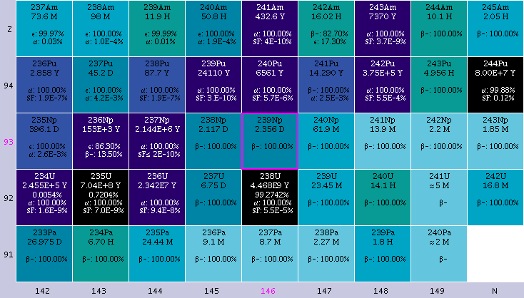

Pu isotopes have shorter half-lives than the two main U isotopes, U-235 and U-238. Radiologically, the same number of atoms of Pu would be more radioactive.
Uranium dioxide fuel contains up to 5% U-235. The FK BWR fuel should have a peak enrichment around 4% U-235.
MOX might contain about 5%, which would be a mix of Pu-239, 240, 241 and 242. Pu-240 and Pu-242 also undergo spontaneous fission.
See attached figure.

I don't know the context. If he was referring to fresh fuel, he would be wrong. He might be thinking of irradiated UO2 and MOX fuel, which develop a similar array of fission products. In fact, UO2 becomes MOX fuel as it is irradiated.
How Pu is radiologically more hazardous than U.
Chemically, both being heavy metals, they may be comparable in toxicity.

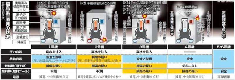

AntonL said:
Here is a time line of the explosions and reported CV venting
Unit 1 - 12.03.2011 at 15:36 : CVv 15:00 on 12.03.11
Unit 3 - 14.03.2011 at 11:01 : CVv 09:20 on 13.03.11
Unit 4 - 15.03.2011 at 06:14
Unit 2 - 15.03.2011 at 06:20 : CVv 11:55 on 13.03.11
There is a correlation between Unit 1 CV venting and Hydrogen blast.
Below SFP data FU = fuel units followed by pool volume and heat load of the FU
Unit 1 - 292 FU 1200m3 60kW
Unit 2 - 587 FU 1425m3 400kW
Unit 3 - 514 FU 1425m3 200kW
Unit 4 - 1331 FU 1425m3 2000kW + 200 brand new FU (yes 2MW not a typo)
This sets a new light on my earlier proposal
Unit 1 exploded due to H2 leak of venting system - possibly Earth quake damage
[STRIKE]Unit 2 to 4 exploded due to hydrogen generation from equipment pools.[/STRIKE]
https://www.physicsforums.com/attachment.php?attachmentid=33572&stc=1&d=1301164813
From above slide, and knowledge gained I revise what I posted earlier
Unit 1 - Explosion after venting - H2 leak in venting system
Unit 2 - Explosion at Torus - Torus has small leak, possibly a crack allowing H2 to vent.
Unit 3 - Explosion due to H2 leak at PVC-dome due to high pressure
Unit 4 - Explosion due to H2 generated in SFP
Core damage in all three working reactors.
And the water leak problem still to be found
Four units and four different failure modes leads to one conclusion:
BWR are not as safe as they are said to be. It is time to switch them off.
Conclusions already made by industry experts (see attached pdf file)
1. All existing power plants' passive emergency cooling systems (BWR's
RCIC and PWR's turbine-driven auxiliary feedwater system) should be inspected
and reinforced to assure their reliability during adverse condition. Onsite
emergency generators should be further protected.
2. PWR is more resilient than BWR because of its steam generator secondary
water inventory and size of containment. This gives larger margin to core damage
and containment failure. Further review is still necessary to improve the safety
level.
3. Spent fuel pool safety has been grossly overlooked. A hardened and
independent top spray system is necessary for all nuclear power plants.
Please read attached pdf file - the most authoritative analysis yet found.
Anton: At glance, I'd say you missed something on the Japanese slide. Look again, Grasshopper!
Unit 3 - Explosion due to H2 leak at PVC-dome due to high pressure AND H2 from SFP
But more to read. Thanks.

I have a mundane question. Is Plutonium more toxic or radioactive than Uranium? I thought it was, but a spokesman from the Nuclear Safety Agency specifically denied this. Other "experts" seem to contradict his statement.
Plutonium is far more hazardous than Uranium. Plutonium has a very high specific activity as compared to Uranium. It takes very little Plutonium to cause radiological damage from the alpha particles once inhaled. As I recall a lung burden of Plutonium is around 16 nanoCuries.
In the case of MOX fuel once the plutonium is encased in the fuel assembly and undergoes fission the resulting fission yield curves are close to the Uranium fission yields and the fission products become a higher hazard level than Plutonium. Again look at the specific activities.
