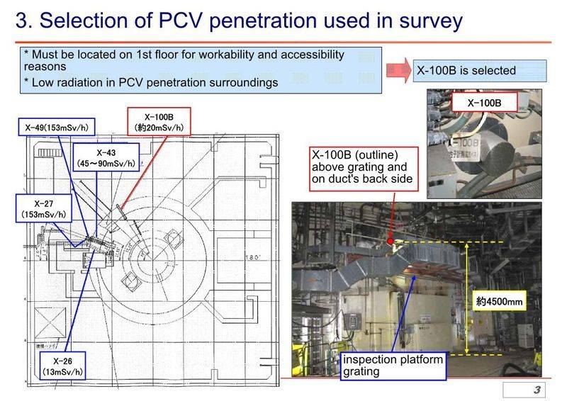

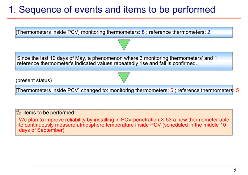

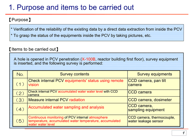

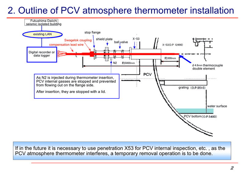

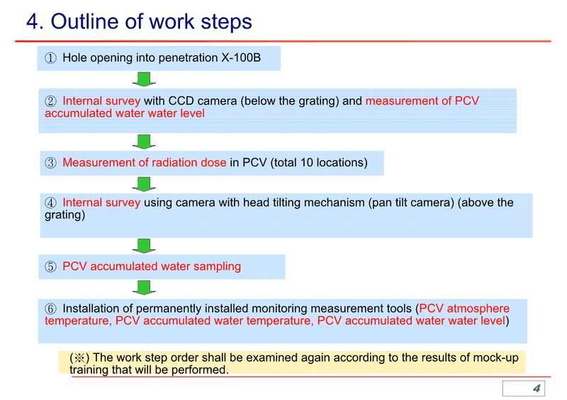

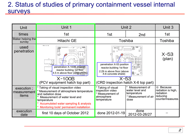

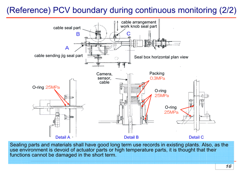

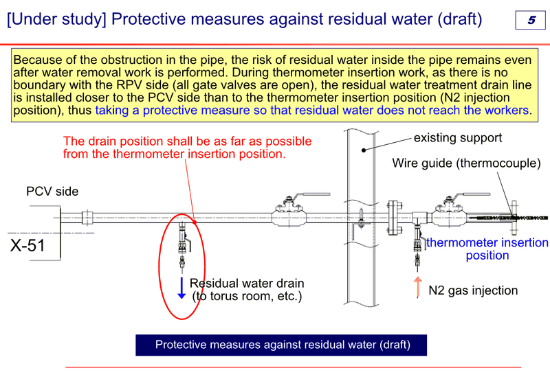

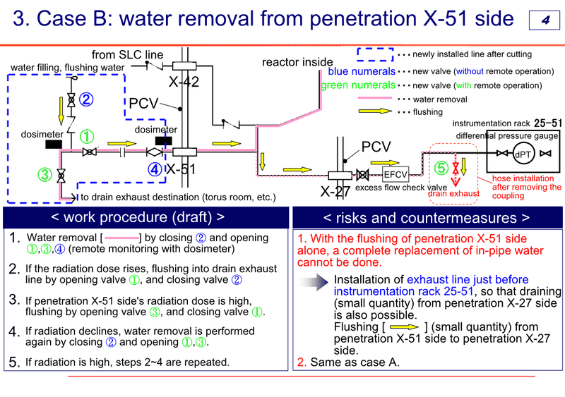

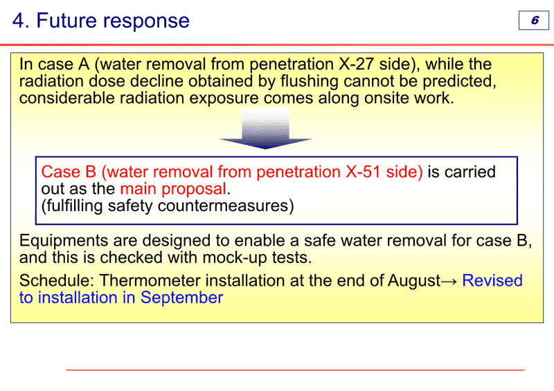

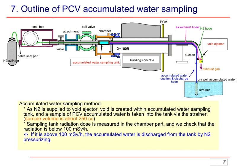

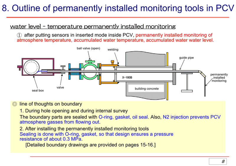

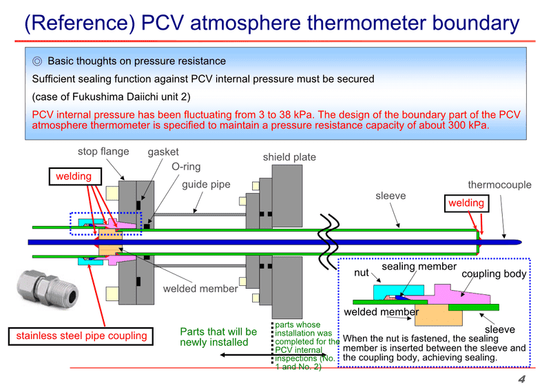

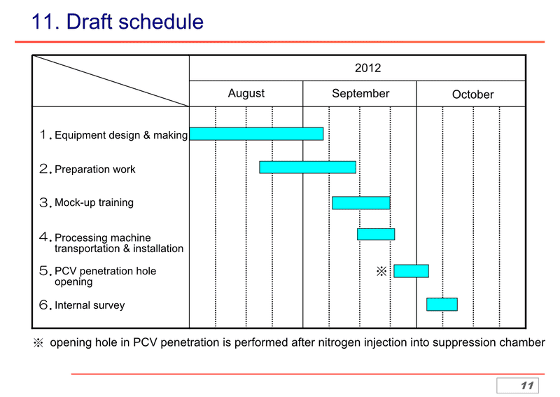

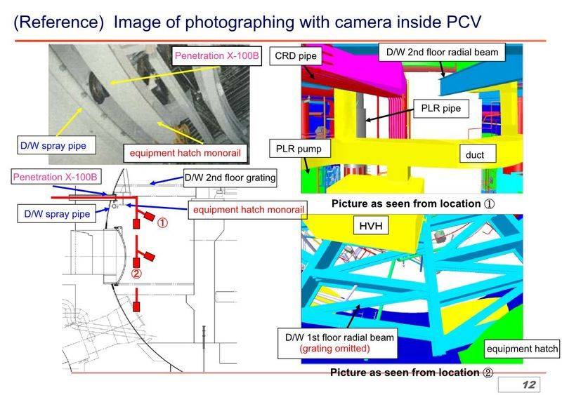

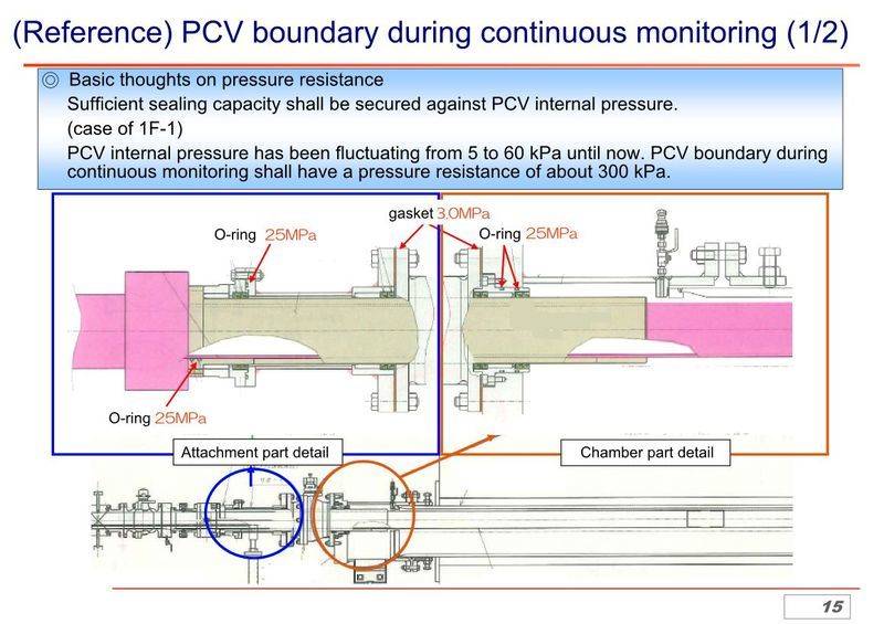

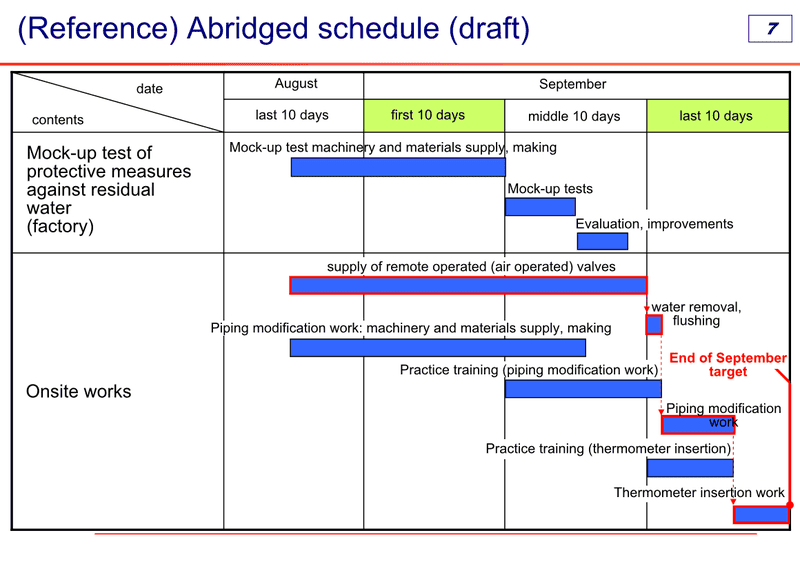

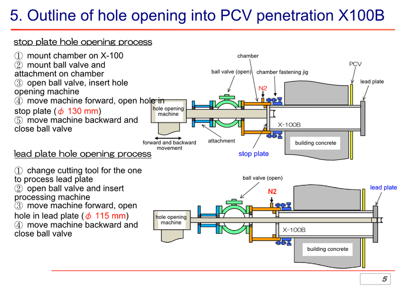

  • #13,624
tsutsuji said:
2) translation:[/color]
27 august 2012 government-tokyo electric mid and long term response committee, steering committee (9th meeting)
document 3 study and execution of each special plan
3-1 cooling by closed loop water injection

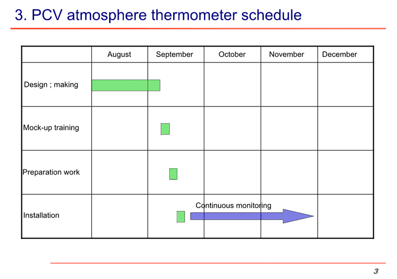

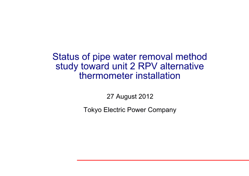

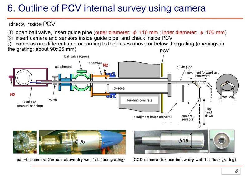

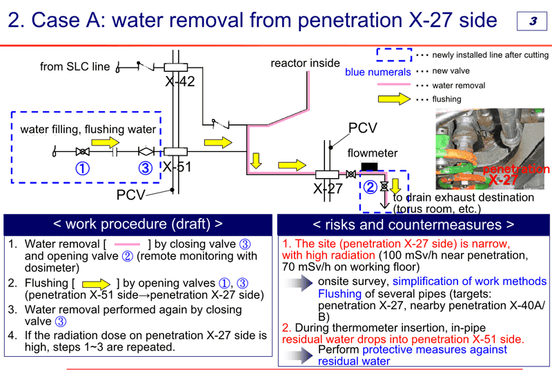

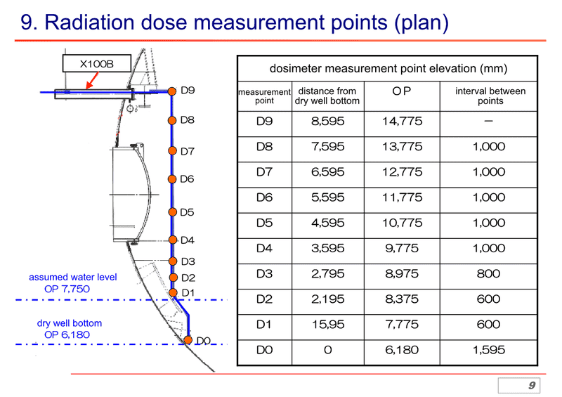

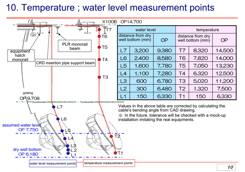

http://www.meti.go.jp/earthquake/nuclear/pdf/120827/120827_01h.pdf Installation of unit 2 pcv atmosphere thermometer
1/5
2/5
3/5
  • #13,625
4/5
5/5

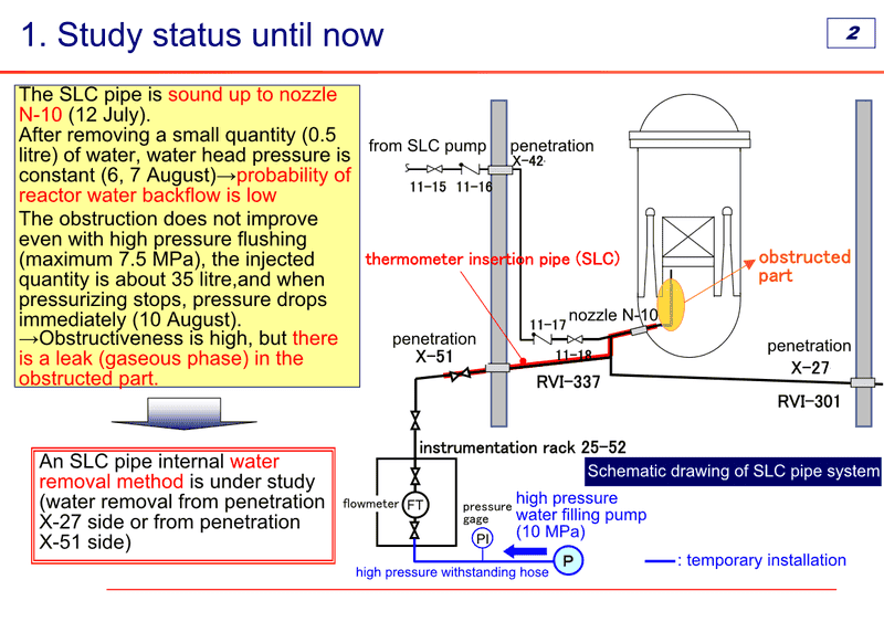

  • #13,630
tsutsuji said:
2) Translation:
27 August 2012 government-Tokyo Electric mid and long term response committee, steering committee (9th meeting)
3-1 Cooling by closed loop water injection
http://www.meti.go.jp/earthquake/nuclear/pdf/120827/120827_01k.pdf Status of pipe water removal method study, toward the installation of unit 2 RPV alternative thermometer
1/7
2/7
3/7
  • #13,631
4/7
5/7
6/7
  • #13,632
7/7

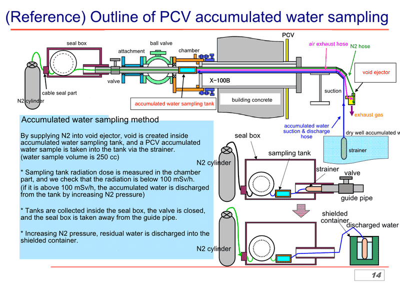

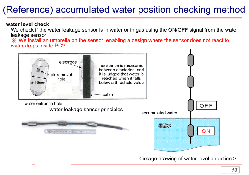

  • #13,641
http://www.meti.go.jp/earthquake/nuclear/pdf/120827/120827_01g.pdf Inspection inside unit 1's PCV
1) Previous related topics:
https://www.physicsforums.com/showthread.php?p=3934954#post3934954 6th meeting (25 May 2012) Execution of internal survey into unit 1 primary containment vessel (PCV)
2) Translation:
01/17
02/17
03/17
  • #13,642
2) Translation:
04/17
05/17
06/17
  • #13,643
2) Translation:
07/17
08/17
09/17
  • #13,644
2) Translation:
10/17
11/17
12/17
  • #13,645
2) Translation:
13/17
14/17
15/17
  • #13,646
2) Translation:
16/17
17/17
