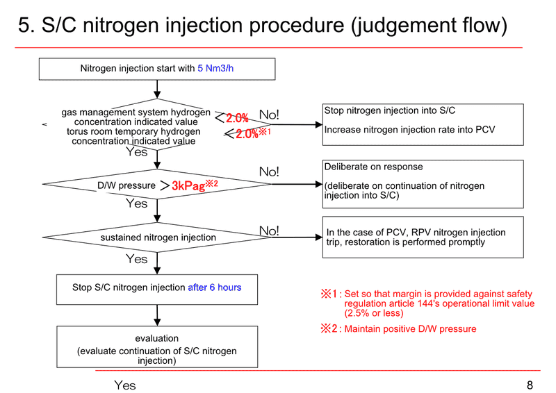

tsutsuji said:

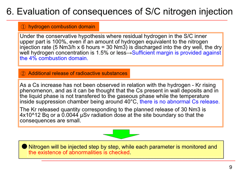

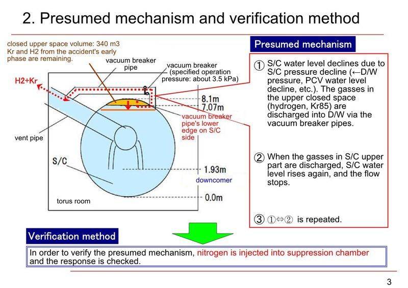

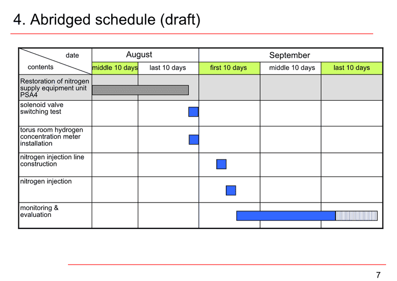

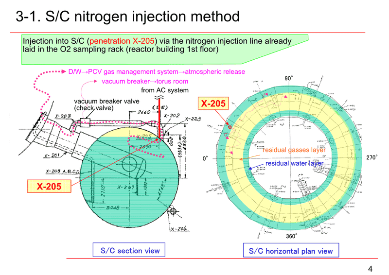

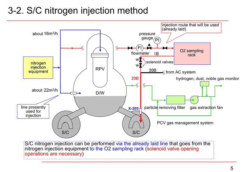

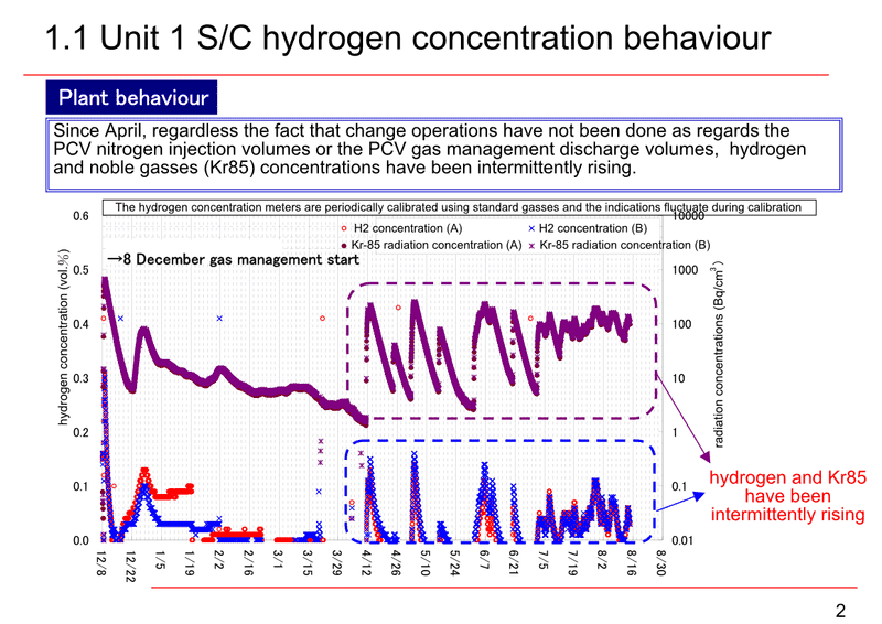

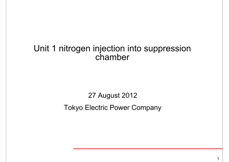

27 August 2012 government-Tokyo Electric mid and long term response committee, steering committee (9th meeting)

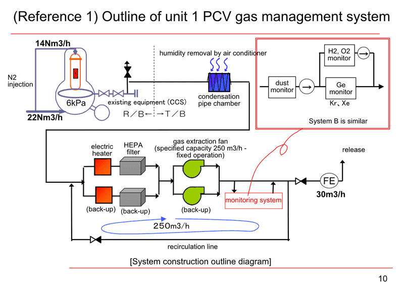

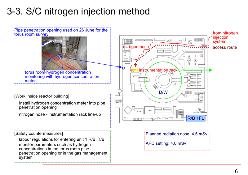

3-1 Cooling by closed loop water injection
http://www.meti.go.jp/earthquake/nuclear/pdf/120827/120827_01j.pdf Nitrogen injection into unit 1's suppression chamber
2) Translation:
01/11
02/11
03/11
  • #13,652
2) Translation:
04/11
05/11
06/11
  • #13,653
2) Translation:
07/11
08/11
09/11

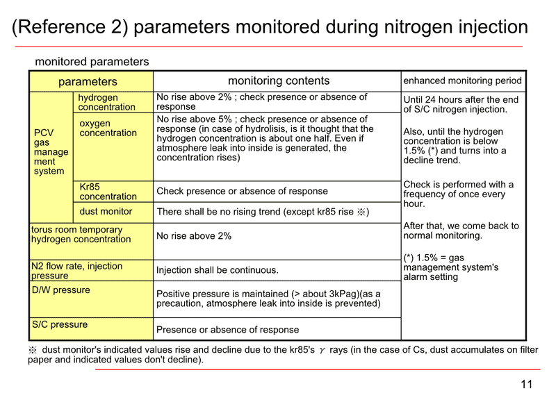

  • #13,654
2) Translation:
10/11
11/11

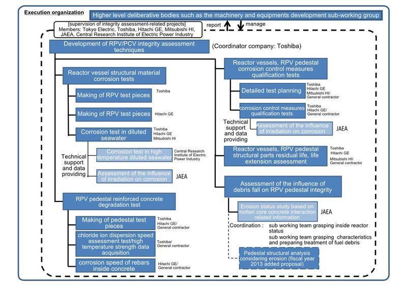

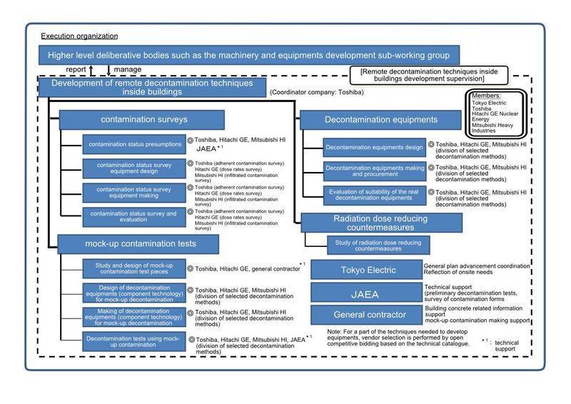

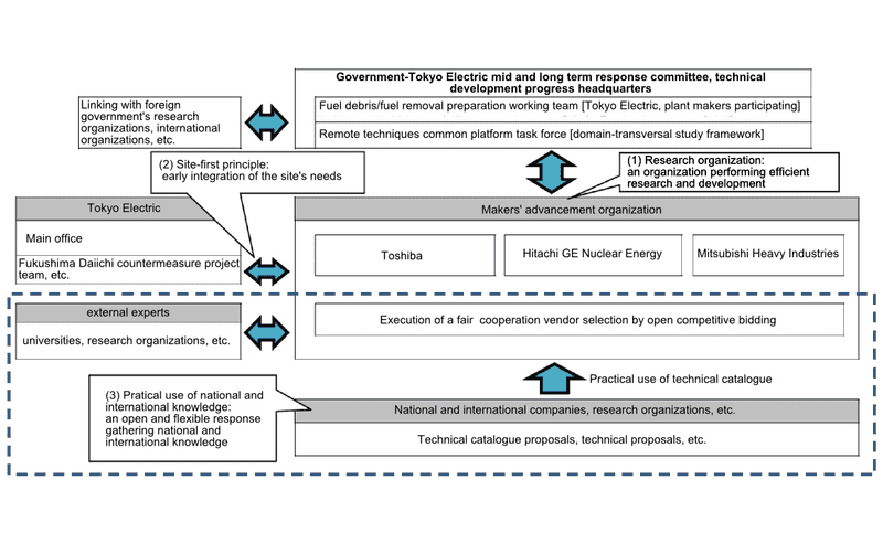

  • #13,660

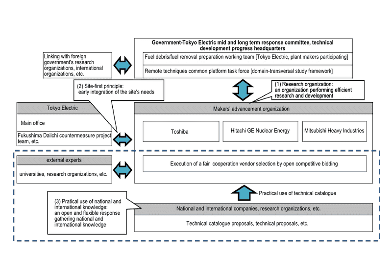

Thanks everybody for the encouraging comments. I have started translating http://www.meti.go.jp/earthquake/nuclear/pdf/120827/120827_02c.pdf "Progress status of development of machinery and equipments to prepare fuel debris removal" which will give a glimpse of the research & development planned by Toshiba/Hitachi/Mitsubishi over the longer term. But this will take me quite some time as these are 34 pages, some of which are rather dense.
The first diagram:

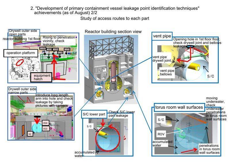

Those interested in the containment equipment hatch at reactor 3 may be interested to check pages 33-37, where it discusses possible containment leak points at the reactors. They look at radiation levels detected at different points in the different reactors, and also analysis of hydrogen behaviour. They are quite clear to mention the possibility of leakage from the 'machine hatch' at reactor 3. Plenty else is discussed too, I just thought Id mention that one since on this thread we had quite a lengthy discussion about the equipment hatch at reactor 3, back when TEPCO sent a camera into that area. But as usual TEPCO were not talking usefully about leaks, leaving us to come up with our own narrative to go with the images.
  • #13,668
I forgot to mention there is also a large set of diagrams for that report:
http://www.nisa.meti.go.jp/english/press/2012/06/en20120615-1-2.pdf
For example diagrams relating to hydrogen leak point modelling are on pages 101-106 and pages 118-122 deal with the effect that an open blowout panel can have on hydrogen buildup.

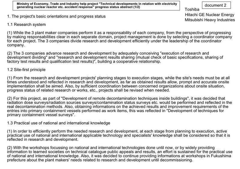

  • #13,670

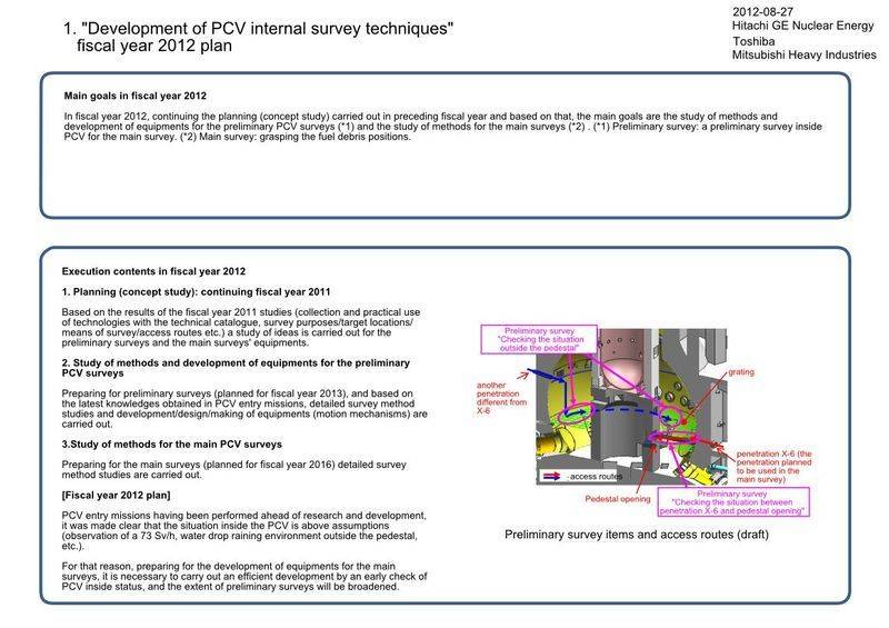

tsutsuji said:

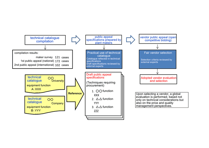

27 August 2012 government-Tokyo Electric mid and long term response committee, technical development progress headquarters (8th meeting) ( http://www.meti.go.jp/earthquake/nuclear/20120827_02.html )
Document 2
http://www.meti.go.jp/earthquake/nuclear/pdf/120827/120827_02c.pdf Progress status of development of machinery and equipments to prepare fuel debris removal
1) Previous related topics:
http://www.tepco.co.jp/en/press/corp-com/release/betu11_e/images/111221e14.pdf (English) p. 54/94-94/94: "Research and Development Road Map for Decommissioning Units 1~4 at TEPCO's Fukushima Daiichi Nuclear Power Plant" (1st meeting of the Government-TEPCO Mid-and-long Term Response Council, 21 December 2011)

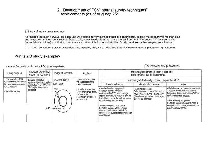

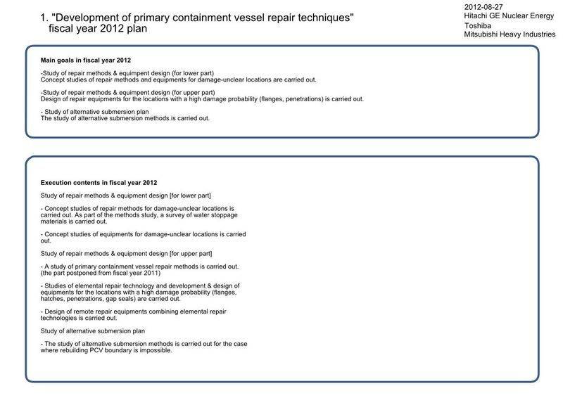

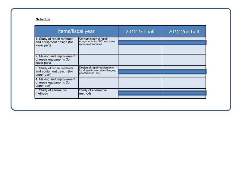

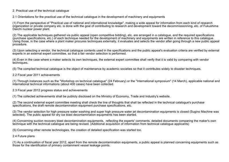

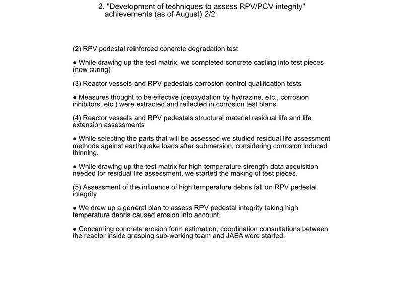

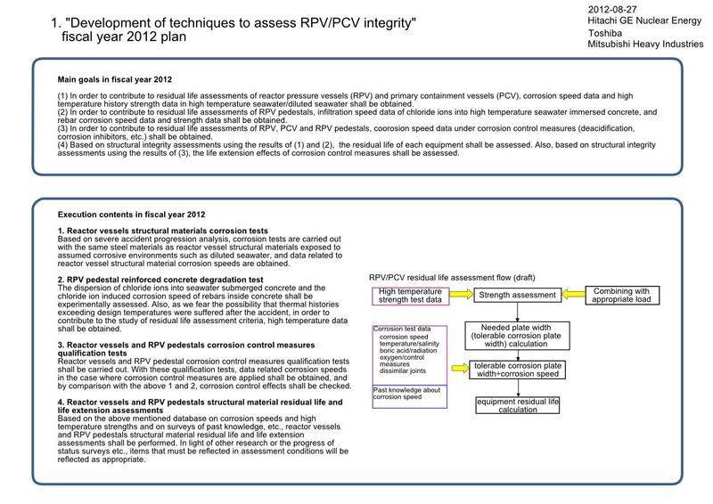

2) Translation: [installment 1: abstract]
01/34 (1/4)
01/34 (2/4)

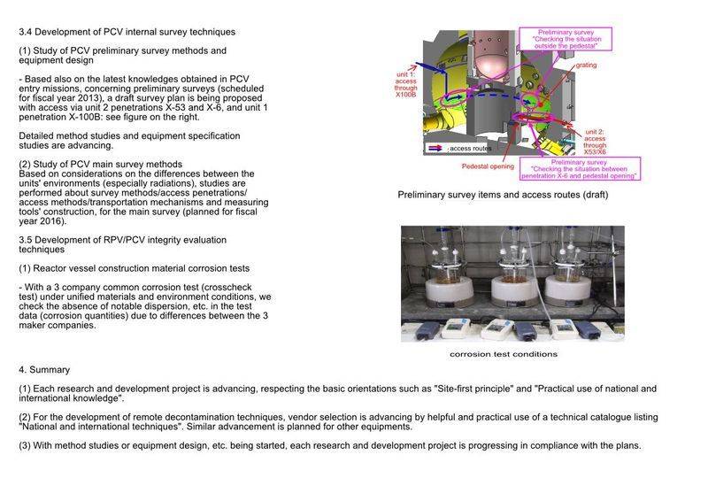

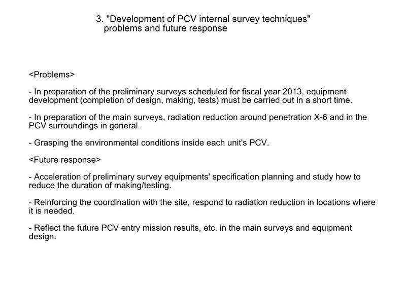

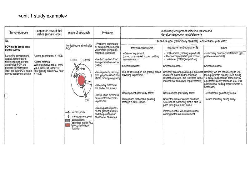

  • #13,671
01/34 (3/4)
01/34 (4/4)

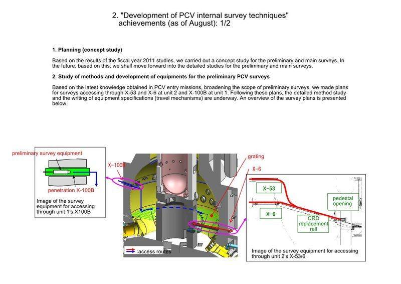

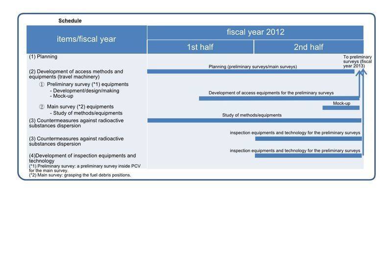

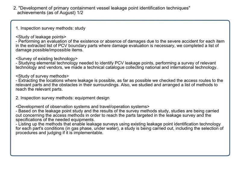

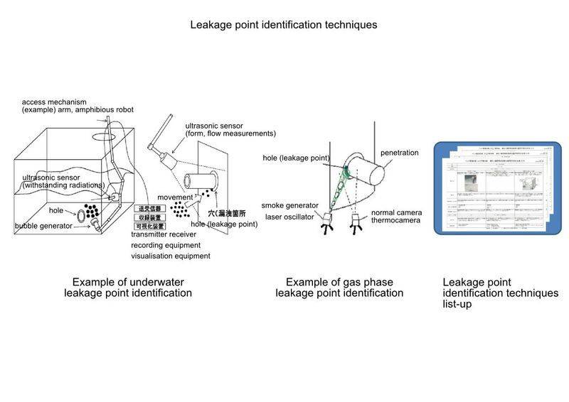

  • #13,672
02/34 (1/3)
02/34 (2/3)
02/34 (3/3)

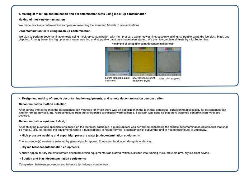

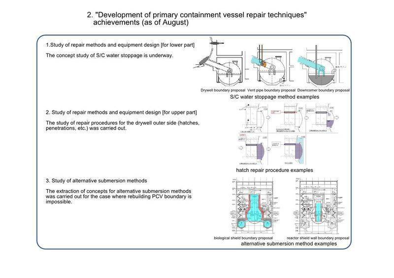

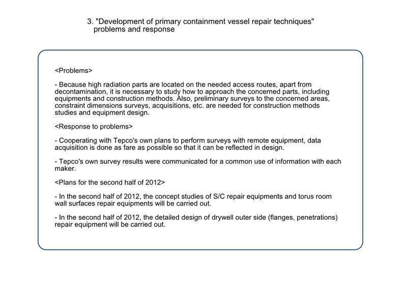

  • #13,673
tsutsuji said:
Tepco is saying so in the note at the bottom of http://www.meti.go.jp/earthquake/nuclear/pdf/120827/120827_01d.pdf page 1:
効率的な冷却のため,7/27,8/13に注水流量を減少させた結果,原子炉関連温度は上昇傾向を示しており,引き続き傾向監視を継続している。
Because cooling is efficient, water injection rate was reduced on 27 July and 13 August, and as a result, reactor related temperatures are indicating a rising trend. As a follow-up, we are continuously monitoring the trend.
Okay, so we have had slightly rising temperatures in June/July, subsequently a chiller installed, and then deliberately reduced water injection rates at stable temperatures. At the end of August, we have injections rates that inexplicably dropped below the required amounts and, one has to assume, again rising temperatures as at least one of the indicators for or results of that. (By the way, thanks to everyone who responded to my question how injection rates and what gets to the core is measured.)
Bottom line seems to be, temperatures are rising. No?
And we (or TEPCO) assume(s) its because its summer and/or because something is clogging up the pipes or valves or whatever.
And so here's my new question: with so many unknowns and variables, is the real message/news here not that temperatures are rising for uncertain reasons and we're all guessing why, likely including TEPCO?

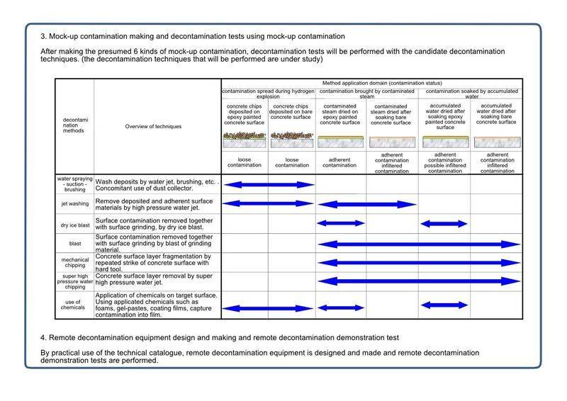

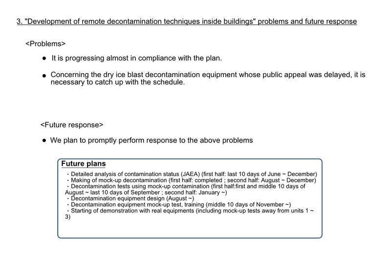

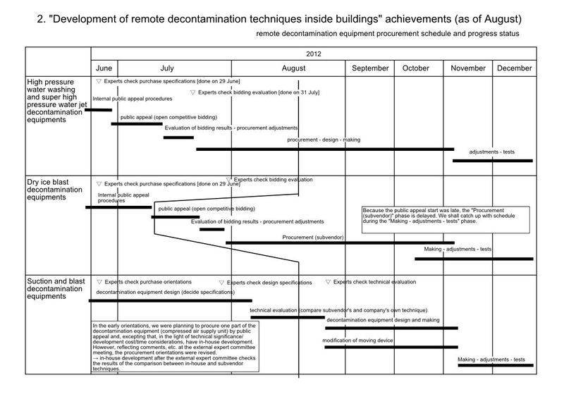

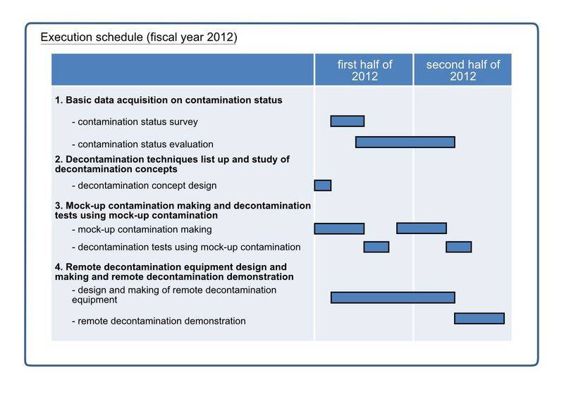

  • #13,674
Document 2

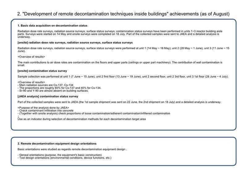

https://www.physicsforums.com/showthread.php?p=4064968&posted=1#post4064968 Translation [installment 1: abstract]
Translation [installment 2: remote decontamination]
03/34 1/4
03/34 2/4
03/34 3/4

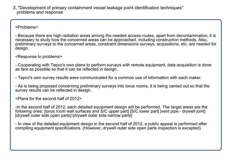

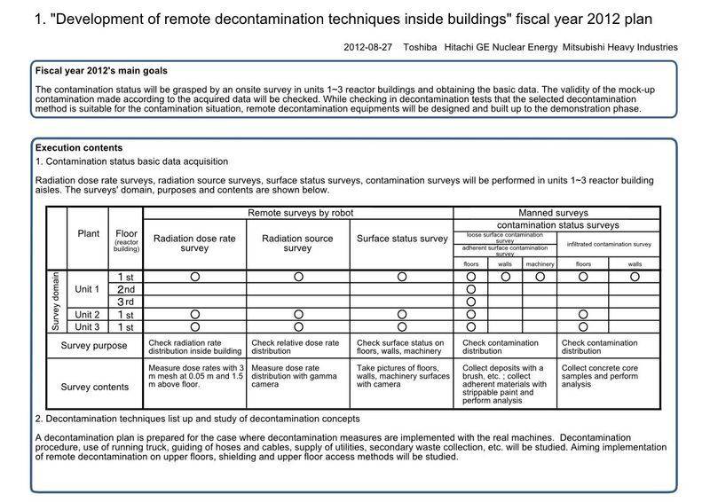

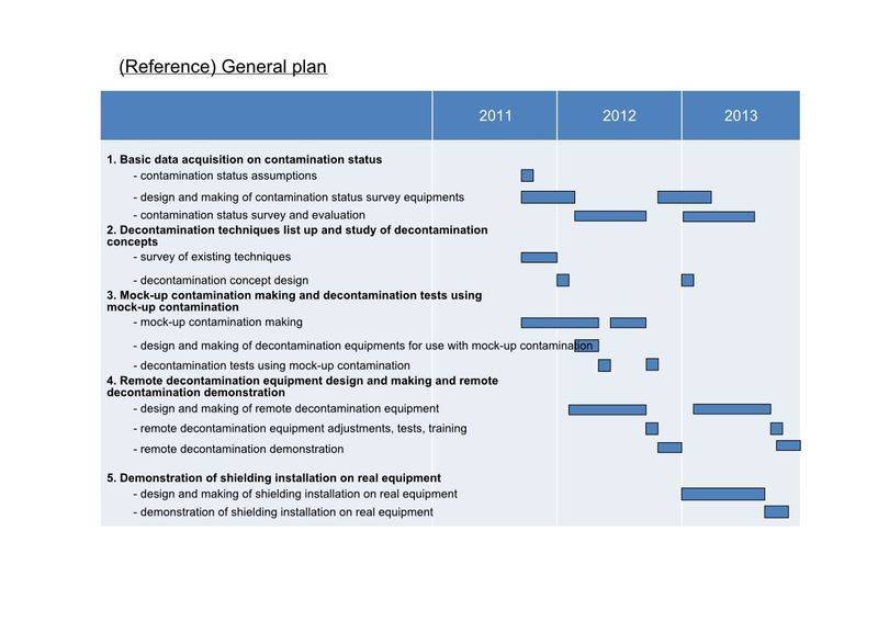

  • #13,675
03/34 4/4
04/34 1/2
04/34 2/2

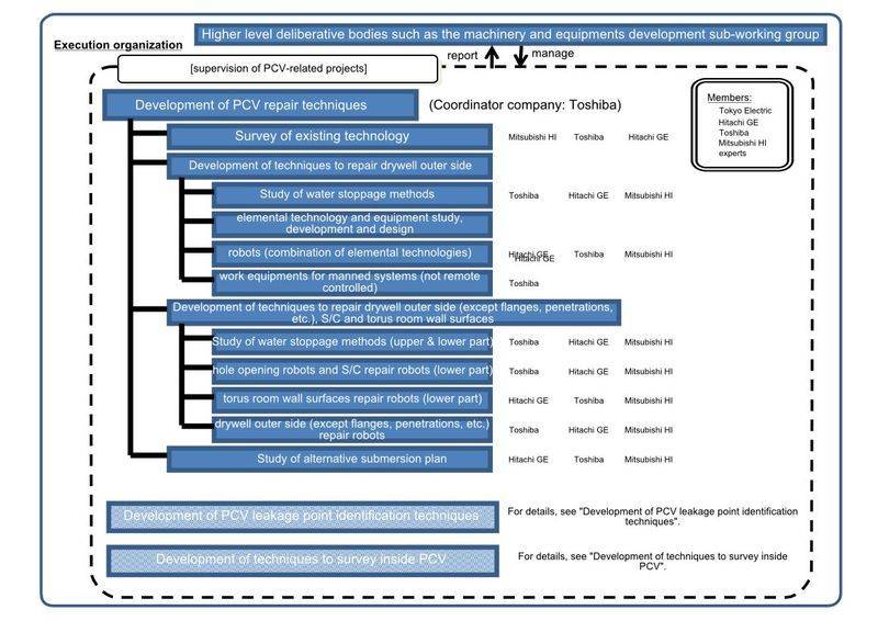

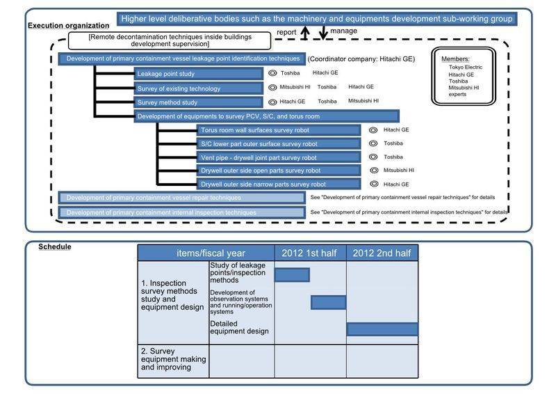

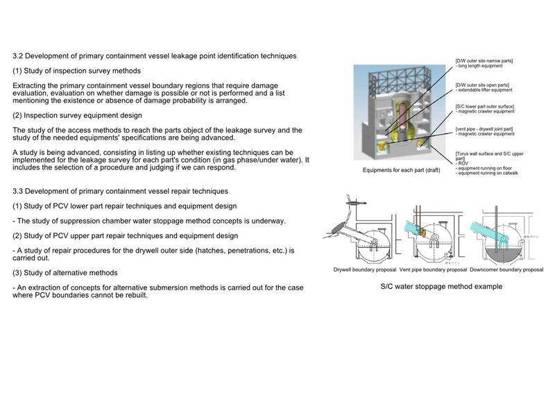

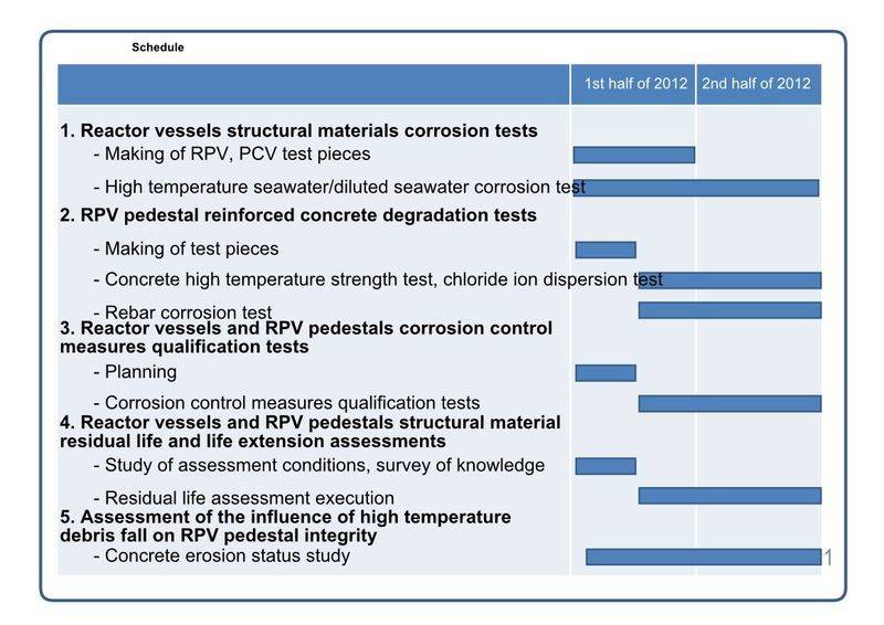

  • #13,676
05/34
06/34
07/34

  • #13,678
tsutsuji said:
]27 August 2012 government-Tokyo Electric mid and long term response committee, technical development progress headquarters (8th meeting) ( http://www.meti.go.jp/earthquake/nuclear/20120827_02.html )
Document 2
https://www.physicsforums.com/showthread.php?p=4064974&posted=1#post4064974 Translation [installment 1: abstract]
https://www.physicsforums.com/showthread.php?p=4068601&posted=1#post4068601 Translation [installment 2: remote decontamination]
Translation [installment 3: PCV leakage points identification]
09/34 1/2
09/34 2/2
10/34

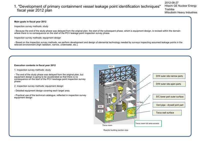

  • #13,679
11/34 1/2
11/34 2/2
12/34

SteveElbows said:
Some (mostly numbers 4 & 11) show that area between reactor 3 & 4 where rather radioactive debris was discovered in a survey
Speaking of which, what building is this, does anyone know? Sorry for asking, I know I should have no trouble identifying it, but my memory is acting up again.
http://photo.tepco.co.jp/library/20120911_31/120911_295.jpg
also, is the large pipe in the bottom-left corner a part of the venting system?
http://photo.tepco.co.jp/library/20120911_31/120911_289.jpg
  • #13,683
Document 2
https://www.physicsforums.com/showthread.php?p=4069889&posted=1#post4069889 Translation [installment 3: PCV leakage points identification]

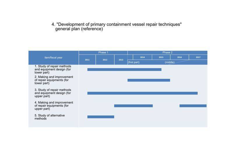

Translation [installment 4: PCV repairs]
13/34 1/3
13/34 2/3
13/34 3/3
  • #13,684
14/34
15/34
16/34

  • #13,695
Unit 2 transformer yard - oil level is a little on the low side
  • #13,696
Document 2
https://www.physicsforums.com/showthread.php?p=4071111&posted=1#post4071111 Translation [installment 4: PCV repairs]
Translation [installment 5: surveys inside PCV]
17/34 1/3
17/34 2/3
17/34 3/3
  • #13,699
Document 2
https://www.physicsforums.com/showthread.php?p=4073726&posted=1#post4073726 Translation [installment 5: surveys inside PCV]

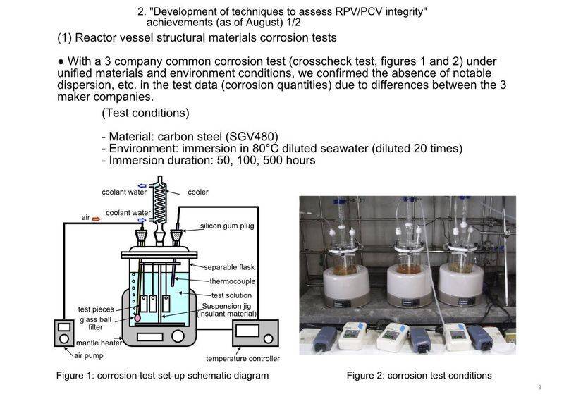

Translation [installment 6: RPV/PCV integrity assessment]
21/34 1/3
21/34 2/3
21/34 3/3
  • #13,700
22/34
23/34
