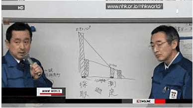

  • #1,520
This is from the Tepco retraction. What are they writing on the blackboard?
Identification of iodine-134 should be unambiguous from the gamma spectrum. Tepco should publish their data.
  • #1,521

  • #1,524
At higher resolution. Is there anything interesting on the whiteboard?

  • #1,528
Tepco press conference now live on uStream - began 4 minutes ago. Japanese no subtitles though.
  • #1,529
Spot On - here is the NHK report
TEPCO retracts radioactivity test result
Tokyo Electric Power Company has retracted its announcement that 10 million times the
normal density of radioactive materials had been detected in water at the Number 2 reactor
of the Fukushima Daiichi nuclear plant.

From Washington Post, today...
Perhaps this http://www.chron.com/disp/story.mpl/ap/top/all/7493328.html" explains it:
Tepco said it miscalculated the radioactivity measurement in the unit 2 turbine building because it mistook the data for iodine-134 for the data of cobalt-56, which has a longer half-life
Does this make more sense Astronuc, AntonL ?
Rhody...
  • #1,542
Does this make more sense Astronuc ?
Rhody...
According to what was said at the press conference (NHK) http://www3.nhk.or.jp/daily/english/27_24.html?play
They were not making a certain claim that iodine-134 was not what was detected, but would take another sample. Note: unless translation was incorrect.
  • #1,543
AntonL said:
extracted from attached report for sea-water analysis - basement water would have have been done very similar. Any clues in this statement regarding their near-site measuring capabilities?
There is a huge difference in activity and dilution of course.
One would bring such dilute samples off site. It should be difficult to measure seawater with the backgrounds at the accident site.
So they had a sample of half a litre and they measured it for 1000 seconds. Probably in a Marinelli beaker with a germanium detector.
On-site they seem to have a car with monitoring instruments. They should have portable spectrometers with them too.

If I understand what you said, if it is cobalt-56, then it needs to be confirmed with a new set of measurements, no ? Another problem here is you are reporting on information from a press conference (real time I assume) whereas the WP article must be older, and as such the information is older as well. When I reported it, google news said it was about 10 minutes old. If that is correct it may have been reported in the press conference, which I did not watch, and am hoping you can confirm or refute. I don't know how long the WP takes to review and post breaking news, but can't imagine it could take too long.
Rhody...

Here is the explanation, basically they extrapolate the measurement back to the time of sampling, and because of short life time of I-134 the value sky-rockets. Apparently they mistook Cobolt-56 but there seems to be confusion about that as well.
[URL said:
http://www.asahi.com/national/update/0327/TKY201103270213.html][/URL]
TEPCO, 27, announced that after 10 million times the radiation detected in normal water reactor turbine building entrapment in Fukushima Daiichi Unit 2 nuclear power plant, and at night, "mistaken for a different matter, " an interview with , re-corrected the early morning of July 28 further correction. Substantially revised and the number measured in the turbine building where even the 26th. Not share information, office workers exposure to high radiation-related locations (nuked) the accident happened. The lack of communication, has spurred the confusion.
Entrapment when the water is examined in Unit 2, calculated back to the time taken for the radioactivity of a substance called iodine-134 decreased very quickly, better, 1cc were around 2.9 billion becquerels. 1 million times the normal. Once found in large quantities so, could even have occurred in a fission reactor. TEPCO Nuclear Safety Commission will be asked to re-evaluate.
TEPCO and measured again, but should decrease rapidly if the radioactive iodine-134 was not much less. TEPCO 27 night, "could be mistaken for those slower decrease of cobalt 56, " said. However, in the early morning of July 28 meeting was "instead of cesium 134 Cobalt 56" was corrected again. The morning briefing "was detected" two different substances was announced, in fact, had not come out.
Mutou Sakai, vice president is "(the analysis) There was not enough in the process of examining the contents, " he said.
TEPCO spokesman said, "despite the possibility that measurement uncertainty, and make public, was hidden after [and] criticism, " to worry about. Nuclear and Industrial Safety Agency, METI also have to give priority to public for the same reason.
  • #1,547

  • #1,549
That is no good reason. Just take a spectrum of the sample every half hour. It will show what the half-life of the peaks are.
