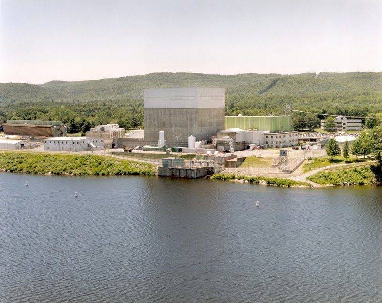

I would say 3 levels above groundfloor. 1 level standing on the west-side, 2 levels fallen to the ground.
Am searching all I can for pictures from inside - that can give the clues.
This picture shows 3 levels of panels, but it looks like it is a different construction (lighter) then #3 :-(
http://img.ibtimes.com/www/data/images/full/2011/03/14/74158-fukushima-daiichi-reactor.jpg
Allthough this image:
http://www.pmw.de/pm_online/data/PCP_deutsche-betonpumpe-fukushima-504x378.jpg
could support the theory that there are only 2 levels above the refueling deck
