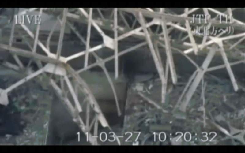

Interesting as the stuff at 55 seconds on this (re uploaded vid) that I thought was fuel rods has come from the north side of the building. And so could be from the 'equipment pool'
Amazing how much more sense the video means after a bit of site analysis (On here over these past few weeks)

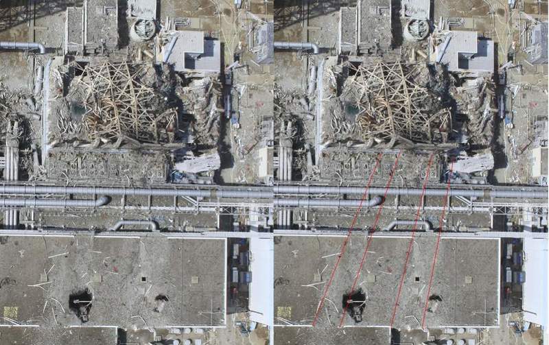

  • #2,046
artax said:
If it's where the hole is to the south of centre in the roof of the building I'm pretty sure it's where the projectile like lump of heavy (concrete) blew upwards in the video and just pierced through the steel girders. this is where some of the steam is emanating.
Hope we can get full res images!

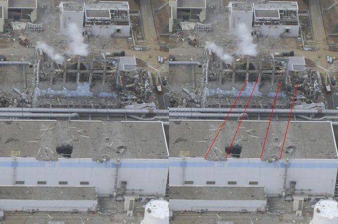

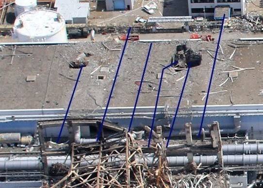

In fact looking at the 2 trails of debris on the roof of the turbine building (one with hole in it) the two lines of debris are almost parallel, suggesting that the explosion came from two sources, or it had two escape routes.
After re-examining... they do converge (Using the white lines at the very edge of turbine building) but to the north side of the building, not where the blurred area is, and the hole.
The biggest thing that was blown up into the sky in the Reactor Three explosion appeared to fall close to the tower (i.e. landside as opposed to oceanside). I think it landed in the middle of one of the small outlier buildings two spots over from the Tower. Whatever that Large Object was, I am willing to bet that it will tell the story of what caused the explosion. that was a heck of a lot of BROWN Dust for a steam explosion.
  • #2,047

  • #2,048
Joe:
I looked very carefully at the earlier frames from the helicopter fly over as well as the satellite images. These are the two largest pieces of debris I could identify that were obviously out of place (arrows). I take them to be pieces of the roof of one of the buildings, perhaps from the large vertical blast at Bldg 3. Who knows?
Image from DigitalGlobe.com with my annotation.
http://i306.photobucket.com/albums/nn270/tcups/LgDebris.png
  • #2,049
Yes, I don't think that was a hydrogen explosion, well it was entirely different to the first explosion...I guessed that thing that went up and stayed partially intact was the missile protection PLUG for the reactor pressure vessel. in semicircles, 8 of them in total. which would suggest explosion inside concrete containment. Anyway yes there was an enormous amount of brown stuff went up, and went up a long way... like three times the height of the chimney stacks.
Haven't analysed exactly where the majority of it landed but would like to see the result in these better images.
