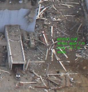

Krikkosnack said:
Fuel Rods of the reactor 4... are really those?
http://www.houseoffoust.com/fukushima/rods.html
The limited resolution of the available photos do not make it feasible to 'find' any individual fuel rods.
Perhaps you mean looking for fuel rod _assemblies_.
If I have it right, assemblies would in a BWR -- complete with cladding -- be rather large square sticks, about 4.5 meters long and about 0.14 meter wide -- and that's within the resolution of at least some of these photos. I am not an expert, but I would expect these assembles sticks to be found with a brownish color (unless oxidized, when I think they might form a whitish oxide crust)
For size comparisons some of the roof material scattered everywhere comes handy.
The roof 'strips' shown here are from unit 4, and are about 7 m long and about 0.7 m wide. Roof strips from unit 1 and 3 are about the same length, but only half as wide. So good hunting.

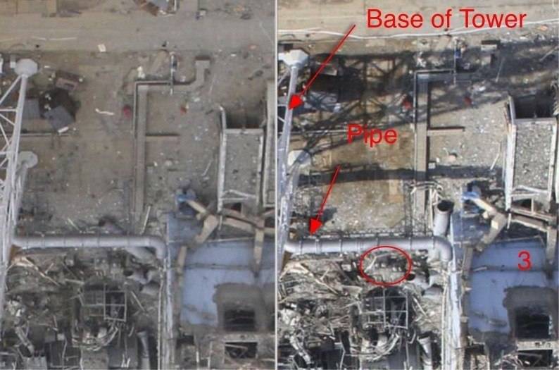

AntonL said:
Lets assume unit 3 pumped unit 4 full of steam and hydrogen...
Hi all,
By the actual status of the release pipes outside the buildings the pipes are broken near unit 3, most likely because of the explosion of unit 3.
But unit 4 exploded later than unit 3. So there was no connection between the two units when unit 4 exploded.
Is it possible that some hydrogen buildup remained in U4 so long from such source? I doubt it.
Otherwise this connection was my favorite idea too.
Scattered fuel rod assemblies out of the spent fuel pool would heat rapidly, probably to temperatures around 200º-300ºC These would be the hottest things on any of the thermal images updated every other day. Instead, the hottest things on thermal imagery are in the 20º-60ºC range, as I recall, and correspond to either the contents of the various SFP's or areas of venting steam, smoke. I think the thermal imagery effectively excludes the possibility of any fuel rod assemblies laying around on the ground.
Also, note that the on going thermal imagery shows persistent heat in the SFPs of Bldg 3 & 4. The only logical explanation of a source for that heat signature at this time is that both SFPs retain all or most of their fuel rods, now immersed in water.
As before, Unit 4 is an enigma. We can probably exclude the possibility of any significant "blow out" of the bottom of the SFP4, given that it seems to be holding water. It is possible that something in the accessory "cask transfer" pool may have exploded, possibly venting to the lower building and to the outside south wall, however. The visible external damage at the level of the SFP4 is to the west of the main SFP.
But even this hypothesis is doubtful as, 1) it doesn't necessarily put hydrogen gas in the lower containment, and 2) only partially matches the external damage to the building.
It is conceivable that the force of the blast and shock wave originating from Bldg 3 may have caused internal structural damage to Bldg 4 not visible on the available exterior views of Bldg 4 immediately following the explosion, but again, this alone would not explain all of the apparent visible damage.
There is insufficient information regarding any other volatile or explosive substances in the lower portions of Bldg 4 (ie, oil for pumps, etc.) to allow any evidence-based speculation on that possible mechanism.
As for some duct or vent connecting the lower floors of Bldg 3 & 4 being the origin of hydrogen in lower Bldg 4, one is still left with 1) how did the hydrogen get to the lower Bldg 4 to vent, and 2) if there were a connection, then why didn't the explosion(s) at 3 also result in near simultaneous explosion at Bldg 4?
This returns as always to the only known initial source for the potential energy released in the explosion of Bldg 4 -- fuel rod assemblies
There are only 3 likely possibilities for the location(s) of fuel rod assemblies in Bldg 4, IMO:
1) SFP4 or,
2) adjacent cask transfer pool, or
3) a transportation cask containing fuel rods somewhere in the path from the access tunnel to the cask transfer pool
An unlikely 4th might be:
4) fuel rod assemblies reloaded into the core.
I am not sure that thermal images support the 4th possibility, however. And they are not as far as I know pumping water into Unit 4 primary containment or RPV.

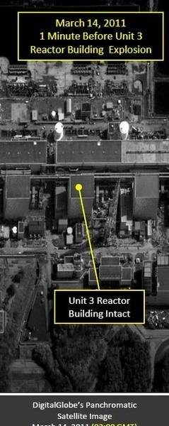

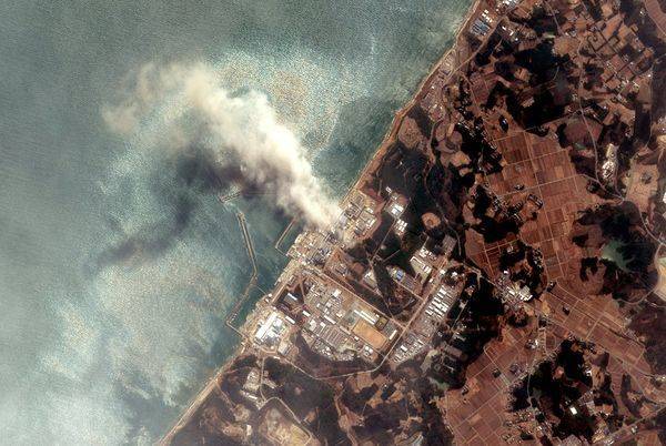

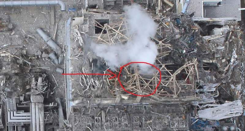

clancy688 said:
Doesn't it look like as if there's white smoke coming from the eastern (sea) side of unit 4?
Indeed it does, and I've thought of that too.
The zoomout (see attachment) precludes that we are just looking at bits of a passing cloud. Then comes the illusion that the 'secondary' smoke fan could originate from further away, to the northwest there seemingly coming out of the forest on the hillside, but that _is_ just an illusion, the smoke-like tint there is not smoke, it is grey stuff on the ground thrown there by the explosion a few minutes earlier.
So, it certainly looks as if there is smoke coming from unit 4. I'll offer an alternative explanation in that the steam explosion at unit 3 threw out several large and steaming, hot objects. One of them may have landed in the yard between unit 3 and 4, and the smoke still coming from that could be what gives an illusion of smoke coming from unit 4.

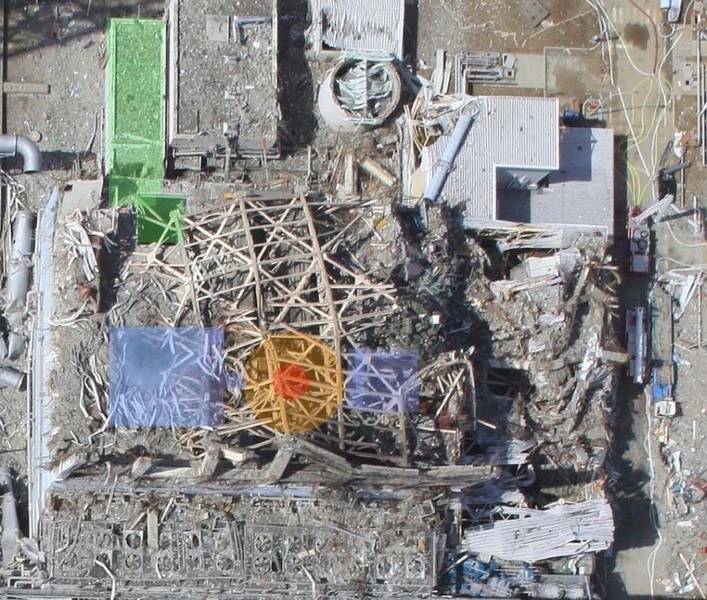

Astronuc said:
WNN - Most fuel in Fukushima 4 pool undamaged
http://www.world-nuclear-news.org/RS-Most_fuel_in_Fukushima_4_pool_undamaged-1404117.html
14 April 2011
Which, perhaps surprisingly, is consistent with the imagery, IMO.
BTW, the detailed technical drawing of the reactor building referenced just above doesn't fit the images of Unit's 3, 4. The Elevator is in the wrong location (west side, north end of the structure instead of the west side, south end of the structure.
I just love to color by number. The green overlay is the elevator shaft and access tunnel for the fuel casks. Shouldn't it be adjacent to the SFP, not the equipment pool?
Am I missing something -- is there another elevator shown and the shaft for the fuel cask transfer is not shown?
Ah Ha! Yes, The elevator shown is not the fuel cask shaft. My mistake. Hmmmmm. . .

yep elevator is human service, as you can see remains on the roof tops of unit 1.
I'm not convince the location is the same (N/W) for unit 4, I think I could be S/W.
Also I'm not convince that there is a temporary cast pool, sofar I'm voting for cast operation handled in the main SFP.
I believe the is an un accounted for crane structure above the utility pool adjacent to the reactor "opening" on unit 4
what is the truck size whit object at the bottom south of the west wall..
there is a fair amount of roof structure debrit on the south part of unit 4 where do they come from, the south part of the roof does not seems missing that many parts.

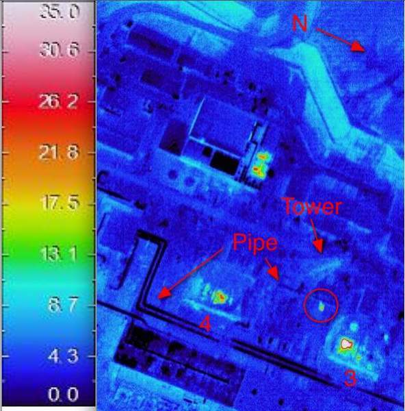

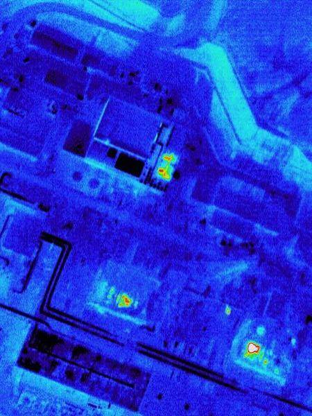

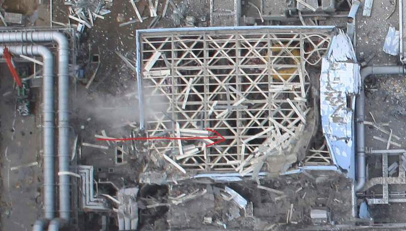

TCups said:
<..> I think the thermal imagery effectively excludes the possibility of any fuel rod assemblies laying around on the ground.
The pixel-resolution of the thermal imagery I've seen spares about 0.2 m/pixel on the ground. With dispersion and such the real resolution must be worse, I'd reckon no better than 0.4 m/pixel and I think I am being generous.
Anyhow, what is that thing we see glowing -- all alone by itself :-) -- between unit 3 and 4, on the imagery from March 25th (attached thermal image and scale)?
|Fred -
I believe it is probably some sort of insulation material. I also seem to recall a major HVAC ductwork structure overhead at the SFP end of the service floor on one of the priors.
Something just doesn't add up. If the fuel in SFP4 was only partially uncovered and most was not damaged, it just doesn't seem to match the degree of destruction seen in Bldg 4.
Here is another HVAC SWAG to think about . . .
Rather than the blast at Bldg 3 pushing anything through the connecting ductwork back into Unit 4, is it possible (perhaps even likely) that the blast at Bldg 3 would send significant pressure pulse of hot gas into the vent system, then up and out the vertical stack, in addition, of course, to the rest of the blast damage? That being the case, then, could a Venturi effect from the vertical stack shared by Units 3, 4 have created a sudden, transient negative pressure in the lower portions of Bldg 4 through the connecting vent system?
If so, then the a large volume of air is sucked out of the lower floors of Bldg 4, and a large volume of hydrogen gas that had accumulated above might be sucked downward into the building -- like smoke being pulled back into the bowl from one big puff off a giant briar pipe.

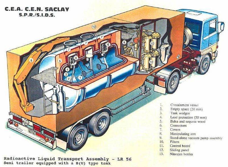

Storage tanks, pumps and monitoring equipment from Savannah River Site will be shipped from South Carolina to Japan to help in the battle to stabilize the damaged nuclear reactors at Fukushima.
Special
R-56 diagram: A high-tech, self-contained piece of equipment known as a “Radioactive Liquid Transport Assembly,” or LR-56, is being sent to Japan to help government officials who are monitoring contamination levels in the vicinity of the Fukushima nuclear power plant.
"This is what we can send them at this point to support their activities," said Jim Giusti, a U.S. Energy Department spokesman.
Equipment is also being gathered from other federal nuclear sites around the county, he said. Its transfer is being expedited as a "government to government diplomatic exchange" that will convey the gear directly to the Japanese government.
The primary items from SRS, identified by its management contractor, Savannah River Nuclear Solutions, include a "radioactive liquid transport assembly," a high-tech, self-contained, trailer housing a 1,000 gallon tank, pumps and a monitoring system. http://chronicle.augusta.com/latest-news/2011-04-14/srs-equipment-headed-japan?v=1302791614
I also see a big green machine at the north end, over the utility pool.
I have no idea what the truck size object is. From looking at imagery from before the explosion I get the impression that it was there then, too. (see attached)
As to the debris at the south side, I believe it is a fair amount of the roof covering, on top of the concrete pillars and panels from the holes in the wall above (certainly mixed with assorted foobar, but quantitatively a small proportion)

Giordano said:
Concrete truck?
No, the resolution is actually pretty good, but there is "blooming" of the heat signatures. The hot object is probably about 25ºC and looks to be about where debris have been cleared and a new "plate" of some sort is now on the ground, near the center of this photo.
In the thermal imagery, you can see the pipe, the tower, and actually, a fair amount of ground detail in the blue scale.

Giordano said:
Concrete truck?
I don't think so. The thermal image with this clear hotspot in the yard between unit 3 and 4 was taken somewhere between 6.34 am and 07.19 am on March 25th. It was a cold morning, as you can well see from the image, only about 2 deg. C. The location is right under some huge pipes, not exactly where one would think to place a concrete truck. Anyhow, Tepco states clearly that the concrete pump was not used at that time for doing anything to unit 3.
'Today's work for cooling the spent fuel pools
- At approximately 5:35 am, we started injecting seawater into the fuel
spent pool of Unit 3, using Fuel Pool Cooling and Filtering(clean up)
system (FPC) and finished at 4:05 pm.
- At around 2:35 pm, spraying to unit 4 by concrete pump track and
finished at around 5:30 pm.
- We are considering further spraying at other units and others subject
to the conditions of spent fuel pools.' (Tepco press release on the morning of March 25th)

Giordano said:
Concrete truck?
Something big, hot - and mobile, that's for sure. The other thermal images shows no hotspots at the same point.
But: there are earlier aerial photos (I could not find the date, but here is a link: http://cryptome.org/eyeball/daiichi-npp/pict6.jpg), showing a broken pipe of the venting system and some debris near the hotspot: and on later images the same pipe is near the reactor building and the area is clean from debris.
So: I think the thermal image shows the truck which cleaned up the area.
? Are we talking about the same thermal image?
https://www.physicsforums.com/attachment.php?attachmentid=34365&d=1302808699
If so, then I don't see anything even near the size of a concrete truck between Bldg 3 and 4.
  • #3,735
Are you referring to this thermal image attached to the original post asking about the object between Bldg 3 and 4?
If so, something is way off. Nothing remotely resembling a truck is in this thermal image.

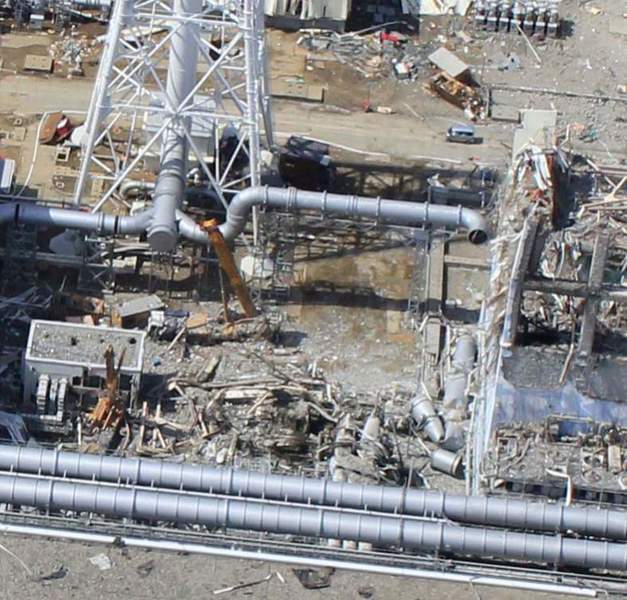

Giordano said:
Concrete truck?
I do believe the area had been cleared for passage already by March 24th. See 'before and after 'cleanup'' attached. The position of the hotspot is at the far foot of the exhaust tower.
On later thermal images, it appears that the pool has been regularly douched from a firetruck about at the time of thermography, and the truck blocks the view to the hotspot.
OK, understand, but - - -
The thermal image originally posted was this one. I have recombined the window/level scale and annotated what I see as Bldg 4, Bldg 3, Tower, and Pipe (darker = colder = water in pipe?). The pipe just to the east of the tower is near ambient temp (empty). The only hot spot between Bldg 3 and Bldg 4 (circled) is relatively small, east of the pipe next to the tower, and only somewhere near 25ºC. If the thermal image pre-dates the "cleaned up" image, then the hot spot is about where a large square of metal plate or plywood has been laid. I see nothing on the thermal image even vaguely resembling a truck, blocking activity or otherwise.
I have rotated your before/after clean up image to match the orientation of the thermal image, though the angle is different, and I have indicated the approximate location of the small hot spot between Bldg 3 and 4.

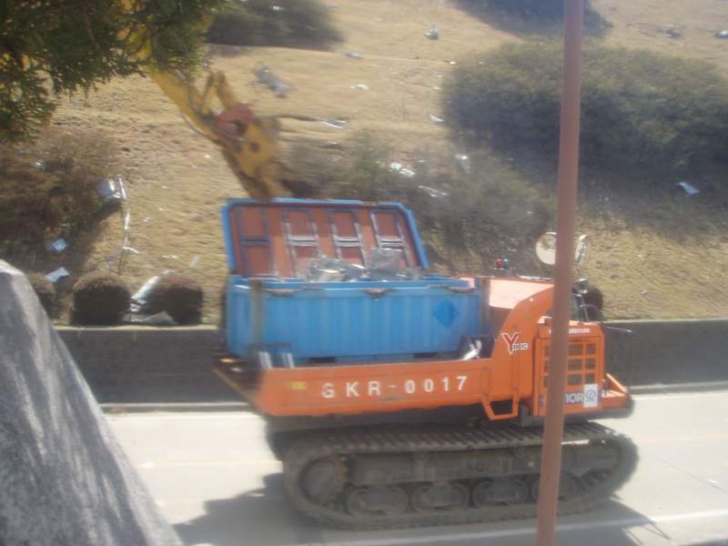

They have been using remote controlled excavators to clear away debris . There burying some of the hotter stuff and putting a lot of debris in small containers taking it to a temporary storage point just to the west side of the reactor buildings near a storage shed . (approx. 2.5mSv/h around containers) that have been filled .
