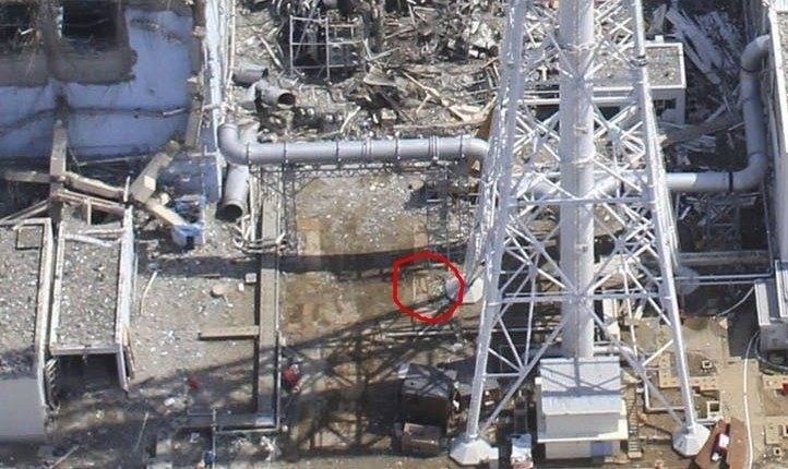

  • #3,752
TCups said:
The thermal image originally posted was this one. I have recombined the window/level scale and annotated what I see as Bldg 4, Bldg 3, Tower, and Pipe (darker = colder = water in pipe?). The pipe just to the east of the tower is near ambient temp (empty). The only hot spot between Bldg 3 and Bldg 4 (circled) is relatively small, east of the pipe next to the tower, and only somewhere near 25ºC.
Agreed except the position of the hot spot, where I think the perspective may be cheating you. The thermal camera is looking down from the east at the hotspot, in a line that goes towards the foot of the tower, but under the pipe.
If the thermal image pre-dates the "cleaned up" image <..>
It doesn't, I should have made the date-marking clearer. The 'before cleanup' image is from March the 20th, the 'after' from the 24th, and the thermal image with the hotspot is from the 25th.
I see nothing on the thermal image even vaguely resembling a truck, blocking activity or otherwise.
Neither do I -- I see just about what I would expect if there were a fuel rod there. :-) Someone else said that it probably was just heat from the cleanup truck, and that would explain why we see no hotspot on the later images.
However, what I said is, the later thermal images indicates that a firetruck has taken station under the pipe, obscuring the view to the position of the hotspot. This _too_ would explain why we don't see it on the later images...
(A third explanation could be, someone removed it, but that's too simple :-)).
I have attached a photo making clear where I think the hotspot is.

Something big, hot - and mobile, that's for sure. The other thermal images shows no hotspots at the same point.
But: there are earlier aerial photos (I could not find the date, but here is a link: http://cryptome.org/eyeball/daiichi-npp/pict6.jpg), showing a broken pipe of the venting system and some debris near the hotspot: and on later images the same pipe is near the reactor building and the area is clean from debris.
So: I think the thermal image shows the truck which cleaned up the area.
Or bulldozer. Remember they had to bulldoze over fuel elements (debris?) between units 3 & 4 to allow firetrucks access. I suspect they briefly set up one of those concrete pump type things near that site to top up SFP 3. The heat in that pool is so low that it would only need topping up occasionally.
