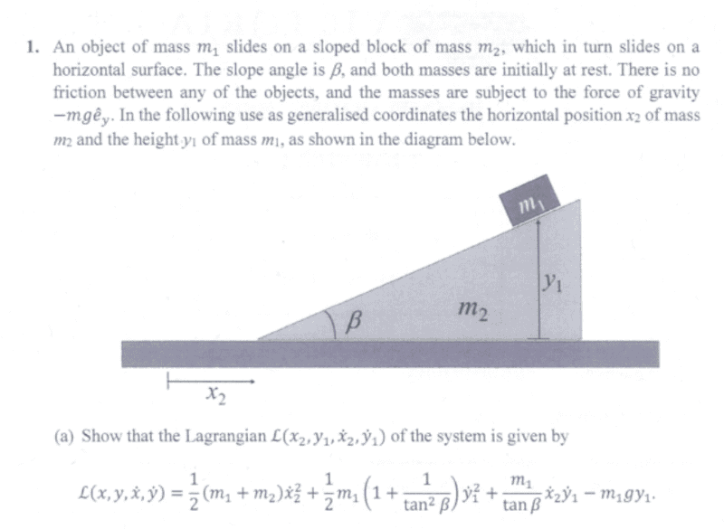

Please see below
##F = mg##
For this problem,
I am confused where they get these two terms from
Can someone please explain? I get all the other terms expect those.
Thanks alot!
ChiralSuperfields said:
Homework Statement: Please see below
Relevant Equations: ##F = mg##
For this problem,
Thanks alot!
Note that three of the four KE terms involving ##m_1## have factors that naturally combine to form a perfect square.

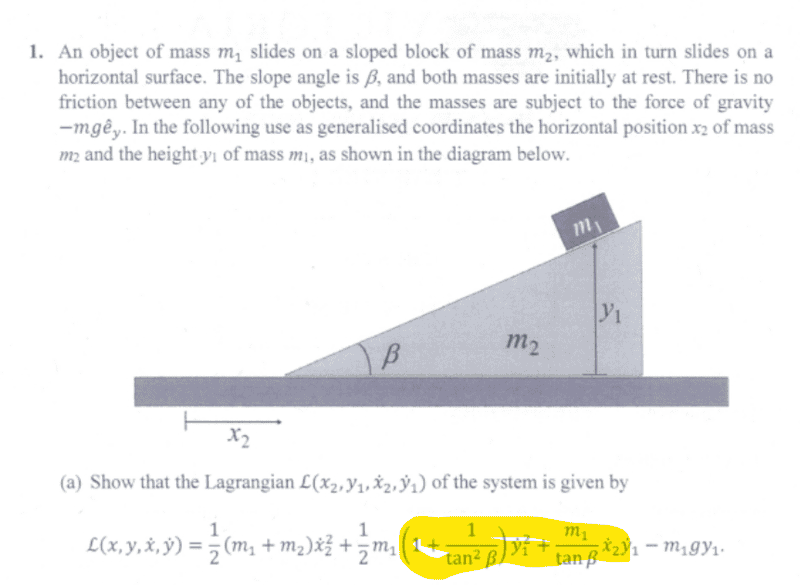

Thanks for your reply @haruspex!
Sorry what do you mean? Are you suggesting I rewrite the the highlighted bit in terms of cotangent?
Thanks!
Also note that generalized coordinates ##x_2## and ##y_1## are, respectively, the horizontal position of the wedge and the vertical position of the block. How do you think you can get the horizontal position of the block ##x_1(t)## if you have successfully solved the equations of motion to get ##x_2(t)## and ##y_1(t)##?
In other words, how have you handled the constraint that the block maintain contact with the wedge which accelerates to the right while the block accelerates down the incline? It would be easier for us to explain where you went wrong if you show us your work. We are not very good at guessing.

No, ignore your highlighting.
There are four ##m_1## terms contributing to the KE. Which three of them can be combined into an expression of the form ##\frac 12m_1(…)^2##?

Sorry, I am not sure how there are three m1 terms for KE that can be combined into a expression of the form 12m1(…)2. I only get two, which are 12m1([dx2dt]2+[dy1dtsin⁡β]2) since the m1 moves at the same speed as the block which moves at dx2dt and [dy1dtsin⁡β]2 from block moving down the incline.
Please write out your full derivation as suggested by @kuruman earlier. In particular, can you write the horizontal position ##x_1## as a function of ##x_2## and ##y_1##?
I only get two
##\frac 12m_1\dot x_2^2##, ##\frac 12m_1\dot y_1^2##, ##\frac 12m_1\frac 1{\tan^2(\beta)}\dot y_1^2##, ##m_1\frac 1{\tan(\beta)}\dot y_1\dot x_2##.
Sorry do you please know how you got the later three terms?
Thanks!
Sorry, I should have made it clear that I am working backwards from the expression you are supposed to arrive at. (You had not posted your own equation, so that is all I could have been referring to.)
It may become clear then how to get that answer.
