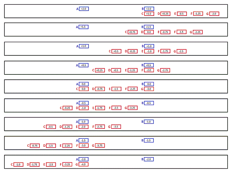

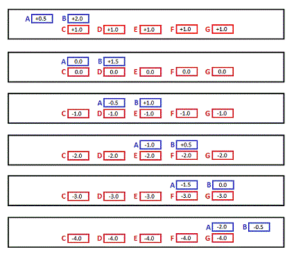

The attached drawings are based on a similar idea and illustrate time dilation and the relativity of simultaneity.
In the first drawing below (Blue Frame), the blue clocks are stationary and the red clocks are moving at v = sqrt(3/4) = 0.866c which was specially chosen because the time dilation factor works out as 2 which makes the numbers easier to handle. To read the drawing the initial situation is the lowest black rectangle, and subsequent rectangles working upwards illustrate how the situation unfolds with time. Each rectangle can be thought of as time slice in a given reference frame, or a frame in video recording.
In the next drawing (Red frame), the red clocks are stationary and the blue clocks are moving at 0.866c to the left.
When two clocks pass each other and are right alongside each other then this can called an event. Events are universal and different observers will agree on what the passing clocks show at a given event. For example call the event the B clock passing the F clock event BF. It can be seen that in either reference frame, that at event BF the blue B clock read +0.5 seconds and the red F clock read -2.0 seconds.
Consider the events AC and BC in the blue frame. It can be seen that 1 second elapses on the red C clock and this is a proper time measurement as it measured by a single clock present at both events. The coordinate time interval according to the blue reference frame is the time on the blue B clock minus the time on the blue A clock so the coordinate interval is 2 seconds and the blue observer considers the red C clock to be running slow because only 1 second elapses on the red clock. The Blue observer considers it valid to use two clocks because as far as they are concerned the clocks are synchronised.
Now consider events BG and BC in the second drawing (Red RF). 2 seconds elapse on the blue B clock. The red frame observer measures the interval between those two events as the time indicated on the red C clock (+1.0 seconds) minus the time indicated on the red G clock (-3.0 seconds) to give an elapsed coordinate time of 1-(-3) = 4 seconds. As far as the red observer is concerned 4 seconds has passed on his clocks when 2 seconds elapsed on the moving blue clock so the red observer considers the blue clock to be running slow. The red observer considers it equally valid to use two different clocks to measure the interval between the two events because they equally consider their clocks to be synchronised.
It can be easily seen in the diagrams that what one observer considers to be synchronised is not synchronised as far as another observer with relative velocity is concerned. It can be seen that all observers agree on the proper time interval between two events, recorded by a single clock that is present at both events. If the time interval between two events is made by two spatially separated but synchronised clocks, where neither clock is present at both events, then this is a coordinate measurement and is observer dependent.
I hope the diagrams are useful to anyone trying to understand time dilation and the relativity of simultaneity.
In the first drawing below (Blue Frame), the blue clocks are stationary .
I don't think your diagram is correct because you are assuming that two events at distance have the same time coordinate in the frame at rest, which is not correct.
SR definition of simultaneity of events at distance on a rest frame clearly states that the time coordinate at B must be equal to tA + (xB-xA)/c, being tA the time coordinate at A, xB and xA the space coordinates of B and A, respectively. In plain English: the time at B must be the time at A plus the time needed for light to travel from A to B.
There is no sense of claiming time to be absolute in the rest frame; otherwise it should also be absolute in all inertial frames.

This is not correct. When synchronising the clocks a signal is sent from A at time tA. When B receives this signal he sets his clock to tA + (xB-xA)/c but in the meantime clock A's time has not stood still, but has advanced by (xB-xA)/c so that when B sets his clock to tA + (xB-xA)/c, clock A is also reading tA + (xB-xA)/c and both clocks are synchronised according to that frame. Other observers moving relative the frame in which clocks A and B are rest will not agree they are synchronised and will say they differ by a factor of (xB-xA)*v/c^2 with the trailing clocks showing more elapsed time than the trailing clocks.

They are both "number of units". Suppose we have little lights on both the front and back end of an object which is moving relative to the K frame, and both lights flash simultaneously in the K frame. In this case, the distance between the positions of each flash qualifies as the "length" of the object in the K frame (since 'length' is always the distance between the positions of the front and back of an object at a single moment), so you're counting the number of distance-units between the flashes using a ruler at rest in the K frame and calling that the length x of the moving object in the K frame. Meanwhile the object is at rest in the k' frame, so although the flashes at either end of the object happen at different times in this frame (relativity of simultaneity), the distance between them in the k' frame is exactly the same as the distance you'd get if you set off two flashes on either end of the object which were simultaneous in the k' frame. Either way, you're counting the number of distance-units between the flashes using a ruler at rest in the k' frame and calling that the length x' of the object in the k' frame. Then you will find that x = x'/γ, so you can see that the length contraction equation is still talking about the "number of units" between a pair of events (the two flashes) as measured in each frame.
But are you not then assuming that the length unit is the same in both frames even though one is length contracted?
Consider too the moving clock, and imagine a clock with a display showing the time. It cannot show a different time when it is moving can it - it is still the same clock face displaying the same time wherever it is seen from, whoever it is observed by.
Surely the difference in the time displayed is the length of the time units the ratio of t/t' is the ratio of the lengths of the time units.
A clock cannot tell different times to different observers, yet it may display different durations.
In the same way a ruler alongside an object will always shew the same length wherever it is observed from, it is the size of the units that will change not the number of them.
  • #295
What do you mean "the same in both frames"? They are both using markings on their own rulers to measure the distance between the two events, and each one would say that the markings on the other guy's ruler are shrunk down to a smaller distance apart than the markings on their own ruler. Of course their rulers are identically constructed so each one looks the same in its own rest frame, but the same is true of the clocks they use to measure the time between two events.
