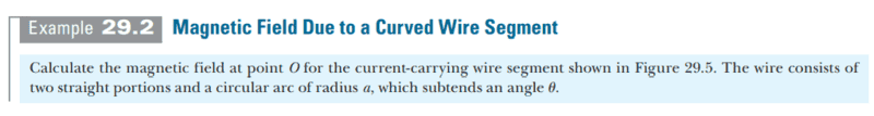

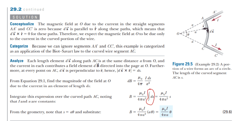

However, why did they not use limits of integration for the integral in red? When I solved this, I used
as limits of integration.
I see that is not necessary since you get the same answer either way, but is there a deeper reason?
Many thanks!
The text says "integrate over the curved path AC", so it was not essential to write that in the algebra. Also, one does not always have to specify the integration domain as a pair of endpoints. They could have defined S as the curve AC and written ##\int_S##.
Likes MatinSAR and member 731016
Thanks for your help @haruspex ! That second notation you mention makes more sense than their single integral over ds. I think another way to avoid implicitly defining an integration domain is by using a line integral
to denote that we are summing the length elements over the path, correct?

Callumnc1 said:
Thanks for your help @haruspex ! That second notation you mention makes more sense than their single integral over ds. I think another way to avoid implicitly defining an integration domain is by using a line integral View attachment 320352to denote that we are summing the length elements over the path, correct?
No, that symbol is for integrating around a closed loop.
