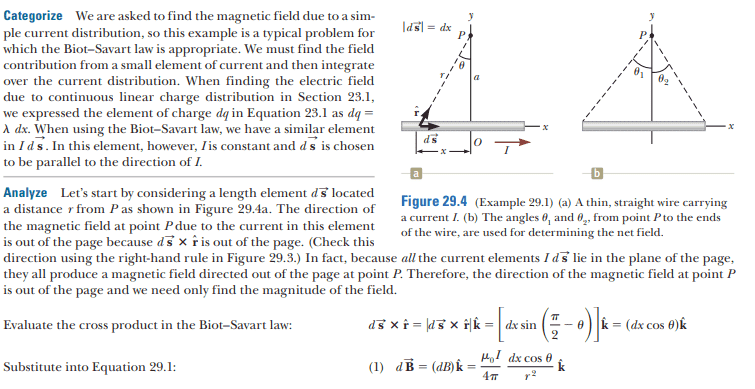

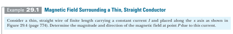

For this problem,
Part of the solution is,

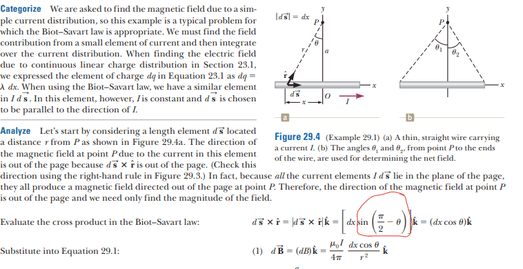

However, would someone please tell me where they got the sine function circled in red from?
Many thanks!
You're working with the cross product ##\vec{ds} \times \hat r##. How is the angle between ##\vec{ds}## and ##\hat r## related to the angle ##\theta## shown in diagram ##a##?
Likes member 731016
Thank you @TSny ! I see how they got theta now. :) If we call the angle between ds and r hat as theta 2, then from the definition of the cross product:
dxsin(theta 2) = dxsin(pi/2 - theta) where I found theta 2 using angles in a triangle add up to 180 degrees.
