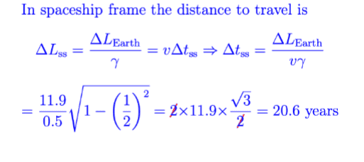

For this problem,
The solution for (a) is
And (b) is,

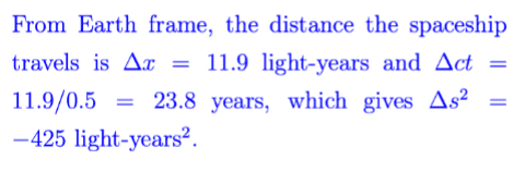

However, I'm confused by this calculation for (b). I get ##\Delta x = 11.9~c~years## and ##\Delta ct = \frac{c\Delta x}{v} = \frac{11.9 c^2 years}{0.5 c} = \frac{11.9~c~years}{0.5}##
Does someone please know why they are missing the speed of light factor?
Thanks!

##c\Delta x## is multiplying by c a second time. What units would that give?
Thank you for your reply @haruspex!
Sorry I'm confused. The units for ##c\Delta x## should be m^2/s
Thanks!
The solution for (b) has the wrong units. ##\Delta ct## has units of length, not time (if one insists on using such unnatural units where ##c\neq 1##)
Since c = 1 ly/year, 1 c year = 1 ly.

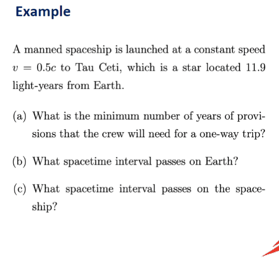

I will also add that (a) is not a very well formulated problem. “What spacetime interval passes on Earth?” Between what events?!?!?
  • Love
Likes jbriggs444, haruspex and member 731016
Plus, it's a trick question. If the spaceship is launched at v = 0.5c, the crew will not be needing any food on the journey... :wink:
