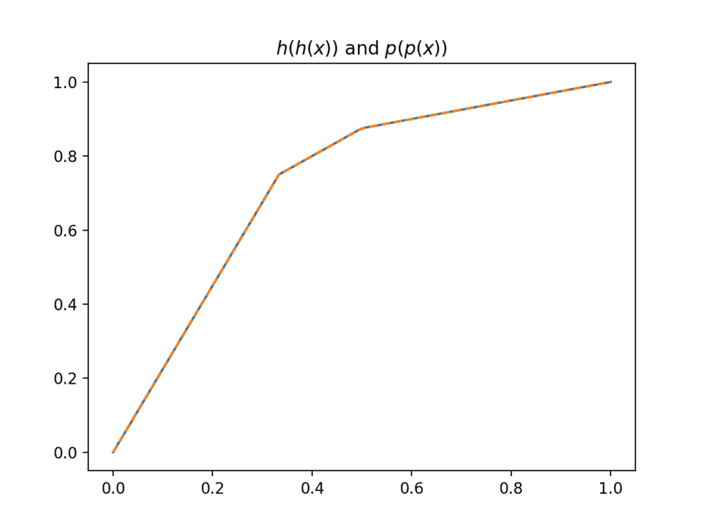

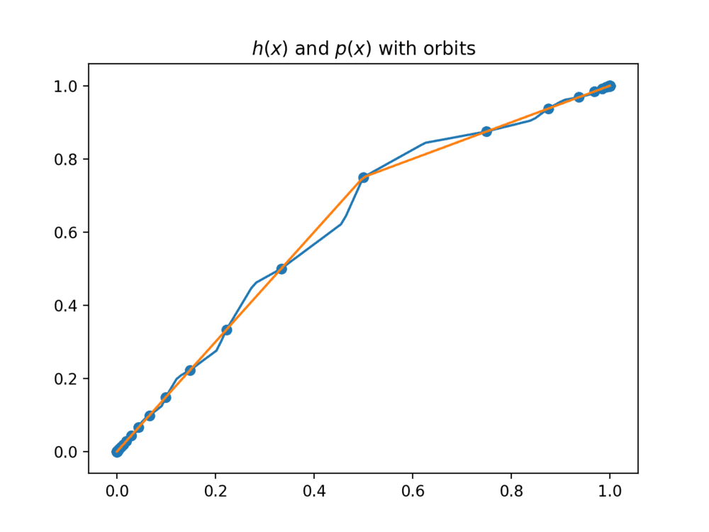

$$\text{(i) Existence of (e.g. square) roots: if }g\in G,\text{ then }\exists! \sqrt{g} \text{ s.t. }\sqrt{g}\circ\sqrt{g}=g.$$
$$\text{(ii) Existence of flows: if }g\in G,\exists! \{g_\lambda\}_{\lambda\in \mathbb{R}^+}:\,g_1= g,\,g_0=\mathbb{I},\text{ and }g_a\circ g_b = g_{a+b}$$
$$\text{(iii) Convexity: if }g_1,\,g_2\in G\text{ and both }g_1\,g_2\text{ are convex, then so is }g_1\circ g_2.$$
$$\text{(iv) Noncommutativity: e.g. let }g_1(x)=x^2,\,g_2(x)=\frac{2}{\pi}\arcsin(x)$$
$$\text{(v) Piecewise linear approximation: if }g\in G,\,\epsilon> 0,\,\exists g_{\epsilon}(x)\text{ piecewise linear, such that }\|g\circ g'-g_\epsilon\circ g'\|<\epsilon\,\forall g'\in G.$$
$$\text{(vi) Same as (v) for powers of }g\in G\text{ up to some }n\in\mathbb N$$
$$\text{(vii) Interleaving properties of cusp singularities in piecewise linear functions under composition.}$$
$$\text{(viii) Approximating arbitrary p.w. linear functions with those generated from a countable subset.}$$
$$\text{(ix) Same as (viii) for finite subsets (of piecewise linear functions.)}$$
$$\text{(x) Criteria for commutativity: }g_1\text{ and }g_2\in G \text{ commute iff they belong to the same one-parameter flow, }g_\lambda,\,\lambda\in\mathbb R^+.(?)$$
