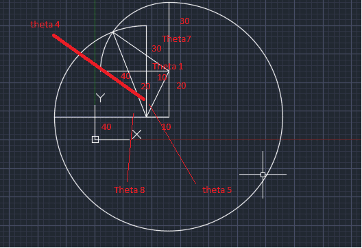

Donkey's challenge
I have got a solution of 7539.8822 Using some approximations. The real value is a bit 20ish meter less than that
Only exact solutions count, no approximations!
Okay, I figured out the whole solution and solved my approximation problem.
First let's see the picture below, This is how I interpreted it.
Okay so as we see here we have 3 section.
1) The big circle :p
2) the 2 small circles
3) Intersection
What you need to find out is that intersection (there is an approximation way 20m less than what expected) but we will find it with a another way without leaving a bit.
so first we have to find theta 1 and theta 4
Using this formula
## C^2 = A^2 + B^2 + 2 A B cos \theta ##
The numbers denote the length of each side of the triangle.
To find theta 1 you have to subtract the angle of the triangle of the barn from the acquired angle from the previous equation
You will find that theta 1 is equal to 35.138
Same thing applies to theta 4 and it is equal to 21.304
Now You could get theta 7 and theta 8 by subtracting theta 1 and theta 4 from 90
So as you have the angle use it to find the area that theta 7 and theta 8 are facing.
## \frac{\theta_7}{360} \pi 30^2 ##
## \frac{\theta_8}{360} \pi 40^2 ##
So what we are missing is the area of the big triangle - the triangle in the barn
You can get the area using this formula
#p# is half of the circumference
##area = \sqrt{p(p-a)(p-b)(p-c)} ~ - ( 0.5 * 10 * 20 )##
By adding these areas together you have found the area of the intersection and the two circles( 1/4 of the shape)
for the other 3/4 it is easy, you just have to find the area of ## \frac{3}{4} \pi 50^2 ##
Sum all that and you have that the damn donkey will eat ## 7512.210951 m^2 ## worth of grass.
