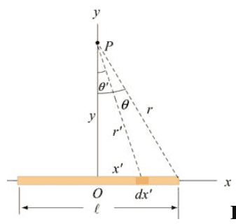

I was asked to calculate the electric field at a point ##P##, located a distance ##y## from the center of a rod along its perpendicular bisector (see image below).

The technique here would be to express your equation in terms of the dimensionless quantities ##l/y## or ##y/l##. In each case, ##l >> y## or ##y >> l## imply that ##y/l## or ##l/y## are approximately zero.
$$E_p = \frac{k_eQ}{y\sqrt{y^2+\frac{l^2}{4}}}$$
$$=\frac{k_eQ}{y\sqrt{y^2(1+\frac{l^2}{4y^2})}}$$
$$=\frac{k_eQ}{y^2\sqrt{1+\frac{l^2}{4y^2}}}$$

Perhaps that's loose language. You could say "in the limit as ##\frac l y \rightarrow 0##", which is what ##y >> l## means. In any case, I don't see it as something to get confused about.

You should be able to go straight from there to $$=\frac{k_eQ}{y^2} \ \ (y >> l)$$

Indeed it is the limit as ##\frac{l}{y}##. Out of curiosity are you able to show how to do the Taylor expansion of the denominator ##(1+\frac{l}{y})^{1/2}##? This is the first time I am trying to use Taylor Expansion outside of calculus, having a hard time doing it for this, and it is indeed a technique I've seen used with such fractions to investigate such scenarios as ##y>>l##.
That's a particular case called the binomial theorem (for fractional powers):
https://brilliant.org/wiki/fractional-binomial-theorem/
In this case, we have ##x = \frac l y##.
That said, you only need an expansion when you want to keep at least first order terms in ##\frac l y##. We have:
$$ (1+\frac{l}{y})^{1/2} = 1 + \frac 1 2 (\frac l y) + \frac{\frac 1 2 (-\frac 1 2)}{2!}(\frac l y)^2 \dots \approx 1 + \frac 1 2 (\frac l y) - \frac 1 8 (\frac l y)^2$$
That's called the expansion to second order - i.e. up to an including the term in ##(\frac l y)^2##.
The first order expansion would be
$$ (1+\frac{l}{y})^{1/2} \approx 1 + \frac 1 2 (\frac l y)$$
And, in the limit ##y >> l## we have:
$$ (1+\frac{l}{y})^{1/2} \approx 1$$
