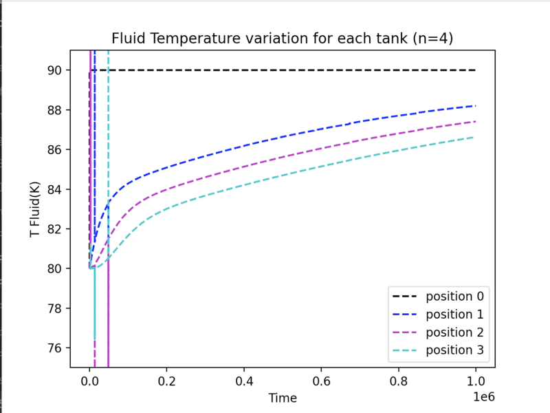

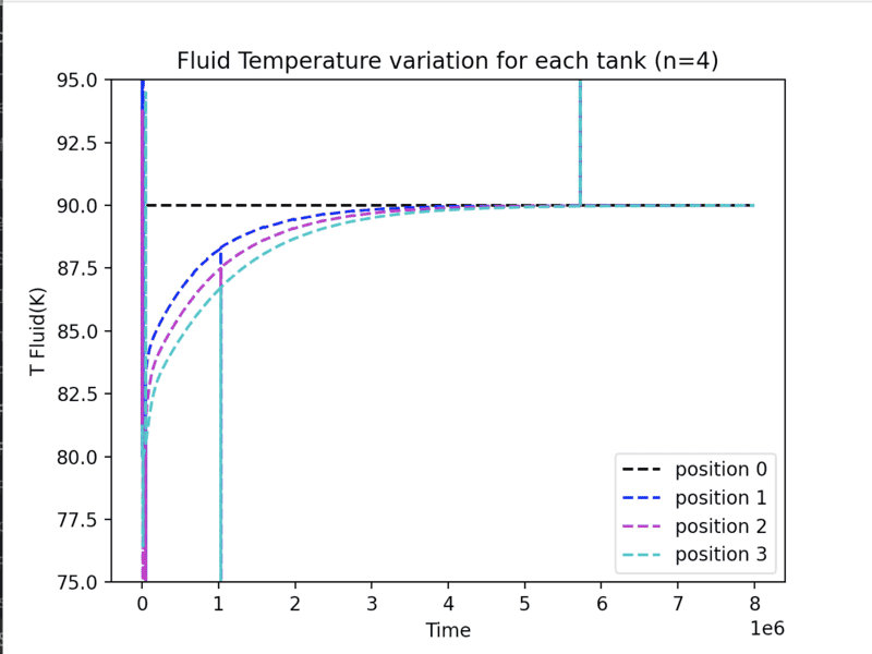

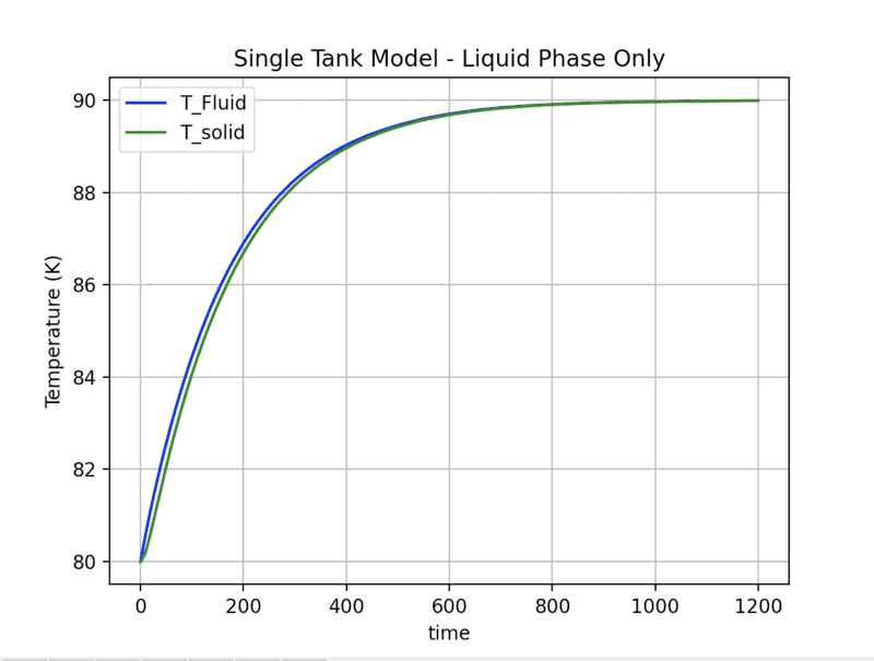

  • #209
Chestermiller said:
We have got to take a step back, and make sure that the single tank model of the entire bed is getting the right answer. This can be checked by running a calculation in which the model can be solved analytically. Such a case would be if the stream entering the tank is a liquid at a temperature below the saturation temperature, and the bed is initially at a colder temperature. Then we can compare the analytic solution to the time-dependent numerical solution to make sure that the time scale we get numerically is correct.

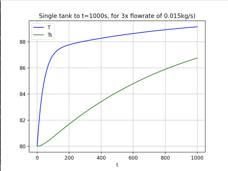

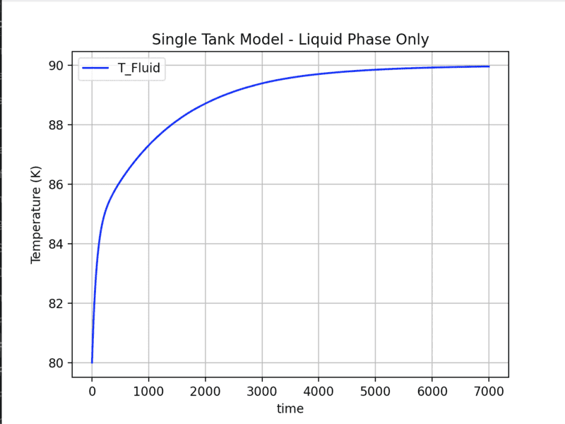

Great! I follow the first paragraph idea. So focusing on the first paragraph - we will have ## h<=0## at all times, meaning we can use the liquid correlations for temperature and mass holdup i.e. ##T = T_{SAT} + \frac{h}{C_{PL}}## and ##m = \rho_{L}*V##.

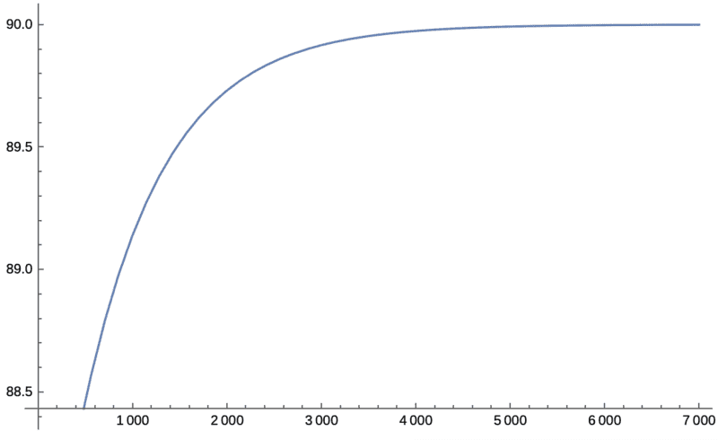

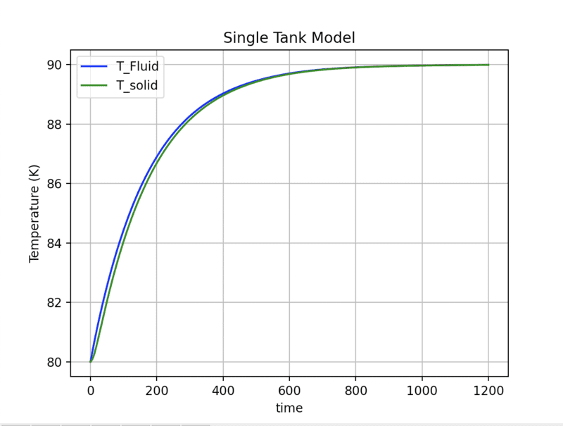

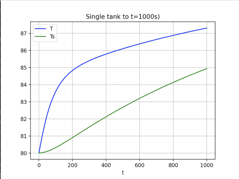

Letting Tsat = 105, Tin = 90, and T0 = 80 (bed/fluid initial temperature), for the single tank model, this is the plot for the liquid phase only model:
If we are expecting a timescale of 1100s here this seems to line up relatively ok.

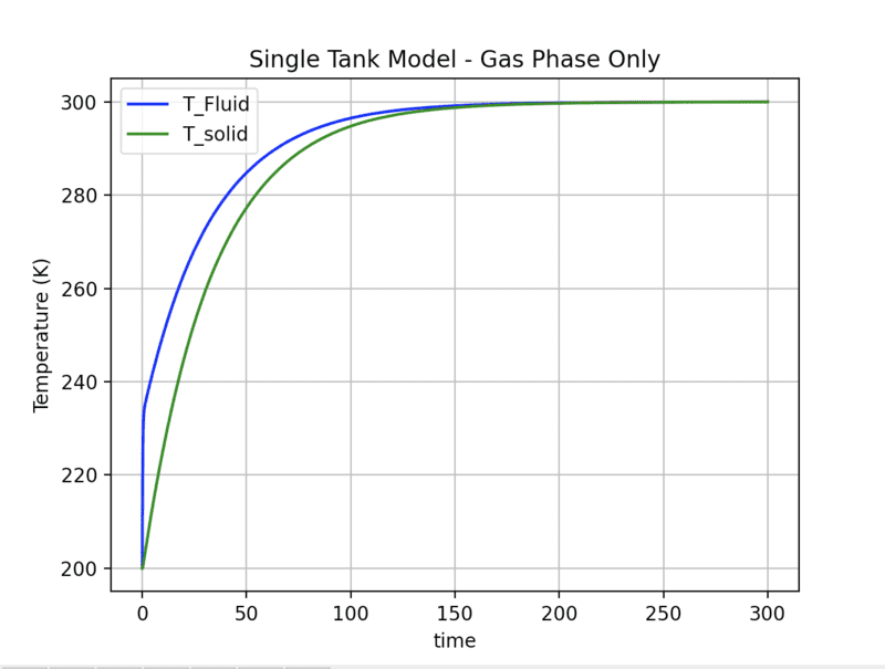

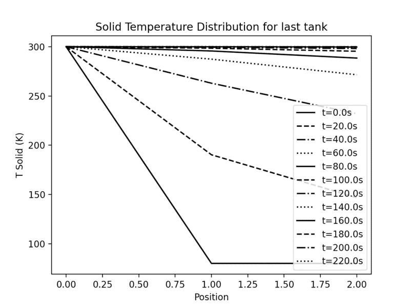

I did the same for gas phase only - where Tsat = 105, Tin = 300 and T0 = 200 (bed/fluid initial temperature), for the single tank model. Gas phase plot looks like this:
Seems to look off, due to that fluid temperature jump at the start. Will do some diagnostic testing on the gas phase section

  • #210
Letting Tsat = 105, Tin = 90, and T0 = 80 (bed/fluid initial temperature), for the single tank model, this is the plot for the liquid phase only model:View attachment 293726
Do you know how to solve this analytically (two linear coupled ODEs in two unknowns)?

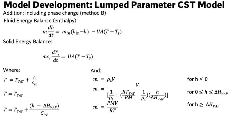

I don't. I can figure this out though. So to confirm, the two equations are the solid and energy balance here:
Where ##h## and ##T_s## are the two unknowns, and where the ##h<=0## correlations will be used for ##T## and ##m##?

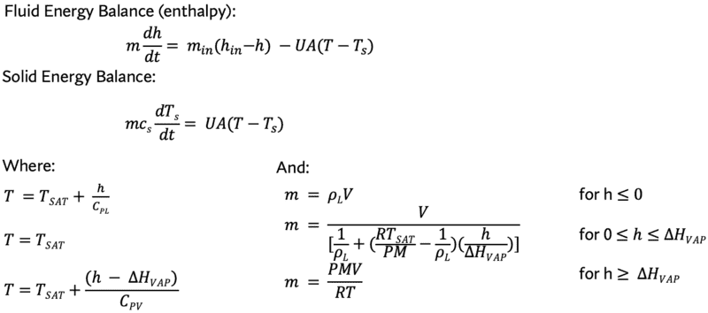

Understood, so these equations, for the liquid phase i.e. T<Tsat:
Yes V is the pore volume for this model
Parameter Values:
Mass of liquid in bed = 8kg
Mass of solid in bed = 1kg
Mass flow rate of liquid to bed = 0.05kg/s
U = 1 W/m2K
A = 0.1m2
Heat capacity of solid = 1.1 kJ/kg.K
Heat capacity of liquid = 2 kJ/kg.K
In regards to the analytical solution, what makes up an analytical solution in this case?
Are we talking about solving for the eigenvalues, or do we mean solving the linear system, i.e. to get h(t) and Ts(t)?
The general approach I was planning to take here is:
1) Differentiate one of the energy balances w.r.t. time to get the second derivative
2) Substitute the other equation in
3) Solve the first equation for h (or Ts)
4) Substitute h (or Ts) back into the second derivative equation
5) We'll get the characteristic equation from this as we'll have the second and first derivative of h, and h
6) then assuming ##\lambda_1## and ##\lambda_2## are the roots
$$h(t) = c_{1}e^{\lambda_1t} + c_{2}e^{\lambda_2t}$$
$$Ts(t) = c_{3}e^{\lambda_1t} + c_{4}e^{\lambda_2t}$$
Where c1-c4 come from h(0), Ts(0), h'(0) and Ts'(0). If this is the route we're going then one question I would have is what would the values of h'(0) and Ts'(0) be?

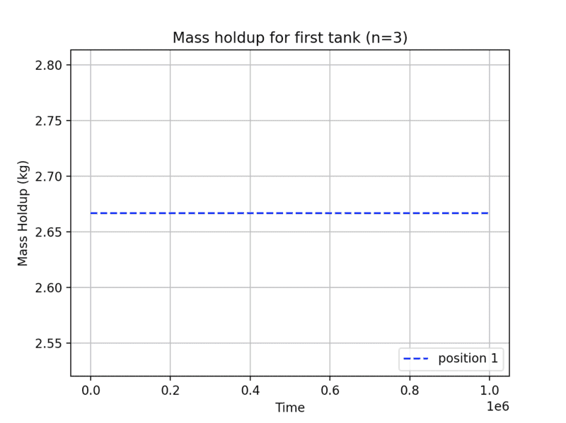

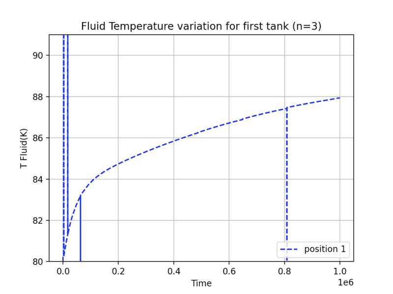

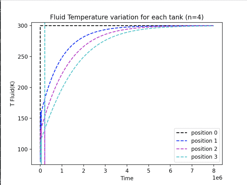

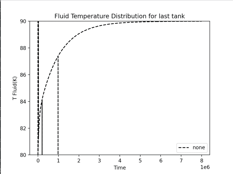

In the present version of the multi-tank model, the balance equations read: $$\dot{m}_{i}=\dot{m}_{i-1}-\frac{V}{n}\frac{d\rho_i}{dt}$$$$\frac{V}{n}\rho_i\frac{dh_i}{dt}=\dot{m}_{i-1}(h_{i-1}-h_i)+U\frac{A}{n}(T_{S,i}-T_i)$$and$$\frac{m_s}{n}\frac{dT_{S,i}}{dt}=-U\frac{A}{n}(T_{S,i}-T_i)$$where V is the total pore volume in the bed and A is the total heat transfer area in the bed.
If we multiply all three of these equations by the number of tanks n, we obtain:$$\dot{M}_{i}=\dot{M}_{i-1}-V\frac{d\rho_i}{dt}$$$$(V\rho_i)\frac{dh_i}{dt}=\dot{M}_{i-1}(h_{i-1}-h_i)+UA(T_{S,i}-T_i)$$and$$m_s\frac{dT_{S,i}}{dt}=-UA(T_{S,i}-T_i)$$where $$\dot{M}_i=n\dot{m}_i$$These equations tell us that the multi-tank model is equivalent mathematically to a tanks-in-series-model in which each tank in the series is identical to the single tank model of the entire packed bed, but with the mass flow rate to the first tank in the series equal to n times the actual mass flow rate to the bed. This form of the model is much easier to code than the present version of the model because much of the code can be extracted from the single tank model (plus we don't have to divide everything by n), less error prone, and it is much easier to conceptualize. What do you think?
  • #219
I follow the reasoning almost completely except the mass flow point here is slightly confusing. So you say the multi-tank model is equivalent mathematically to a tanks in series model. I follow this. It means we can model each individual tank in the multi-tank model the same way the single tank is modeled. So essentially we'll have n single tank models in series, and this is equivalent to the multi-tank model.
This bit though - so we'll have the mass flow to the first tank actually equal to say 0.05kg/s, however we want to multiply this value by n. So capital ##M## is not really the mass flow, its a kind of total flow through the system value. So we will be solving for capital ##M## at all spatial points in the system, and to find the mass flow array we would just need to divide by n? This would make sense to me. Does this M term have physical significance?

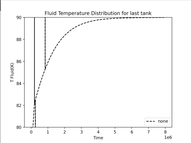

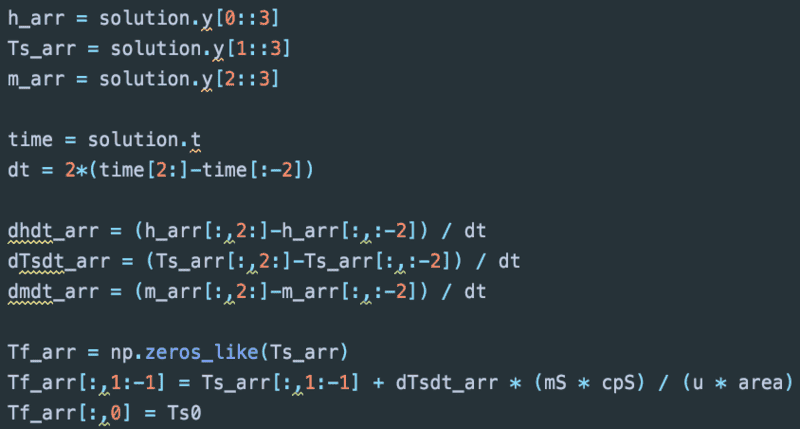

I can code this model up. For this model as we're extracting code from the single tank model, I think it makes sense to finish the analytical solution for the liquid phase single tank model first. I'm actually working on the analytical solution currently. Then once its clear the numerical solution to the single tank checks out, I can use this code for the multi-tank modeled you've detailed above. How does this approach sound?
  • #220
For the trick model, the ratio of the mass flow rate to the the total mass of packing or of fluid in the sequence of tanks must be preserved.
  • #221
Understood. I fully follow. If there is an error in the single tank code this will probably happen in the multi-tank model also, so do you think its worth finishing out the analytical solution model/code first?

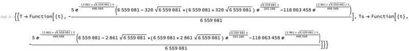

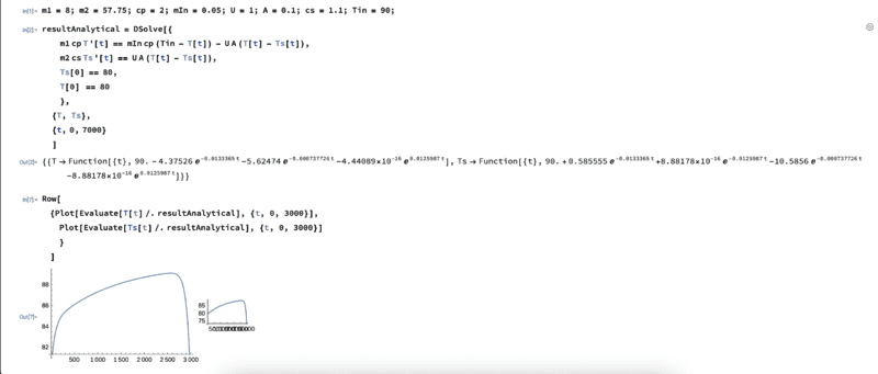

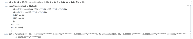

Hi Chet, update on the analytical solution:
I haven't been able to actually derive the analytical solution myself yet (seems more difficult than I first anticipated), however Mathematica does this and has solved the equations both numerically and analytically. I'll transfer the analytical solution functions (if correct) to Python. Here is the output for fluid temperature versus time (I have the solid plot also, its basically the same):
You can see the constant values I used, plus the T(t) and Ts(t) analytical solution functions output by Mathematica (the functions are blurry so I've typed them out at the bottom), and also the analytical solution graph from 0 to 3000s. Note it seems to curve off unexpectedly just before 3000s.
Here is the numerical solution, also done by Mathematica. The plot starts out similar to the analytical one, and continues to level off towards the inlet temperature indefinitely, which seems to make more physical sense. There is no unusual decrease in temperature behaviour happening in the numerical solution
Its late here so I'm going to check these plots against my own code first thing tomorrow.
Edit: The screenshooting doesn't seem to want to cooperate with the Mathematica page so I'm copying the analytical solution below. It doesn't seem to want to wrap at the end of the line (its two equations in the same line), so I will edit this tomorrow
$${{T(t) = 90 -4.37526 E^{(-0.0133365 t)}-5.62474 E^{(-0.000737726 t)}-4.44089*10^{-16} E^{(0.0125987 t)}]
and
Ts(t) = 90 +0.585555 E^{(-0.0133365 t)}
+8.88178*10{^-16} E^{(-0.0125987 t)}-10.5856 E^{(-0.000737726 t)}
-8.88178*10^{-16} E^{(0.0125987 t)}]}}$$
I haven't been able to actually derive the analytical solution myself yet (seems more difficult than I first anticipated), however Mathematica does this and has solved the equations both numerically and analytically. I'll transfer the analytical solution functions (if correct) to Python. Here is the output for fluid temperature versus time (I have the solid plot also, its basically the same):View attachment 293819
and
Their analytic solution is very puzzling because there are only two eigenvalues to the characteristic equation. Here is the eigenvalue equation I came up with: $$\lambda^2+\left[\frac{\dot{m}_{in}}{m}+\frac{UA}{mC}+\frac{UA}{m_sC_s}\right]\lambda+\frac{\dot{m}_{in}}{m}\frac{UA}{m_sC_s}=0$$
For the parameter values you showed in your printout, this gives $$\lambda=-0.0133$$and$$\lambda=-0.000738$$which matches their values (at least on the two main terms). This implies a time constant at long times of 1/0.000738=1355 sec.
Let's see how your numerical solution compares to their analytic solution..
The analytical and numerical solutions from Mathematica now match. The problem was in how Mathematica deals with decimal numbers. So the graphs of T and Ts vs time now match.
And here is the analytical solution:
Editing my numerical solution now to compare.
There we go, my numerical solution does seem to match the Mathematica one:

And here is the plot for the liquid phase temperature, using the spatial variation model, assuming n=2 (so the inlet conditions plus one spatial point). Ignoring the jumps, This also matches the other plots:
Note the time is x1000 (due to 1000 points calculated per time step) so dividing the x-axis values by 1000 gives the same values as the previous plots
And lastly, I've set n = 32 and plotted the final position (index 31) versus time:
This also roughly matches the timescale of the other plots. Is this all reasonable to you?

Here we go, this is for n=4. I went with n=4 so we can see three inner-tank Tf vs t graphs, position 0 is just the inlet condition.
As you mentioned we can see the time delay across the tank. The plot is quite messy due to these 'numerical bumps'. The output does look similar to the analytical and numerical output from Mathematica though.
Reverting back to the two phase model (assuming liquid in the tank, with a gas 300K input). Heres the graph for n=4. This also seems to approximately matches the timescale of the others:
Am I correct in saying this means that the spatial variation model is correct? i.e. no particular need to move to the model you outlined yesterday? I will code this up anyway but it seems the original spatial variation model is ok?

Can do, this is both graphs above, to 1000s, for the liquid phase only (90K inlet stream, bed initial temperature of 80K).
Single tank:
Spatial variation plot: for n=4:
The single tank plot seems to best match the first position here.
Chestermiller said:
Also, can you please include the single tank model results for the entire bed for comparison? All this for the liquid only case. Thanks.
To clarify by this do you mean plot both the fluid and solid temperature for the single tank, for the liquid phase?
Note: Its just the spatial variation plot that is time*1000 for the x axis

casualguitar said:
Yes correct
Single tank:
The single tank plot seems to best match the first position here.To clarify by this do you mean plot both the fluid and solid temperature for the single tank, for the liquid phase?

Here we go, this is a 3x flowrate plot for the single tank model. So the flow here is 0.15kg/s. Everything else is the same:
I will look into this overlay plot now. There is almost definitely a convenient way to do this
  • #237
This is what the first tank in the 3 tank model should give. Does it?

Hmm, this is the Mathematica analytical solution for 3x flowrate (zoomed to appropriate section because its fairly blurry otherwise):
Taking a reference point of 1000s, the temperature is just above 89, say 89.1K
Here is my numerical solution for the 3x flowrate single tank model (from above):
At t = 1000s, the temperature seems to be around 89K also, so its similar to the plot above. I think we can now say the Mathematica plot, and my single tank numerical solution are both correct

Here is the multi-tank plot for n=3, and m = 0.05kg/s:
At t = 1000s, the temperature is 88K, so its 1K lower than the single tank plots.
Am I correct to use n = 3 here?
Here is the plot for n= 4:
So t = 1000 and T = 88.3K or so. about 0.7K off.
I don't know if these are 'close enough' or not, but my guess is that they are not close enough. I'll run some diagnostics now in case it is not close enough

  • #239
Multi-tank plots:
You need to compare the temperature vs time of the first tank in your multi-tank 3 tank model with the temperature vs time for the single tank model of the full bed, the latter at 3x the flow rate of the former. The two results should match exactly. I hope I’m making it clear what I’m asking for. This is a validation check on the multi-tank model.
  • #240
The idea is clear, and I can validation check by using the values of the other parameters (h,m,Ts).
One question - I'm not clear on the correct value of n. My thoughts are that temperature is evaluated at the 'centre' of a tank. n=0 is at the inlet and n=n is at the outlet. So to have 3 'tanks', we would need n=5?
Either way none of n=3,4,5 give exactly the same solution as the analytical one, so I need to do some testing regardless

Some data for n=3, tank 1:
The mass holdup versus time:
This checks out because its just 8kg/3
dm/dt:
Zero as expected
dp/dh is also zero for all times
The differential equations all look ok to me, so I reckon the error is in how I have set up the initial and boundary conditions. Checking this now

Chestermiller said:
And, of course, in each of these steps you are also calculating the time derivative of the bed temperature for the specific tank, and also loading this into the derivative vector.
Instead of this I'm just taking the solid energy balance, and generating the fluid temperature vector afterwards. The Ts array is known so I generate the dTs/dt array also and get the fluid temperature array from this. This image shows the flow for that:
I'll go for removing m from the solution array first

Chestermiller said:
I have a feeling that the thing that is causing your numerical problems is the overall mass balance for each tank.
Got it. Its the way I'm regenerating the derivatives. Solved now!:
So this leaves us at the point of having a working spatial variation model. We had discussed your ##M_i## model, however I haven't implemented this. Was this #M_i## model made purely to create a stepping stone between the single and multi tank model, or is there other reason to implement it?
