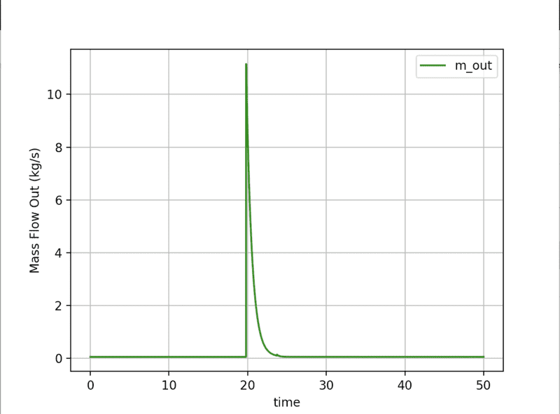

  • #184
Chestermiller said:
Yes. Not only that. Maybe now, with the present sweeping tank-at-a-time setup, it might be easier to do the integration ourselves, without using the package ODE integrator. With an implicit integration like backward Euler or Crank-Nicholson, it would only involve solving two linear equations in two unknowns for each sequential tank for each time step. What do you think?

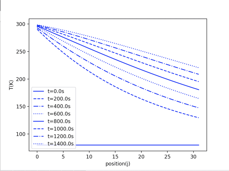

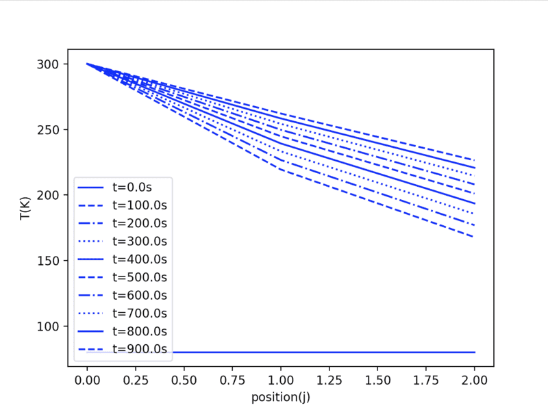

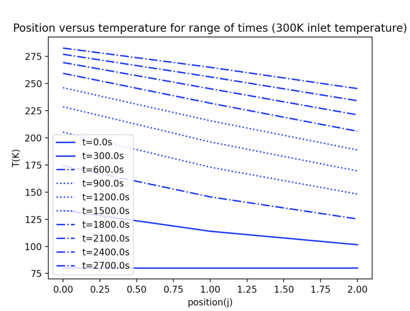

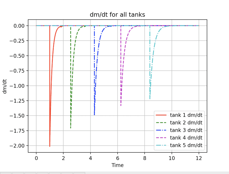

Hi Chet, the code for the model is done I think. I'm setting up various plots now. Temperature distribution for a number of times here:
The trend seems to look normal to me i.e. the positions closer to the left increase in temperature first, followed gradually by positions closer to the right

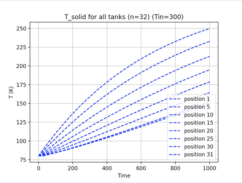

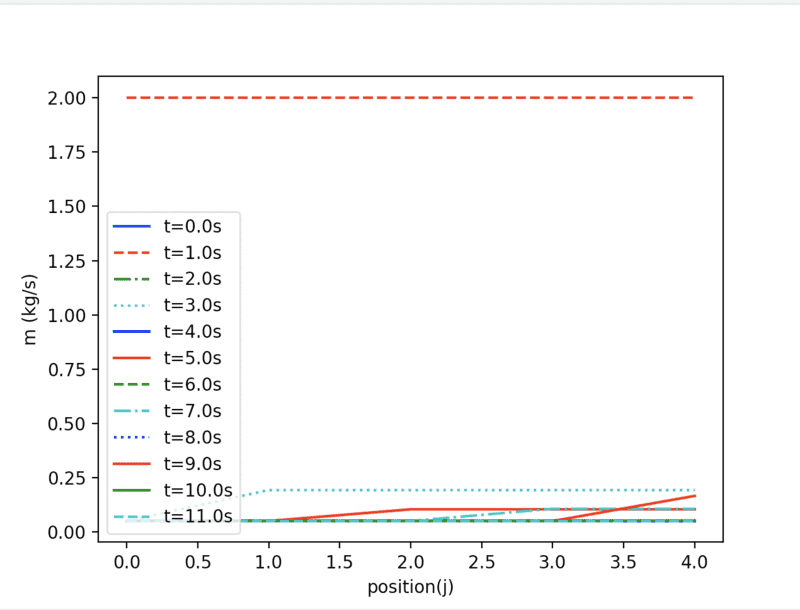

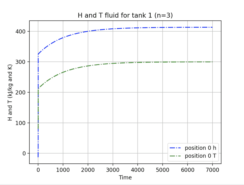

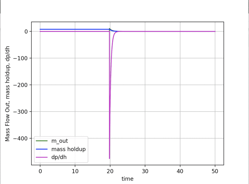

And similarly for the fluid enthalpy and mass holdup:
The mass holdup plot isn't exactly visually nice to look at. But yes these are the three plots. How does this look to you?

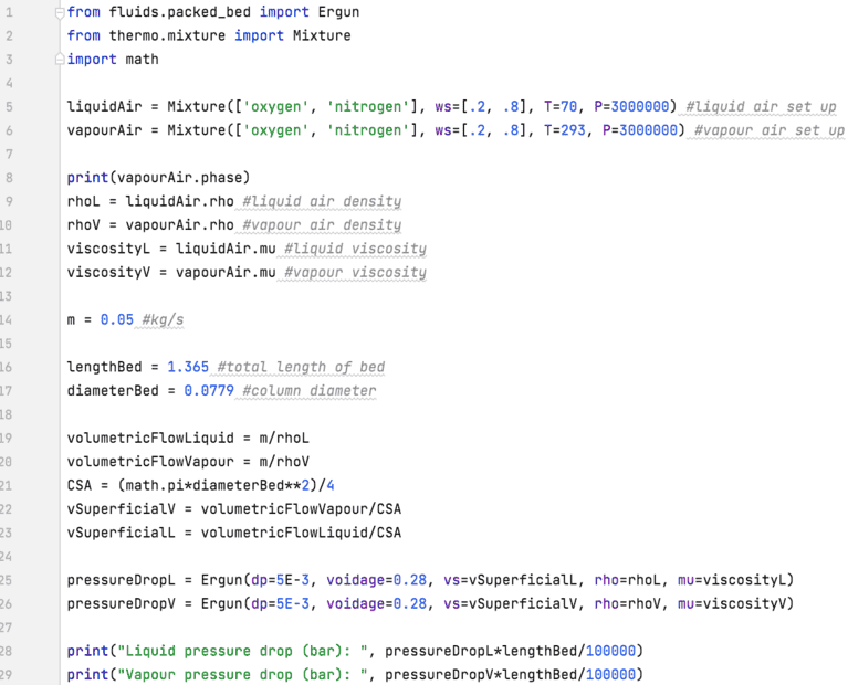

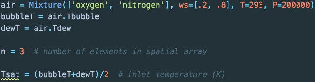

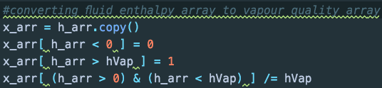

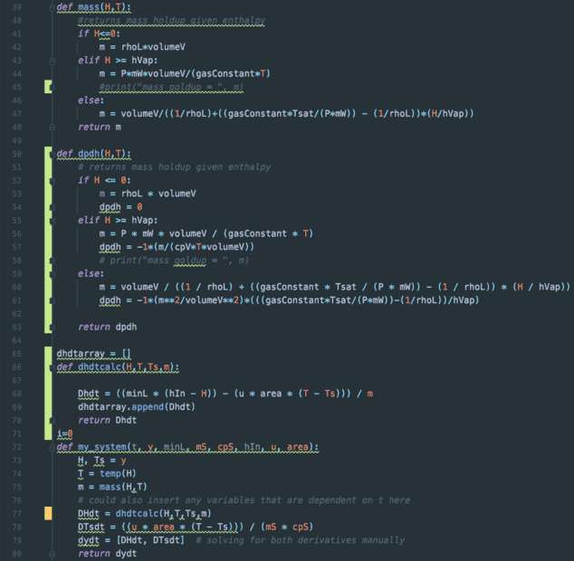

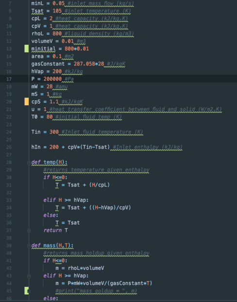

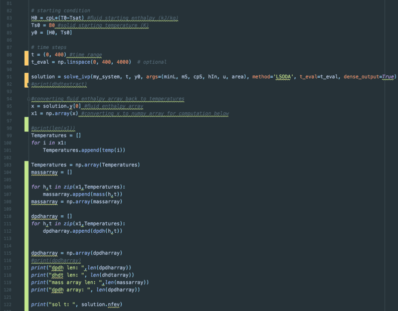

And the code:

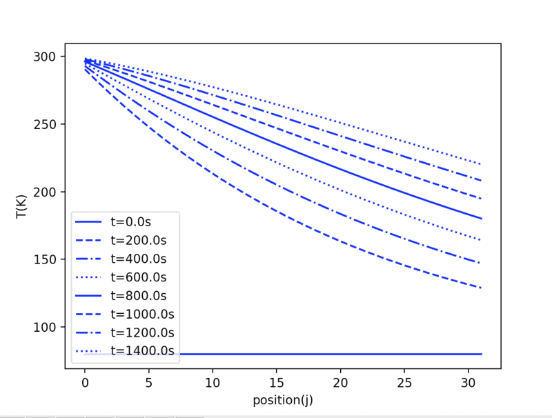

  • #186
And the code:
This is for 30 tanks, each 1/30 the size of the tank in the single tank model, correct?
In comparison to the single tank model, the time response of this model seems way too fast. The results also seem to show that all the liquid is purged from the bed by 20 sec. This doesn't seem likely. Have you compared the time-dependent results for the first tank in this model with the results of the single tank model for the case of a tank 1/30 the size of the overall bed? The results from this comparison should match.
Also, what does the bed temperature profile look like?
  • #187

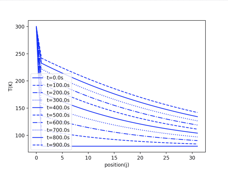

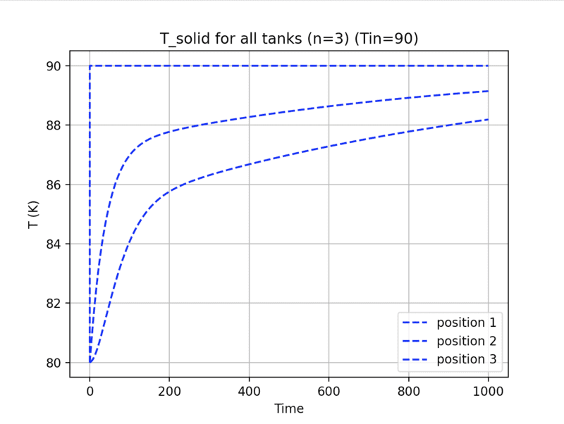

Yes I actually forgot to divide the heat transfer area, and the solid mass by the number of tanks when I was making that graph (see Area and mS parameters are not divided by n). I was looking at the effect of having multiple tanks and forgot to switch back. Heres the fluid temperature plot for n = 32. Note that for the first and last timestep Tf == 0. This is because the numerical derivative dH/dt eliminates two data points. So I've manually added in the IC for the fluid (t=0) again for visual purposes:

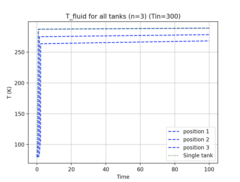

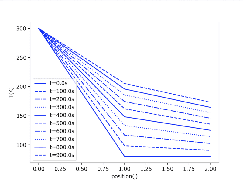

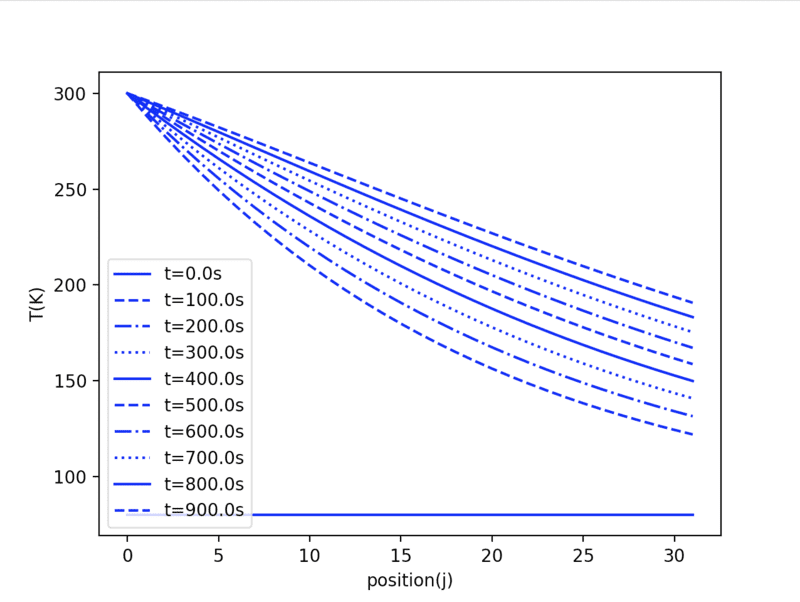

The solid temperature profile:
Comparing this model with the last one now. I don't think they match though, unless I've compared them incorrectly. Checking now
Also, to confirm - if I divide the volume, area and solid mass by n (number of tanks) at the top of the script when declaring variables, then n will not appear at all further down in the computations?

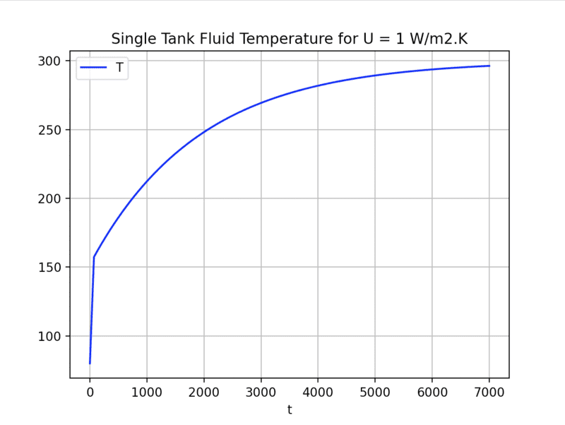

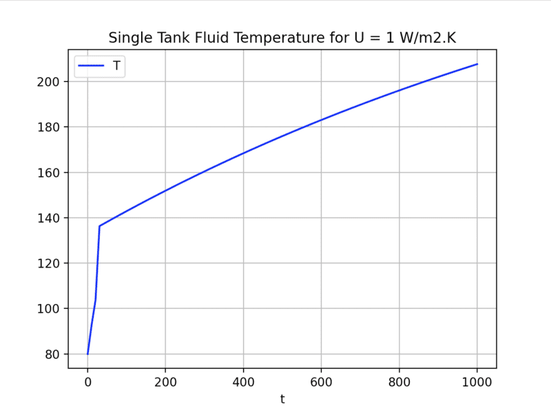

Heres the plot of the fluid temperature for the no spatial dependence model.
Thinking about this some more, this graph should roughly match the spatial dependence graph at the first position, which it does
To clarify, I divided the volume, area and solid mass by n = 32 in spatial dependence model (I think I actually should have divided by 30 not 32 but anyway). This means that the first tank in the spatial dependence model, and this non-spatial-dependence model are now identical

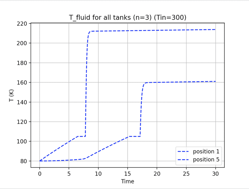

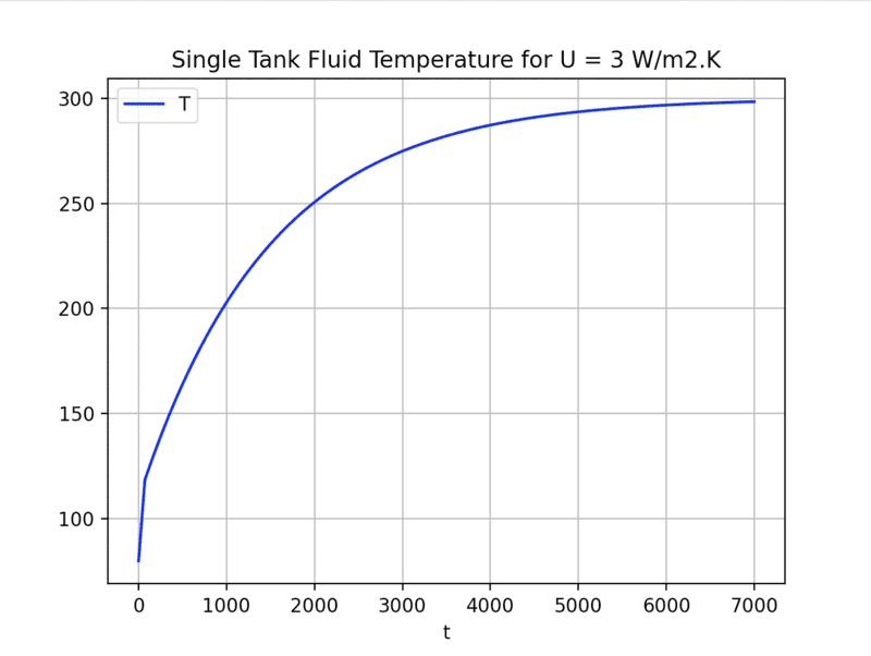

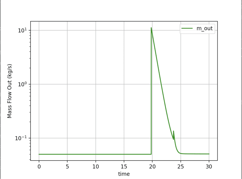

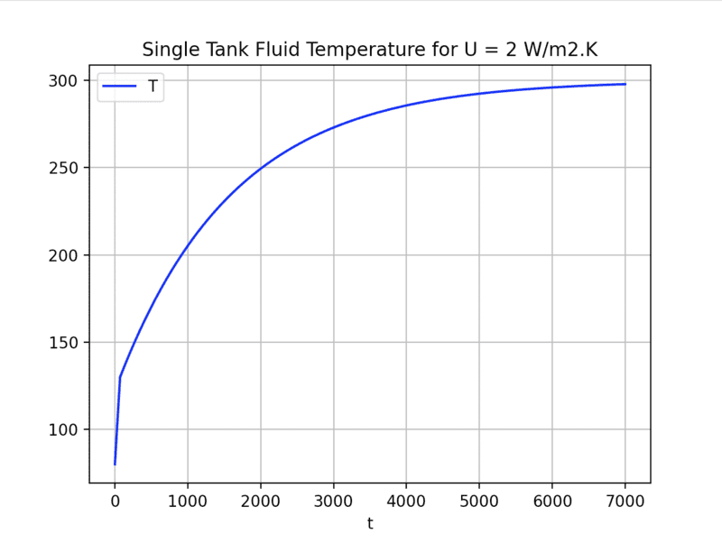

I can't get the single and 32 tank plots on the same plot, so I'll create two. Here is the single tank model plot, where I have taken the volume area and solid mass we had in the original single tank model, and divided them by n = 32:
So it takes about 2 seconds before the temperature levels off in the single tank

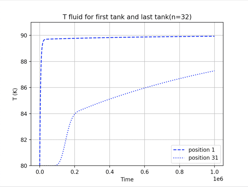

Similarly, for the final tank here is the outlet temperature as a function of time:
So yes the 32 tank model predicts it will take about 80s for the temperature to level out in the final tank (note the time axis shows x1000 currently. This is 0 to 80s). The single tank model predicts it will take 2 seconds for the temperature in the single tank model to level out.
Also the jumps around the 7 to 10s mark are due to the enthalpy function not being continuous. I'm using the enthalpy derivative to calculate the fluid temperatures
Lastly here's the first tank temperature versus time, showing about 30s to level out (also much slower than the single tank model)
Looking into this now
Update: I've got another person to check the newer model and it seems to look ok. Its likely the single tank model that has the error. Checking now

  • #193
Chestermiller said:
No. I want to compare what each of the two models predicts for the temperature as a function of time of the gas coming out of the overall bed.
Results for this are in post #192. Is it true to say that there is an error in one of the models because the single tank model temperature profile does not match the first tank in the multi-tank model?
ie.
These are not the same:
I haven't seemed to find any errors in either just yet

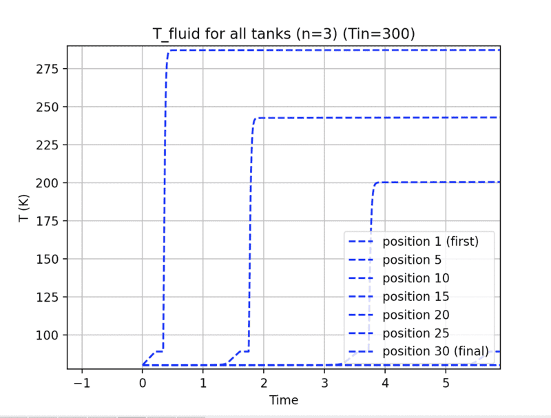

  • #194
ie.
The Single tank model for the entire bed should match the 32nd tank of the multi tank model. Well what I really mean is that the time scale should match approximately.
  • #195
The time scale of the models further back is much closer to the new spatial variation model, which suggests there is some error in the single tank model, which would seem to make sense anyway as the purge time is very low. Looking into it
  • #196

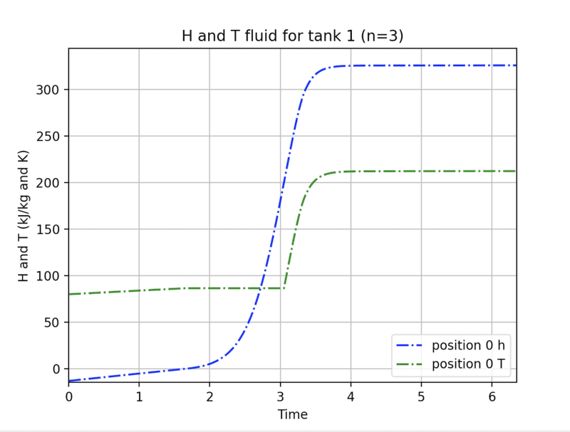

Getting closer to the solution to this. Its almost definitely got something to do with how I'm adjusting volume, area and solid mass for the single tank model to match the multi tank model values. The reason I think this is because when I fully remove any 'n' from the single tank model i.e. just use the values I used before, the shape of the single and multi tank plots are very similar. Still slightly off in terms of time but they look alike:
Single tank plot:
Multi tank plot:
So when I try to divide by n it fails and I get a plot similar to the very short time scale in a previous post. So it seems that using volume/n, area/n and solidmass/n is not doing what I expected it to do in the single tank plot
Note the times for the multitask plot are x1000 as I haven't figured out how to scale down the x-axis by 1000. The time range here is 0 to 80s
Do these plots 'match'? Or do you reckon there's an error in one?

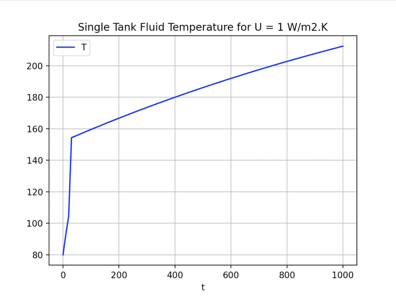

  • #197

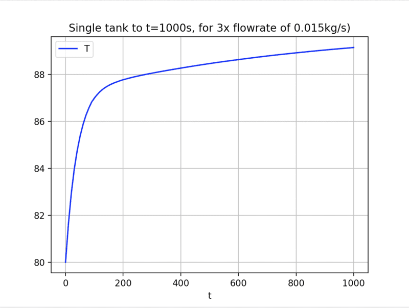

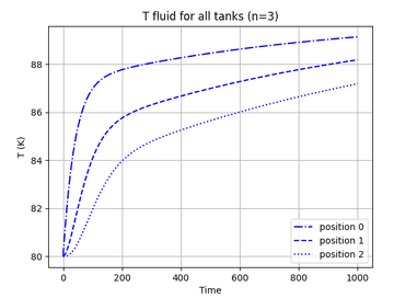

Edit: The above plots are of time versus enthalpy (forgot to change the y-axis label)

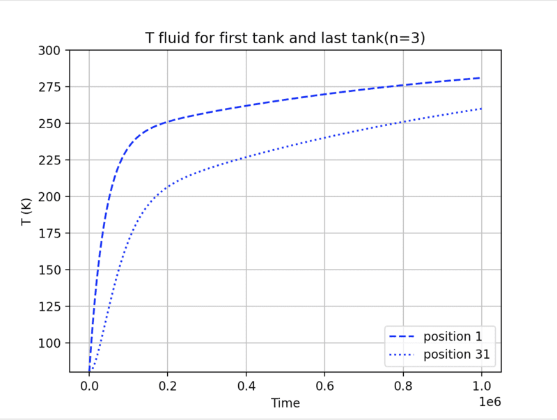

Here are the plots of fluid temperature versus time for both cases:
1) The single tank model:
Last tank in the 32 tank model (where actual t = t/1000):
These plots seem to show a similar trend and an approximately equal 'levelling off' time for the fluid temperature. The fix (if you agree these plots look ok) was in how I was dividing up the volume, area, and solid mass per unit area
I am absolutely ready to work some more on this model today if you think we're ready to do some more

They have to approximately match on the time scale. The multi-tank time variation of the temperature leaving the tank should be sharper (closer to a square wave) than the single tank model of the overall bed. But they need to be close to one another. The multi-tank should have lower temperatures at short times and higher temperatures at longer times; so they have to cross over one another.
The time scale for the response should be roughly on the order of $$\frac{m_SC_S}{UA}$$What value do you calculate for this?
I'm going to try to leave the coding up to you and only offer guidance on model structure.
  • #199
Chestermiller said:
The time scale for the response should be roughly on the order of mSCSUAWhat value do you calculate for this?
11 for this (##mS = 1, C_ps = 1.1, U = 1, A = 0.1##). Is this time scale term an approximation for the time it should take to reach steady state in a tank?
Ok so are you saying there is an error in the multi-tank model because it doesn't really cross over the single tank model at all? i.e. higher temperature at low and high times

I don’t know which model has the error (or errors). This is part of doing the validation of the model.
  • #201
Chestermiller said:
For the bed

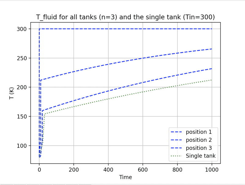

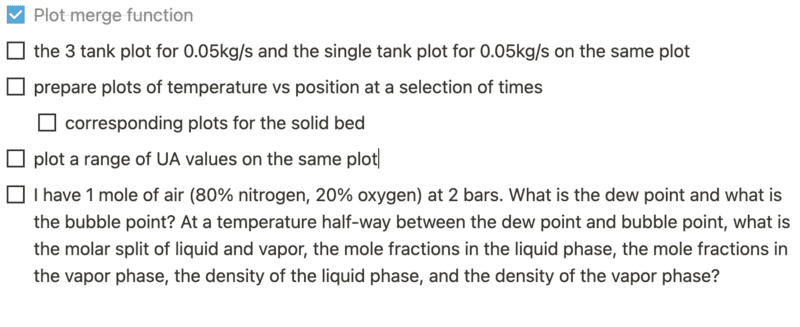

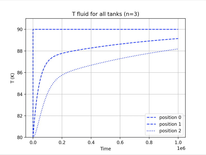

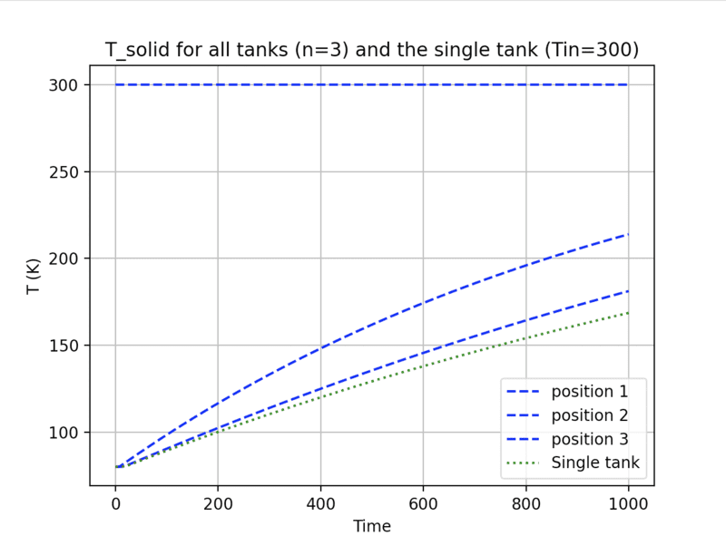

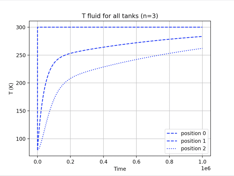

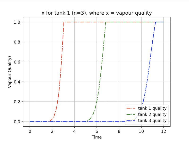

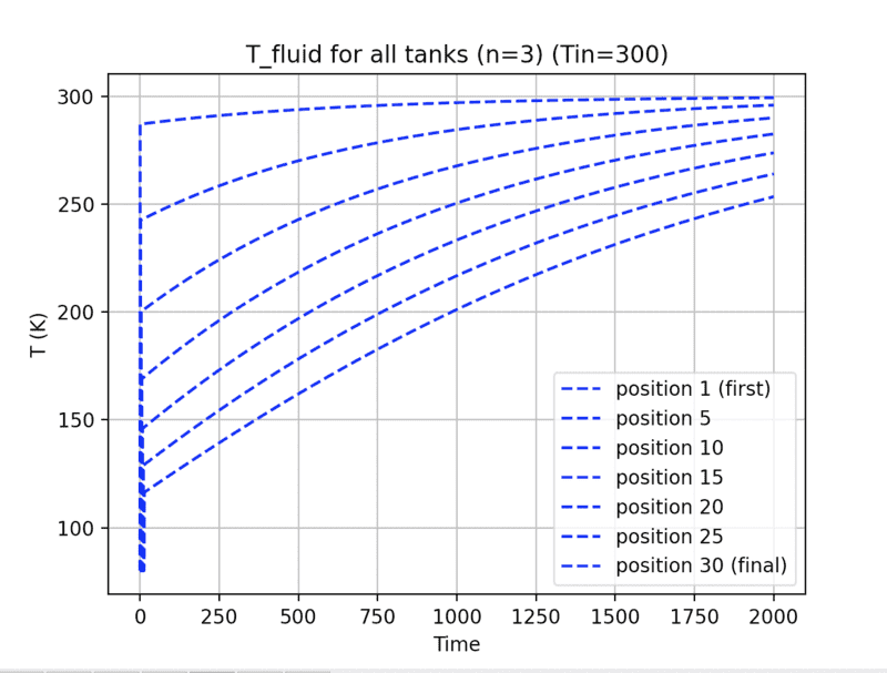

Got it my bad working on this now.
One approach to do this could be to reduce to 3 tanks and do some manual calculations to see which model values don't match the manually calculated versions. Trying this now

  • #209
Chestermiller said:
We have got to take a step back, and make sure that the single tank model of the entire bed is getting the right answer. This can be checked by running a calculation in which the model can be solved analytically. Such a case would be if the stream entering the tank is a liquid at a temperature below the saturation temperature, and the bed is initially at a colder temperature. Then we can compare the analytic solution to the time-dependent numerical solution to make sure that the time scale we get numerically is correct.
Great! I follow the first paragraph idea. So focusing on the first paragraph - we will have ## h<=0## at all times, meaning we can use the liquid correlations for temperature and mass holdup i.e. ##T = T_{SAT} + \frac{h}{C_{PL}}## and ##m = \rho_{L}*V##.
Letting Tsat = 105, Tin = 90, and T0 = 80 (bed/fluid initial temperature), for the single tank model, this is the plot for the liquid phase only model:
If we are expecting a timescale of 1100s here this seems to line up relatively ok.
I did the same for gas phase only - where Tsat = 105, Tin = 300 and T0 = 200 (bed/fluid initial temperature), for the single tank model. Gas phase plot looks like this:
Seems to look off, due to that fluid temperature jump at the start. Will do some diagnostic testing on the gas phase section
  • #210
Letting Tsat = 105, Tin = 90, and T0 = 80 (bed/fluid initial temperature), for the single tank model, this is the plot for the liquid phase only model:View attachment 293726
Do you know how to solve this analytically (two linear coupled ODEs in two unknowns)?
