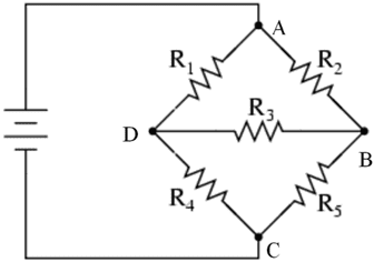

This is not homework, the question just crossed my mind when I was reviewing about Wheatstone bridge. Please see the picture below
Series and Parallel circuit
I want to ask what the total resistance of the circuit will be if R2 is removed and being replaced with ideal wire.
I think R1 and R3 will be parallel → let this be R6
R6 will be series with R4 → let this be R7
Then R7 will be parallel to R5
Is that correct? Thanks
Likes Delta2 and Charles Link
I also think you are correct.
Likes Charles Link

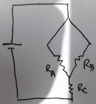

If both R1 and R2 are replaced by ideal wire, would I need to use Delta - star transformation?
Something like this:
where:
$$R_A=\frac{R_3 \times R_4}{R_3+R_4+R_5}$$
$$R_B=\frac{R_3 \times R_5}{R_3+R_4+R_5}$$
$$R_C=\frac{R_4 \times R_5}{R_3+R_4+R_5}$$
After that, ##R_A## will be parallel to ##R_B## and the result will be series with ##R_C##
No I don't think that's correct , if ##R_1## and ##R_2## are replaced by ideal wires then we shall have ##V_D=V_A=V_B## which means that effectively ##R_3## will also be out of the game. So you ll just have ##R_4## and ##R_5## in parallel. That's what I think.
