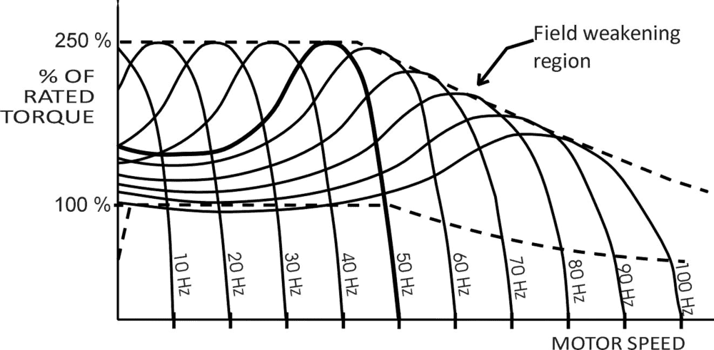

Yes as for the ac induction motor , sorry should have said at least 1hz instead of 0, surely without induction taking place the rotor doesn't feel any force at all.
I think I get the picture , from few hz up to rated hz the torque increases rapidly and so does rpm , then above rated hz rpm continue to increase but torque falls off due to the fact that increasing frequency but having constant voltage results in less current through the stator coils.
I assume you say that mechanical power expressed in kW or HP stay almost constant because those are calculated from the product of torque times RPM so when one falls the other increases and the result stays about the same ?
Although I would assume that torque falls faster than RPM increases above a certain frequency.?

From zero rpm, or a few Hz, to the knee speed, the torque is constant and dependent on current, mechanical power increases from zero to maximum at the knee speed.
The knee speed to me is when you demand 100% Iq and the machine will not spin faster, you have "run out of voltage" at this point, increase you bus voltage, this speed moves up. If you want to run above this knee speed, you have to apply Id, or field weakening current, now some of your phase current is used to reduce the net back EMF (ie cancel some of the rotor flux), since you are still phase current limited, this means you have less Iq available for making torque. Rated Hz doesn't make sense in this context, the machine will happily run from zero Hz (in case of synchronous machine) to a maximum frequency determined by the pole count and mechanical rpm limit of the machine (bearings etc).
There are other things that come into play and as speed goes up really high you do stop being in "constant power", and enter a voltage limited area. Frequency does affect your voltages, iwL vector (produced by the stator inductance) is taking voltage without producing torque. However fundamentally these speed limits come about not because of Hz, but because of Volts, the main one is back EMF.
