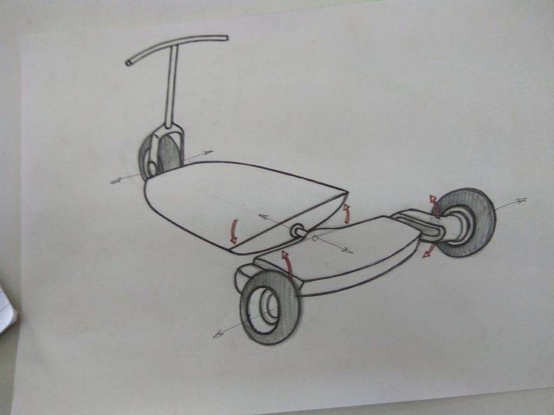

I am have been trying to figure out the correct way to mount a needle bearing.
I have previously worked with ball bearings.
Here is the application:
The needle bearing will be pivot point of a swing arm of a trike. Another will form the central pivot point that breaks the vehicle from front to rear. See image for reference. The red arrows mark moving points.
The pivot points should ideally be hollow so that I can pass wirings and brake hoses through them. The rear wheels are hub motors (hence wires have to pass through them).
By using needle bearings, I think I can reduce the outer diameter of the bearings, yet get sufficient inner diameter for all the wires to pass through. What I can't figure out is how to mount them.

So what I understand is that the inner ring of the bearing can slide in or out in the bearings I had selected.
On other hand drawn cup bearing doesn't have inner ring. Assuming I press fit the bearing in housing, the bearing and housing are locked with each other.
Now the shaft can still slide in and out of the bearing? Assuming I use a shoulder on one end of the shaft and retainer ring on other end, the shaft can be locked as well with the bearing.

When using needle bearings it is generally better to have separate bearings for the radial and axial loads .
Thrust needle bearings .
Likes Heral89
If I understand what you are doing correctly though there is no continuous or rapid motion in these bearings . It may be that sleeve bearings will do all that you want at lower cost and with less complexity than for rolling contact bearings .
Can you post a dimensioned sketch of the actual shafts and housings that you are asking about bearings for ?

Every location you indicate on your illustration is going to have thrust loads. Axial needle bearings are not designed for thrust loading. There are radial thrust needle bearing assemblies that can be used in concert with axial needle bearing but these are radial in design and would defeat you intended purpose to reduce the O.D. to I.D. of your assembly design.
A single needle roller bearing is not good at controlling alignment. Any misalignment will put very high loads at the ends of the small radius rollers, that will quickly Brinell the bearing surface. https://en.wikipedia.org/wiki/Brinelling
To overcome that, where needles or rollers are used you must control the alignment with another bearing some axial distance away.
A better way, which will handle all loads, would be to use two opposed tapered roller bearings, as in a vehicle stub-axle/hub. But rolling bearings need lubrication, and then seals to keep the dirt out.
If rollers or balls do not rotate sufficiently they do not spread lubrication.
The attractive alternative is to use a hard polymer sleeve bearing to carry the load.
