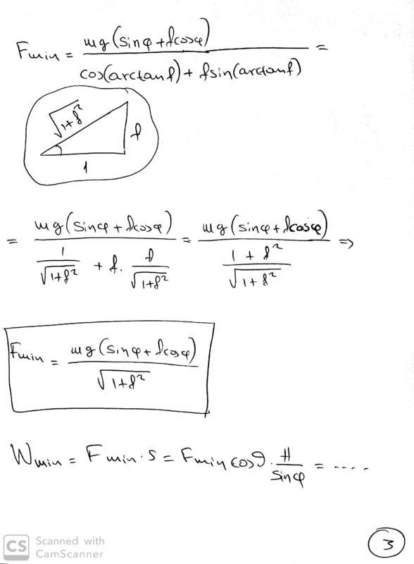

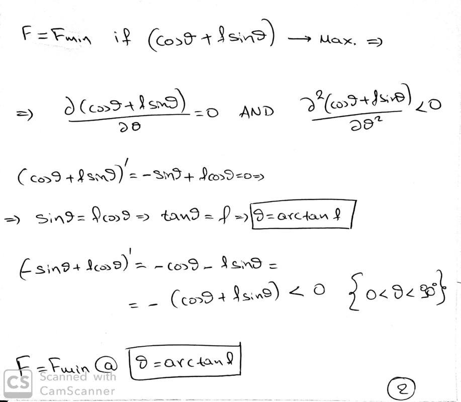

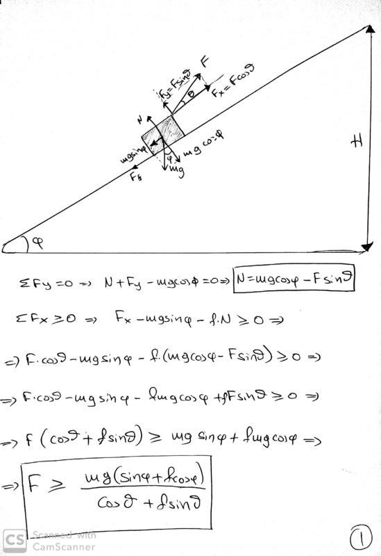

Moving a box on an inclined plane. friction coefficient is f. We pull the box with angular force (pic below) Which is the angle θ where the F is minimum. Find the Fmin and the Work of Fmin. when the box is on height H
nill
Hi,
this is my try:
I would appreciate any confirmation or correction .
Thanks
All looks good to me.
