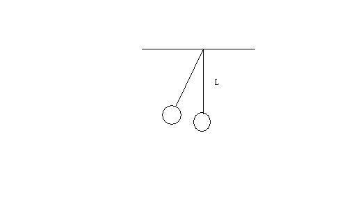

if a mass is hangig from ceiling of a car the car starts to accelerate forward with acceleration greater than g the mass will rotate and then starts to accelerate forward wheil its in the same position making an angle with the vertical
my question what caused the rotation?
i know there is the tension of the rope but this not enough for rotation
and for a person outside the car no other force is there
yes the one inside say there is a force butits only inertia.
so what causes rotation

While the mass initially moves backward with respect to the car, viewed from the ground it always moves forward.
You get rotations when the total force on an object is not directed at its center of mass. In this case, the rope from which the object hangs must not be attached at the object's center of mass. If it was, there would be no rotation.

The mass will be accelerating with the acceleration of the car and the horizontal component of the tension in the string provides the resultant forward force on the mass.
If the angle of the string to the vertical is ∅ then TSin∅ is the force responsible for the acceleration of the mass. TSin∅ = ma
The vertical component of the tension (TCos∅) will equal the weight (mg) of the mass
These 2 equations give Tan∅ = a/g

So your mass is like a lump of concrete with a hole bored horizontally through its centre, and supported on a frictionless axle located through this hole? It is the axle itself that is supported by the rope dangling from the roof?
Is that the picture?
yes it is like serway problem page 161
n.b the pic in serway shows that there would only be a horizontal movement but mathematically impossible as the the tangent of the triangle should be the same length of the rope and this wouldn't be possible if it stays on the same horizontal level

The car accelerates, yanking the string along with it. The string doesn't stretch (much), its tension increases, giving an upward (and forward) force to the mass at its end.
