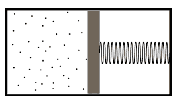

In a cylindrical piston of section S a piston can move without friction. A mole of ideal monoatomic gas is confined to the left, the right chamber is empty and contains a spring with elastic constant k which would be at rest if the piston were all the way to the left.
Initially the gas is at rest in an "A" state (##p_A = 10^5 Pa,
V_A = 25 dm^3##). It takes place through an exchange of heat with the outside
a slow transformation until reaching a "B" state with volume
halved. Calculate :
a) the heat ##Q## exchanged by the gas with the external environment to complete the transformation,
b) the entropy change ##\Delta S_G## of the gas,
c) how many moles ##n_{agg}## of gas must be added to bring the piston back to the initial position assuming that the temperature remains that of state "B"?
##F_{spring}=-kx, \Delta U=Q-L, W=\int_{a}^{b} \vec{F}\cdot\vec{dx}, \Delta S=nC_V\ln(\frac{T_f}{T_i})+nR\ln(\frac{V_f}{V_i}), PV=nRT##
a) ##T_A=\frac{p_AV_A}{nR}=300.7K, P_A V_A=kL^2=nRT_A##, ##P_B S=k\frac{L}{2}\Rightarrow P_B V_B=k(\frac{L}{2})^2 \Rightarrow P_B=\frac{kL^2}{2V_A}=\frac{P_AV_A}{2V_A}=\frac{P_A}{2}##, ##W_{spring\to gas}=\int_{L}^{L/2}kxdx=-\frac{3}{8}kL^2=-\frac{3}{8}nRT_A####\Rightarrow Q=L+\Delta U=-\frac{3}{8}nRT_A+n\cdot\frac{3}{2}R (\frac{T_A}{4}-T_A)\simeq 3750 J##
b) ##\Delta S_{gas}=nC_V\ln(\frac{T_f}{T_i})+nR\ln(\frac{V_f}{V_i})=nC_V\ln(\frac{T_A /4}{T_A})+nR\ln(\frac{V_A/2}{V_A})=-4nR\ln(2)=-23 J/K##
EDIT: I think I have managed to solve also part c)
c) ##T_B=\frac{P_BV_B}{nR}=\frac{1}{nR}\cdot\frac{kL^2}{2V_A}\cdot\frac{V_A}{2}=\frac{1}{4}\frac{kL^2}{nR}=\frac{1}{4}\cdot\frac{P_AV_A}{nR}=\frac{1}{4}T_A## so ##n_f=\frac{P_AV_A}{RT_B}=\frac{10^5\cdot 25\cdot 10^{-3}}{8.314\cdot\frac{300.7}{4}}mol=4mol## so ##\Delta n=n_f-n_i=(4-1)mol=3mol##

In part (a), your W is the work done by the gas on the springbecause ##Q=W+\Delta U##. So, for Q, I get $$Q=-1.5RT_A=-3750\ J$$
The rest looks good. Very nice job.
