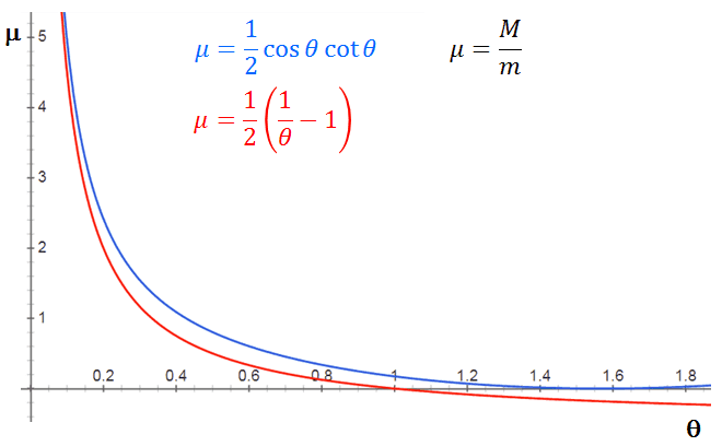

The small angle approximation is, of course$$\theta = \frac{1}{2\mu + 1}$$I can't prove, however, that the solution tends asymptotically to that equilibrium angle.
I assumed that (in the rest frame of M) the sum of gravity and inertial force on the hanging m is parallel to the string. This lead me to the following relationship:
$$\mu= \frac{1}{2} \: cos(\theta) \: cot(\theta)$$
I compared it to your approximation, which would be:
$$\mu= \frac{1}{2} (\frac{1}{\theta} - 1)$$
I think it makes more sense that when μ goes to 0, then θ approaches π/2 rather than 1 rad.
