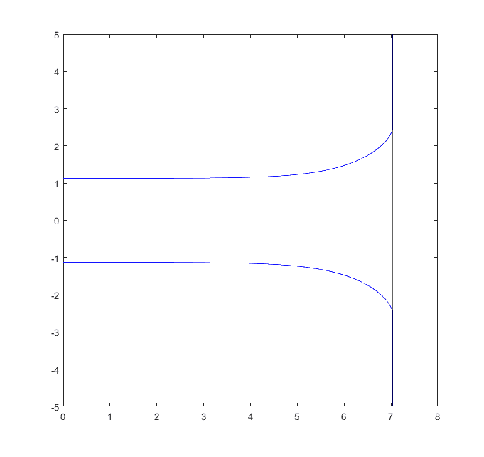

I wrote a simple code in MatLab to model the flow of a jet impacting a surface by following a particle on the boundary where I would assume the speed is constant. I had the code find the radial speed using what I would imagine the radial pressure gradient might be, find the average jet speed through continuity, find the new average pressure through Bernoulli's equation, and use that to find the pressure gradient assuming the average pressure is proportional to the pressure gradient (and of course repeat in a loop). I attached the result.

This sounds very ad hoc. I would very much prefer seeing the proper fluid dynamic partial differential equations for continuity, momentum balance (Euler or Navier Stokes), and appropriate expression of the boundary condition at the free surface, and then any assumptions and their application to simplify the equations (appropriately justified). Any approach following individual particles, in my judgment, is inappropriate for a complicated system like this.
Let's say I assume steady, inviscid, incompressible flow with no body forces. I could also assume radial symmetry, which I imagine would allow things to be simplified. This might allow me to express the equations in cylindrical coordinates, making it a 2d problem (eliminating theta).
The equations would then reduce to: $$\nabla \cdot u=0$$ $$\frac{\nabla p}{\rho}+u\cdot \nabla u=0$$
I'm guessing I would have three boundary conditions, one for the free surface, one for the surface, and one for the cross section of the start of the jet where the velocity is assumed to be uniform. This is my guess at the boundary conditions, but I'm not sure if they're correct.
Free surface where ##u_n## is normal to the free surface (I'm not sure having both is redundant): $$p=0$$ $$u_n=0$$
Plate where ##u_z## is normal to the plate (so in direction of jet):$$u_z=0$$
Jet cross-section: $$u_z=v_{jet}$$ $$u_r=0$$
I'm guessing you could then use the potential function to get a system of differential equations with a single variable and solve it with those boundary conditions. I imagine this would be very difficult, but it would be interesting to see what it gives me and how it compares to my other approach.
