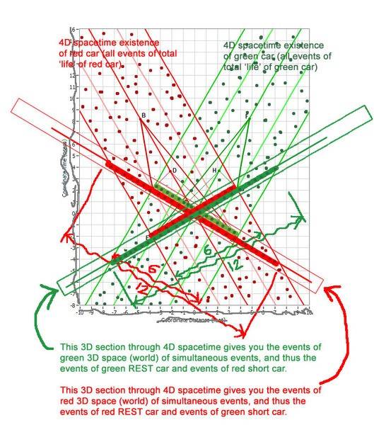

  • #110
ghwellsjr said:
In all of them, they each detect in their brains the signals from their fingertips simultaneously even though they may or may not start out simultaneously and may or may not travel along their arms simultaneously.
My bold.
This seems wrong. Correct me if I do not read you correctly.
Let's consider red observer feeling a shorter green car.
What you say is: Red feels simultaneity, but the signals from the events he feels may not start out simultanously?
This does not make sense.
Red's arms have equal length. Period.
The signals (let's take light speed) travel for him at same speed. Period.
Hence both signals left simultaneously. Period.
I think you made the following error.
The contracted green train is not the green rest train 'but measured differently'.
The contracted green train (simultaneous events for red) is made of completely different events (different content) than the events of that train for a co-moving observer/passenger.
That's the reason for reciprocal length contraction (*). Not because of signals not traveling at same speed, or signals of events that did not start simultaneously but arrived simultaneously.
For Red the green REST car is made of non-simultaneous events. But Red does not measure that car (those events) contracted. He measures simultaneous events, i.e. OTHER events from the green 4D spacetime train. (No wonder for so many people not grasping the essence of realtivity the moving train only 'appears' shorter... )
Your IRF charts are O.K., but -tell me I'm wrong- it appears (sic) that you hesitate to read a full 4D spacetime diagram correctly. Different relative moving train passengers cut through/refer to completely different (content of) events of the 4D train! The simultaneous green car events are 'really' 'physically' out there between the red passenger's hands. Similar reasoning for the green observer/passenger feeling the red car.
What the red observer thinks about light signals from the green rest train is irrelevant. Do me a favor. Draw on the diagram the light paths from the rear and front of the green rest train and see where they end at red's head. That's a complete different story, irrelevant for red's measurement of a shorter green train.
Because the contracted train has in fact nothing to do with the events of the train at rest of the co-moving observer, strictly speaking the train does not really get contracted. Unfortunately when one says or reads that the train at rest in fact does not contracts, then everybody will interpret this erroneously as: the contracted moving train is only an illusion, or only mathematical frame feature, or only 'appears' as such, etc.
Ghwellsjr, I really do appreciate the time and effort you put into drawing your IRF charts, you are one of the few visualizing data, but it might be interesting as well to scrutinize a full 4D spacetime diagram as well. Especially Loedel diagram because of equal time and space lengths on all axes (making it eassier to keep track of proper time and length in both frames of simultaneous events).
(*) ... and time dilation, but I'm afraid that will take another thread to explain...

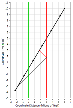

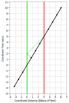

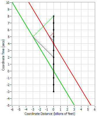

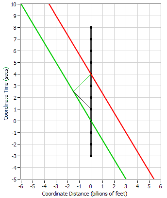

Forgive me to be so blunt but I think you are deliberately not addressing the issue, there is no reason length contraction should involve the muon gun, instead it is the distance between the muons created and the Earth(and these two objects are moving w.r.t each other).
  • #122
The source of the muons (the top of the atmosphere or the muon gun) is not moving wrt the earth. The important distance is the distance betweed the source and the detector. That is the distance (together with the closing speed) which determines how much time passes between the creation and the detection in any frame.
  • #123
universal_101 said:
The reason I introduced "muon gun" is that we can get rid of atmosphere. Now instead of focusing on muons created you are hanging with the gun!
If you would define whatever scenario you want precisely enough so that I and everyone else can understand it (without unending questions about what you meant) then I will draw a diagram and transform it to any other frame you want and then maybe we can see where the problem is. Just remember, you need to specify all times, locations and speeds according to a single Inertial Reference Frame and make it be along one dimension, otherwise, I can't draw a spacetime diagram for it.
OOPs: I guess it's too late. Oh well, keep reading threads on this forum and maybe you'll clear up your misunderstanding that way. For example, this one:
www.physicsforums.com/showthread.php?t=659658
  • #124
TheBC said:
ghwellsjr said:
The point of all these diagrams is that they are all equally valid and all depict exactly the same observations that each passenger and each object makes in the different frames. None of the frames are preferred, not even the rest frame of each passenger. In all of them, they each detect in their brains the signals from their fingertips simultaneously even though they may or may not start out simultaneously and may or may not travel along their arms simultaneously.
My bold.
You only quoted my last sentence of the paragraph. I put in the whole paragraph to keep the last sentence in context.
Simultaneity is frame dependent. Speed is frame dependent (except for the speed of light). Length is frame dependent. Time is frame dependent. Measurements, observations, sensations, and appearances are not frame dependent. An event in different frames has different time and spatial coordinates. We set up the coordinates of events for a scenario in one frame and we use the Lorentz Transformation process to determine the coordinates of each event in any other arbitrary selected frame. As a result, all the measurements, observations, sensations, and appearances will come out the same in all these frames but the coordinates and thus the simultaneities, speeds (except the speed of light), lengths and times will come out different. These comments explain all the rest of your questions and concerns.
I think the problem is that you consider the rest frame of each observer to be preferred and it's not. The rest of my post is just elaboration on this one point.
The event of the arrival of the two sensory feelings are simultaneous because they happen at the same location. It is one event. In any coordinate system, it will continue to be one event. But the two events at the two fingertips of an observer are not at the same location which is why they are two separate events. The time coordinates of those two events determines whether they are simultaneous or not. In the rest frame of the observer, they are simultaneous but in other frames, they have different time coordinates and are not simultaneous. These concepts are well-established definitions in Special Relativity and I didn't think they were debatable.
True in all frames.
True only for light in all frames.
For other signals (the feelings conducted by nerve signals) it is true only in red's rest frame. In other frames, it's not true.
True only in red's rest frame, not true in other frames.
The measurements that each observer makes, that is, the raw data that shows up on his instruments are exactly the same in every frame. He cannot determine simultaneity of remote events by just passively making measurements and observations. He must also be proactive and emit radar signals and wait for their echoes, and if he is going to follow Einstein's convention, he must assume that those signals took the same amount of his measured time to reach the target as it did for the echo to return. Then, from all this data, he can construct a frame and make a spacetime drawing and if he wants he can transform to any other frame and if he follows the edicts of Special Relativity, he will not claim that anyone of these frames is preferred, in the sense that it is more correct or contains more information or is more closely aligned with reality, than any other frame.
Well, if correctly reading a full 4D spacetime diagrams means concluding that simultaneous events are 'really' 'physically' out there, then you are not wrong.
By the way, by "full 4D spacetime diagram" do you mean a Loedel diagram of the type that you drew earlier? If so, that to me is nothing more than a 2D spacetime diagram just like the ones I make with 1D of time and 1D of space. If you are saying that a Loedel diagram shows reality in a way that diagrams for other frames does not, then this is exactly the point of disagreement, as I said earlier.

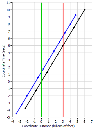

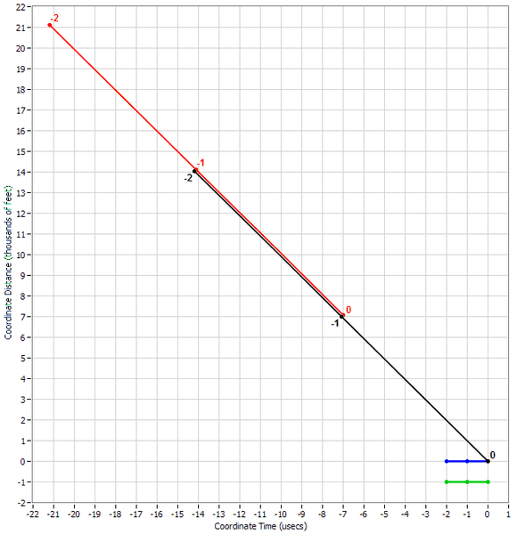

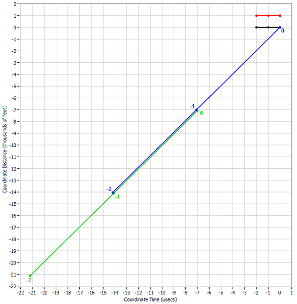

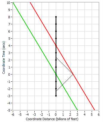

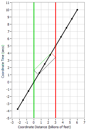

OK, I've added in light paths and labeled the important events for all three of my previous diagrams for both red and green (more than you asked--but I don't know your point):
What if we have just a single train with a Proper Length of 1000 feet, nobody in it or out of it, it's sitting motionless on a track. We establish coordinates for it for the rest frame of the track and the train and draw a spacetime diagram for the train, which will appear as two vertical lines (if we want, it really doesn't matter). Then we transform it to a different frame moving at 60%c with respect to the first frame. Now the length of the train is 800 feet and the two vertical lines are closer together. We continue to transform to a frame moving at 80%c with respect to the original frame. Now the train has a length of 600 feet. Transform to 93.6%c, the train is 352 feet long. Transform to 96%c, the train is 280 feet long.
Do you agree with all of the foregoing? If so, how does a Loedel diagram help understand what's going on?
thanks. So you agree that the red car between green's hands is a different train than any green rest train? O.K.?
What is this third diagram about? I don't know. Is it as seen from the railway track? I am not interested at all in that information, because it's irrellevant for reciprocal length contractiion.
Does that IRF chart combine previous two? In that case I cannot find the reciprocal contraction length 6 as shown on separate first two diagrams.
One loedel diagram (one and the same the same ruler) does give you reciprocal contraction length 6. And with one and the same ruler.
Furthermore in your third chart I can not read the proper length of the red and green car (12 length) .
In a loedel diagram you would measure -with one and the same ruler- the proper red length (12) between A and C; i.e. the line (not drawn in your IRF charts but essential in Loedel -and SR!) between A and C because that line is the collection of events the shorter train is made of. Same remark for proper green length between E and G (12).
(I won't discuss reciprocal time dilation here, because at this stage off topic in our exercise, but on loedel that too is read with that same ruler. Proper times and lengths, reciprocal contraction and reciprocal time dilation, all in one diagram with one ruler only. Your charts can not get this wright.)
Because in your diagram there is no line drawn between A and C, nor between E and G, you do not highlight the events a contracted train car between the hands is made of. And that's precisely the point I want to make.
Only then you will see what happens 4-dimensionally.
I find you first chart even a bit disturbing, alhough it does give you the correct contraction length. In that first diagram (red with a shorter green) the rest length of red AND green are measured horizontally, which in 4D spacetime is problematic because it looks as if there's one preferred frame where in fact bith red and green cars have same length 12 -the horizontal one-.
For all above reasons I do not consider your IRF charts real 4D diagrams... They are more IRT charts. Loedel gives you a far better picture how 4D spacetime works, but obviously/apparently not everybody agrees with this? ;-)

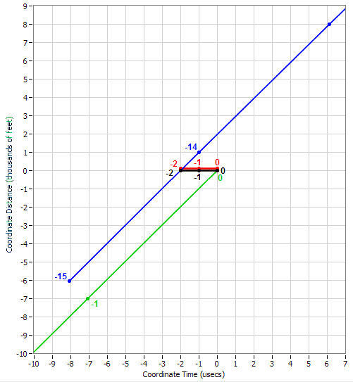

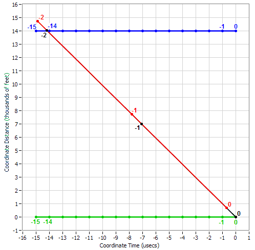

I asked: <<Draw on the diagram the light paths from the rear and front of the green rest train and see where they end at red's head. That's a complete different story, irrelevant for red's measurement of a shorter green train.>> You didn't draw this.

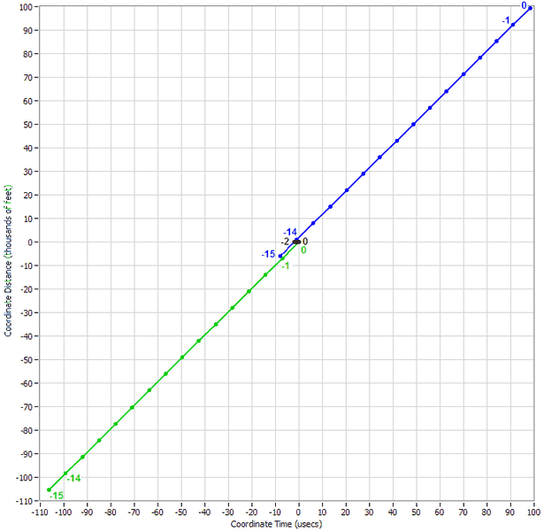

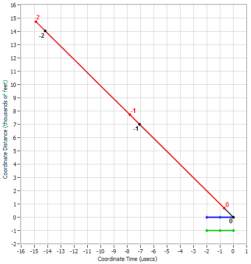

  • #127
yes
see my comments about loedel in previous post.
Of course they are not 4D, neither are Loedel diagrams. Both are 2D and both contain the exact same information.
You are not wrong in your assessment of my position. I do not agree with you that the simultaneous green car events are 'really' 'physically' out there. The simultaneity of the green car events are frame variant. Same with the red car events. Simultaneity is a coordinate effect.
It's the frame that a Loedel diagram is based on. I'm surprised that you don't know.
No, it's simply the first diagram transformed to a speed such that both trains are traveling in the opposite direction at the same speed. Only the first diagram is "as seen from the railway track". The tracks are moving in the second and third diagrams.
Then I don't see why you would think a Loedel diagram is relevant for reciprocal length contraction.
No, we start with the first IRF chart based on your picture of the two trains and the two passengers from post #12. I just applied some specific lengths (12-foot cars and 6-foot arm span). I also applied a speed of 86.6%c since at that speed, gamma =2. Then I transformed it to the second IRF chart using the same speed of 86.6%c to get to the rest frame of the green car. Then I transformed the first chart to a speed of 57.7%c which is the speed at which both trains are traveling at the same speed.
It's important to understand that all three IRF diagrams contain exactly the same information. There is nothing in anyone of them that isn't in the other two. They just have different coordinates for the events.
And why should you? Since both trains are traveling at the same speed, they are contracted to the same length. There's nothing sacrosanct about the length of 6 feet. You only get a contraction to 50% of the Proper Length of 12 feet when the speed is 86.6%c. Since these trains are traveling at 57.7%c, they are contracted to 1/1.22 or just under 10 feet as the diagram shows.
That's because you are adding the coordinates from two other frames to the original frame. Nothing wrong with that, as long as your audience understands how to read the diagram. If the two added sets of coordinates are not drawn on the diagram, then it becomes very difficult to understand how to read it. I just prefer separate clearly marked diagrams.
But you can easily calculate it using the formula for the spacetime interval.
As I see it, the Proper Length between A and C is the distance between red's fingertips (6 feet) in the first diagram. I don't know where you got the 12 from. And E-G is the proper length between green's fingertips, not the green train in the second diagram.
My charts show everything correctly, for any particular frame. I didn't show the Proper Times as dots on these charts because they are irrelevant and would only clutter up the diagrams. But if you want to see a Proper Length, you just transform to the frame in which the object is at rest. If you want to see contracted lengths, you transform to a frame in which the object is moving at any speed you want. You seem to think that in your example, only a length contraction of 50% is valid, and it's not.
There is a coordinate line between A and C in the first diagram and a coordinate line between E and G in the second diagram. Only one car is contracted and the other one is its Proper Length.
How am I supposed to see what happens 4-dimensionally on a 2-dimensional chart?
No, there's no frame in which both trains have the same length of 12 feet. If you want them to have the same length, it will be in the frame in which they are traveling at 57.7%c in opposite directions (my third diagram) and then their lengths are both slightly less than 10 feet.
Like I said before, a Loedel diagram combines just three specific charts, the ones in which both objects are at rest to the one where they are traveling at the same speed. You seem to be giving preference for each object's own rest frame. And I don't see any concepts that lead to 4D that require a Loedel diagram in a way that individual frame diagrams don't.
I thought I did what you wanted. Did you see the line segments A-D-C and E-H-G? Maybe you're looking at it on a small screen.
EDIT: Here are a repeat of the three diagrams to avoid flipping between pages to see them:

  • #137
TheBC said:
yes
Then there is no disagreement between our understandings of Length Contraction. You agree it is purely a coordinate effect. The length of an object is dependent on the frame in which it is described. Or another way of saying the same thing is that if we know the Proper Length of an object in its rest frame, we know its length in any other frame in which it is moving. That allows us to put any number of objects moving at any arbitrary speeds in a frame and we can trivially calculate what their lengths are by dividing their Proper Lengths by the gamma factor at each of their speeds. From this we can set up any scenario according to a single frame and use the Lorentz Transformation process to see what the same scenario looks like according to any other frame moving with respect to the original defining frame. We don't have to limit ourselves to the rest frame of any particular object. That is what I have done in this thread.
TheBC said:
I'm sorry, but none of your comments in the previous post help me understand how you make a Loedel diagram for any of the frames in which the train is moving. Can you please be more specific?
  • #138
Simon Bridge said:
I have a feeling that everyone has started talking past each other.
Perhaps all parties could use a position statement from each POV along with some sort of definition of terms used? Then we can check what someone is trying to say against what we think they have been saying. It also allows for shifts in position as a result of effective arguing gone by.
I stated my position (it's actually not mine, it's just the standard explanation provided by Special Relativity) in my previous post.
I would add that there are many ways for any observer to use radar signals, apply Einstein's simultaneity convention (radar signals take the same amount of time to get to a target as they take to return to the observer which results in the observer making calculations for his own rest frame), and calculate the speeds and the Length Contractions of moving objects and all of these methods get exactly the same results in any frame that is used to define or describe a scenario or any other transformed frame. Length Contraction is never directly observable since it depends on the frame but can be determined by the application of Einstein's convention.
  • #139
You already made a Loedel diagram, your third diagram. A Loedel diagram is simply a spacetime diagram in the frame where they are moving at equal speeds in opposite directions, which is what you drew. The only possible addition is to label the two moving frame's axes. Personally, I think that would just add clutter, but I think that is what he considers to be missing.
  • #140
I'm asking how to do it for a single train.
