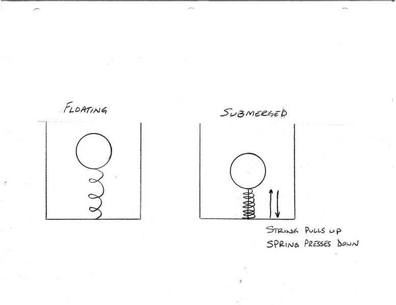

Trying to get clear on what's happening with the ping pong ball. If the string is holding it down, then the string is pulling up on the beaker. But, is it like compressing a spring, and the bottom end of the spring bears against the bottom of the beaker? So the beaker sees the string pulling up, but the spring is pushing down, so there's no net force on the beaker? I don't quite see that as being right.
Is this like the truckload of birds thing, where the driver thinks if he gets them to fly around inside, he can make it over the bridge.
Sorry for the crummy drawing.

  • #67
You can imagine the string being replaced by a massless spring.
First start out with just the beaker of water. That water presses down on the bottom of the beaker with some force equal to pressure x area.
Now submerge the ping pong ball under the water, attaching it to the bottom via that spring. The water level rises, increasing the water pressure on the bottom of the beaker. The buoyant force pushes up on the ping pong ball, stretching the spring, which pulls up on the bottom of the beaker. The upward pull of the spring (or string) exactly balances the additional downward force due the increased depth of water.
  • #68

  • #69
I'd go further. I'd replace the string with a post. And then the post with a tube. And then a tube that is open at both ends. Then replace the whole system with glass, so you have a funny shaped beaker. And then with an ordinary beaker with the same volume of water.
At each step you have the same weight.

Buckleymanor said:
That seems simple, what is hard to understand is what was mentioned earlier in the thread.
If you took a ping pong ball the same size as the steel ball (which is the same size of the left ping pong ball) and with a stiff rod instead of a thread which was of the same weight and dimension of the thread and pushed the ball with the rod into the water on the right side of the balance scale. The balance scale will tip to the right even though the amount of water displaced is the same in each of the beakers and the ping pong balls weigh the same and so do the thread and rod.
Presumably if the rod and ball was attached to the beaker after being pushed the balance would reach equalibrium as the person pushing is adding the uneven weight to one side.
Attaching the rod to the beaker makes both sides equal.
When the ping pong ball is held in a submerged position with a stiff rod, the applied force is from an external source not within the balance scale system (it is pushed down with a force equivalent to the weight of the displaced water). When the ping pong ball is held in a submerged position by a string attached to the bottom, the applied forces are all within the balance scale system (Newton's third law: they cancel out leaving only the weight of the ping pong ball itself).
Image the same thought experiment in my previous post, except this time the spring scale is reversed (to read weight in the opposite direction) and the steel ball is replaced with another ping pong ball. Remember, the spring scale, ping pong ball, and the stand are all external to the balance scale system. As the ping pong ball is pushed into the water it starts to displace water and the spring scale reading increases. The reading on the spring scale will indicate the weight of the volume of water that is being displaced. When the weight of the volume of water being displace is greater than the weight of the ping pong ball on the left of the balance scale, the balance scale will tip to the right.
In short, the difference is in the fact that the ball and stand on the right are not a part of the balance scale system. If I were to place the stand and ball on the right onto the right platten of the balance scale and balance it out, then moving the ball in and out of the water would have no effect.
