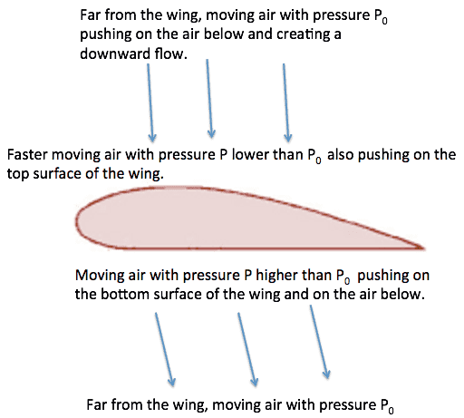

Thanks a lot! This is how I envision it:
It is clear, from Bernoulli's equation, that fast moving air has a lower isotropic pressure than slower moving air. That said, I am not clear why from a molecular standpoint? Does anyone have a clear interpretation?

Thanks. I read that. I will read again.

Good. You should be aware that any simple answer to your question is over-simplified and will have to be discarded if you get deeper into the subject. The only real way to calculate lift is to apply Computational Fluid Dynamics (CFD), which traces tiny bits of air around the wing while calculating all the pressures and forces on it. Even that is very limited. Wind tunnel tests are done to verify and modify the CFD results to get an aerodynamic model. The flight tests are done in a careful sequence to make sure that flight results and aerodynamic model agree before more dangerous flights are attempted.
You are right. I don't want to look to much into it. I am just trying to grasp some qualitative understanding of the situation.
