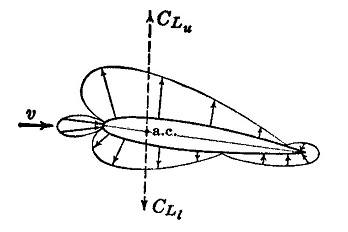

The pressure above the surface is lower than the free stream atmospheric pressure. The pressure below the wing is higher than the free stream atmospheric pressure. A pressure gradient is directed from high pressure to low pressure which I assume that is where the net force point. would point.
We know lift is due to the pressure difference between the top and bottom surface. But, given the relative difference between free stream pressure and the pressures at the wing produce a net force point down on both the top and bottom surfaces?
  • #80
Again, it is literally impossible for a fluid to "pull" on a surface. The force is always directed normal to and into the surface. Always.
  • #81
Ok, I finally get it. What matters is the local pressure distribution on the top and bottom surfaces of the wing to produce the net lift force.
A gradient is a vector pointing from small to large values. I guess I got confused about these negative of the pressure gradients, , one directed towards from the top surface and one directed away from the bottom surface.

  • #83
Diagram of lift coefficient distribution from Airplane Performance Stability and Control -- Perkins and Hage.
One needs to be careful about the difference between pressure and pressure gradient. The pressure force is always normal to the surface and directed from the gas toward the surface. The pressure gradient is derived from the difference in pressure. It is positive in the direction of increasing pressure. It is not the same as the force from the pressure and positive is in the opposite direction from the force.
The force on both surfaces is from the gas side toward and normal to the surface. If there is lift, the total force on the bottom is greater than the total force on the top.
