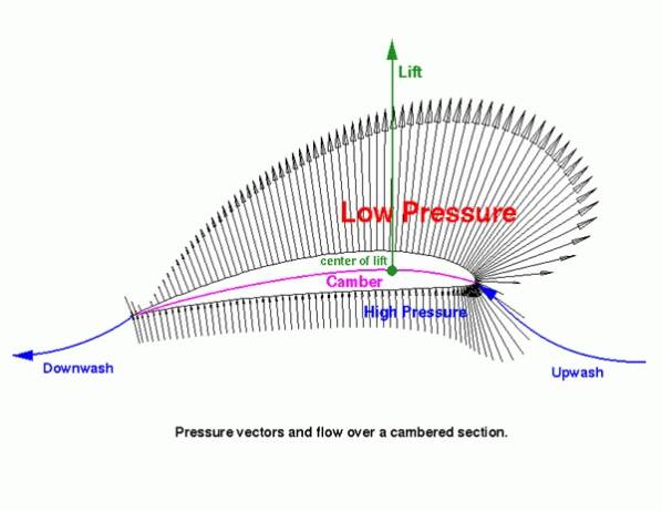

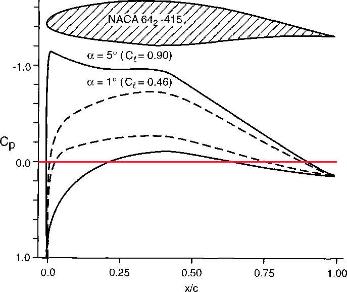

Calculations are hard. Measurements are easy and the results easy to visualize:
This is a graphical representation of the static, gauge pressure distribution around a wing in flight. The short arrows on the bottom show pressures above atmospheric pressure and the longer arrows on top show pressures below atmospheric. In this case - as is common in level flight - the pressure reduction above is greater than the pressure increase below.
Engineers quantifies this in wind tunnel testing or CFD analysis by putting pressure ports all around the wing to measure those pressures. For actual measurement and calculation, you plot the results on a graph:
Note that the graph is inverted to match what is going on with the wing: "Negative" pressures are up and positive pressures are down. Again, by adding together (integrating) the pressure differential, you get the total lift.
