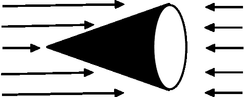

There is a Conical structure such that its base is completely reflecting and the tip of the cone which has a very small area and completely absorbent surface, if the light of same intensity is incident on the tip and on the base simultaneously then find the ratio of the force exerted by light at the base to the force exerted by it on the tip
F = (2I*A/c) for completely reflecting surfaces and F = I*A/C for absorbent surfaces , where I is the intensity and c is the speed of light and A is the area on which the light is being incident.
Question on radiation pressure
Mohammad Ishmas said:
Homework Statement: There is a Conical structure such that its base is completely reflecting and the tip of the cone which has a very small area and completely absorbent surface, if the light of same intensity is incident on the tip and on the base simultaneously then find the ratio of the force exerted by light at the base to the force exerted by it on the tip
Relevant Equations: F = (2I*A/c) for completely reflecting surfaces and F = I*A/C for absorbent surfaces , where I is the intensity and c is the speed of light and A is the area on which the light is being incident.

Are trying to solve a different problem requiring integration? Maybe this:
Steve4Physics said:
If the total area is infinitesimally small, then there is no integration to perform; the total force is infinitesimally small, i.e zero. A non-zero force can only arise for a finite area.
Yeah you are right the diagram would be like this , and it would require integration but how can I find the area of the base in terms of the area of the tip (basically the question has a pre made assumption that the tip has a area that is very small)

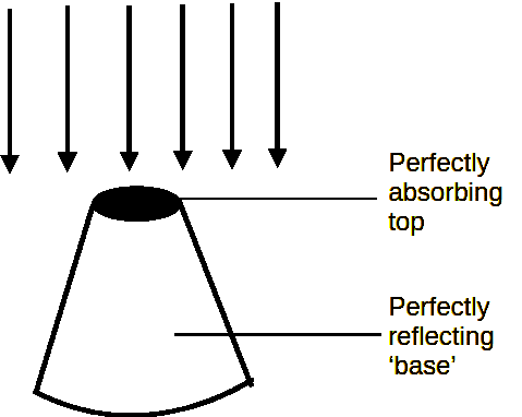

The 'area of the tip' is zero. Do you mean the 'area of the curved side' (shown in black in the Post #8 diagram)?
I am sorry, the question actually says a that there is a Frustrum of a cone with the area of the top part (that I called tip earlier) being very small . I had assumed that area to be 'dA' , However how can I find area of the base in terms of dA ??
A diagram would have saved a lot of confusion! The area of the small face is small but finite - so you shouldn't represent it using 'dA'. That's misleading.

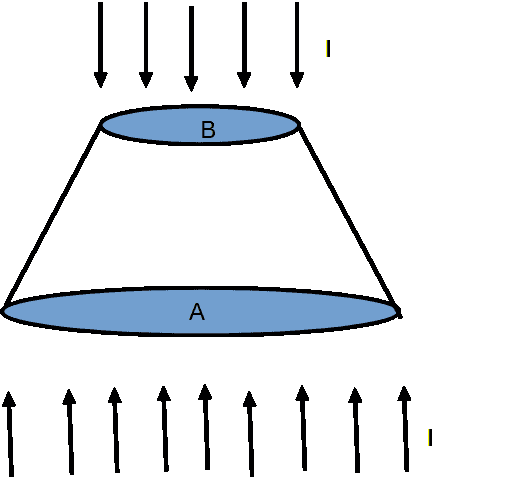

One approach when given a very badly formulated question (which, IMO, this is) is to present your own best-guess interpretation of the question and then answer that. Here’s my best-guess interpretation of the question:
A right conical frustum has two circular flat faces, A and B.
Face A is the larger, with radius ##R_A## and is a perfect reflector.
Face B, with radius ##R_B## is a perfect absorber.
As shown in the diagram, light of the same intensity, ##I##, is normally incident on faces A and B.
Find the ratio of the magnitude of the force exerted by light on face A to the magnitude of the force exerted by light on face B.
Can you answer that?

Yes this is the question, I am sorry for not giving the diagram as it was not there in the original question

The original question is as follows -
A uniform beam of light falls on a frustum of a cone. The smaller top surface of the frustum is completely absorbent, while the larger base is perfectly reflective. The original cone, before being cut, had a total height H and a base radius R. The frustum was formed by removing the upper part of the cone, which had a height h from the tip to the top of the frustum. Find the ratio of the force exerted by the light on the base to the force exerted on the top surface.
I am also sorry for not posting it earlier but I couldn't as this was in a regional language
From this information one can calculate the radius of the frustrum, ##r##.
Can you see how? Can you show us the formula you come up with?
Yeah I can see that , we can use similar triangles to find that r = R(h/H)

It now sounds like there is only one beam of light. That makes previous descriptions wrong. Possibly the intended setup is this:
This would make much more sense.

I found a solution using this value of 'r', I just plugged this value of "r" in πr^2 , then you would get a ratio of the two areas in terms of height, basically if the area of the base in A and area of top surface is B , then ratio A/B = (H/h)^2 , then we can just use the formulas to find the ratio of the forces
Did you take into account the difference in reflectivity?
Yeah I did , I used the different formulas for completely reflective and completely absorbent surfaces (for reflective surfaces the force just becomes twice). the final answer comes out to be , Fa/Fb = 2(H/h)^2
Ok. However, if the diagram in post #25 is accurate, the larger surface is partly shaded or displaced by the smaller one. But since the ratio is given as large, presumably we can ignore that.
