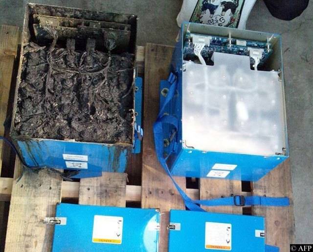

http://www.thestate.com/2013/02/05/2619386/japan-787-probe-finds-thermal.html#.URGs-uDlAW0
The Japan Transportation Safety Board said that CAT scans and other analysis found damage to all eight cells in the battery that overheated on the All Nippon Airways 787 on Jan. 16, which prompted an emergency landing and probes by both U.S. and Japanese aviation safety regulators.
They also found signs of short-circuiting and "thermal runaway," a chemical reaction in which rising temperature causes progressively hotter temperatures. U.S. investigators found similar evidence in the battery that caught fire last month on a Japan Airlines 787 parked in Boston.
http://mainichi.jp/english/english/newsselect/news/20130206p2g00m0dm001000c.html
All eight cells of the battery installed in the ANA plane showed heat-caused damage, Norihiro Goto, chairman of the Japan Transport Safety Board, said at a press conference.
"Cells 3 and 6 were severely damaged and Cells 1, 2, 7 and 8 were swollen or deformed," Goto said.
He also said that the positive electrode of Cell 3 was found to have experienced particularly severe damage, and wiring inside some cells melted.

The person I consider to have the best investigative performance to date on this issue is Celina Mikolajczak.
Lithium-Ion Batteries Hazard and Use Assessment
Final Report Prepared by:
Celina Mikolajczak, PE
Michael Kahn, PhD
Kevin White, PhD
Richard Thomas Long, PE
Exponent Failure Analysis Associates, Inc.
© July 2011 Fire Protection Research Foundation
http://www.nfpa.org/assets/files/PDF/Research/RFLithiumIonBatteriesHazard.pdf
I will be glad to provide my opinions on what is contained in this rather damning document, but I am most interested in yours. It is clear to me that this technology is not mature enough in manufacture to be allowed in commercial aircraft. The absolute inability to identify point shorts and dendrite growth, or to prevent Li plating on the anode, the concerns with aging increasing liklihood of shorting, the acceptance of flammable electrolyte, the outgassing of flammable gas and the impossibility of extinguishing electrolyte fires with halon, the cascading effects of thermal runaway events and the inadequate "solution" of boxing this ticking timebomb of a battery in a titanium box vented to the slipstream screams not just of engineering incompetence but of another political mandate gone sour. I do not know if that last bit is true, but I do see Steven Chu scrambling for the exit as Airbus reconsiders Li-Ion deployment.
A kludge (or kluge) is a workaround, a quick-and-dirty solution, a clumsy, inelegant, difficult to extend, hard to maintain yet effective and quick solution to a problem, and a rough synonym to the terms "jury rig", "Jugaad" or "jerry rig". -- Wikipedia
Photos of Japan Airlines January 7 incident, battery pack and cell damage
-- Slide #13: NOTE THE SHORTING DAMAGE THROUGH THE TITANIUM CONTAINMENT! The failure of NTSB's mandated kludge may have been the strongest reason to ground the B-787 fleet. (The melting point of titanium is 3000 F.)
NTSB PDF February 7, 2013
http://www.ntsb.gov/investigations/2013/boeing_787/JAL_B-787_2-7-13.pdf
