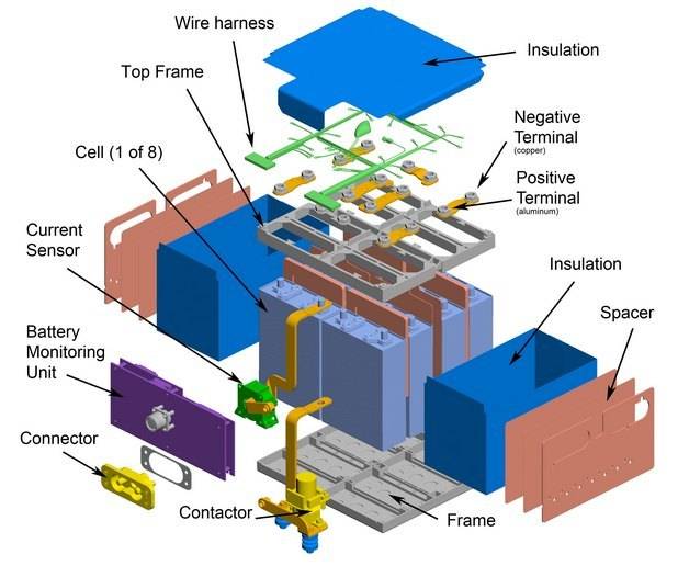

Elon Musk (co-founder of Tesla Motors and SpaceX) had this to say about the Dreamliner battery.
“The 787 batteries have very large cells, the battery cells are very big and they’re quite close together and there’s not enough insulation between the cells. So if one cell goes into thermal runaway and catches on fire, it’s going to cascade into the other cells.
The approach we take at Tesla and SpaceX is we have smaller battery cells with gaps between them, and we make sure that if there’s a thermal runaway event which creates quite a bit of fire and smoke that it directs that fire away from other cells, so you don’t have this domino effect….
The long term solution for having a battery pack that’s reliable and safe and lasts a long time is to reduce the size of the cells, and have more cells that are smaller and have bigger gaps and better thermal insulation between the cells.”
http://blogs.wsj.com/corporate-intelligence/2013/02/26/elon-musks-solution-to-boeings-battery-problem/

Does anyone know what method is used to cool the 787 battery pack?
Chevy Volt apparently has liquid coolant system for the battery that can tap into the car's passenger compatrment refrigeration system... they limit their battery to 104F.
I've not seen mention of a coolant system, and on what few pictures I've seen i expected to see connecting pipes for forced air or liquid but didn't..http://www.designnews.com/document.asp?doc_id=257987&cid=NL_Newsletters+-+DN+Daily&dfpPParams=ind_184,industry_aero,aid_257987&dfpLayout=article
also there's a low temperature threshold below which they shouldn't be charged.
Just curious,... 787 battery temperature control is a subject i haven't stumbled across.

  • #103
Okay, you guys, here's a claim that lithium burns with aluminum. Can someone enlighten me to the chemistry? I have a rerun of Alien playing in my mind where the crew cuts off the leg of a "face-hugger" and the blood that squirts out starts burning holes between decks on its way to the hull.
________________
Battery Burns
by dean adams
Thursday, April 18, 2013
http://www.superbikeplanet.com/2013/Apr/130418mnsa11.htm
The fire in the Tech 3 Yamaha garage last night was caused by a lithium battery in a remote engine starting unit, either left on the charger or in an "on" position over night.
See http://www.motomatters.com/news/2013/04/18/fire_in_yamaha_garage_gets_austin_motogp.html
If you've flown commercial recently--I just got off a Delta flight--then no doubt you have heard the new warning messages that some airlines are making pre-flight, that passengers are not to bring lithium batteries on the plane, have them in chargers or in a device that is turned on (the message varies between airlines).
Lithium batteries are super-light, charge quickly and are very powerful for their size. But they also can be a huge and dangerous fire hazard. Boeing's new 787 "Dreamliner" plane was grounded over fears that its lithium-ion batteries were a major fire hazard.
In motorcycle racing it's well known that BMW lost an entire WSBK factory bike last season when a lithium-ion battery burst into flames. When it all goes pear-shaped, lithium-ion batteries burn very hot and love to use aluminum frames for fuel. At least twice now a race bike fire caused by a lithium-ion battery went from 'Hey, is that thing smoking?' to GET IT OUTSIDE! NOW! PUSH IT OUTSIDE!' in a very short time. The batteries cause a fire so hot that water is only a short-term answer for extinguishing the flames.
The battery in Tech 3's starter was probably larger than what is normally used in a motorcycle application. While three garages were left under water, Tech 3 is very lucky that the situation was not much worse.
